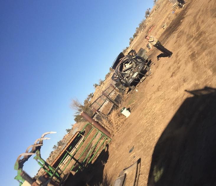

Trying to avoid this, that juat happened to my friend on sunday. Don't know how he survived this.
