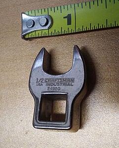

I used one of these to get at those deep down nuts.

exactly. you also attach a 6" extension to the claw and then a ratchet to loosen each ferrule. That is also what I used.
