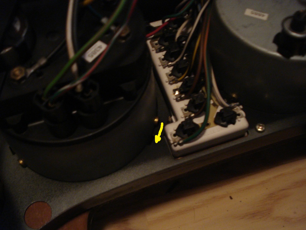

I hope this will help you.

And I hope that this will help you :-)

thanks Doug,
first you push the speedo or tachometer towards the front of the car, (you can feel a "springy feeling" if you push and release the gauge),
then you turn the gauge counterclockwise, as if to loosen a screw?, not a lot of turning is needed, practice makes perfect, just don't push on the glass, only on the metal frame edge of the gauge. once you have it turned about 30 degrees, you let go and the gauge sort of pops out by itself.
this only works for the speedo and tachometer, the other small gauges are held by "C" brackets and nuts from the rear.
Before you disconnect any wire from any of the gauges, make sure you make a drawing and notate where every wire goes.
