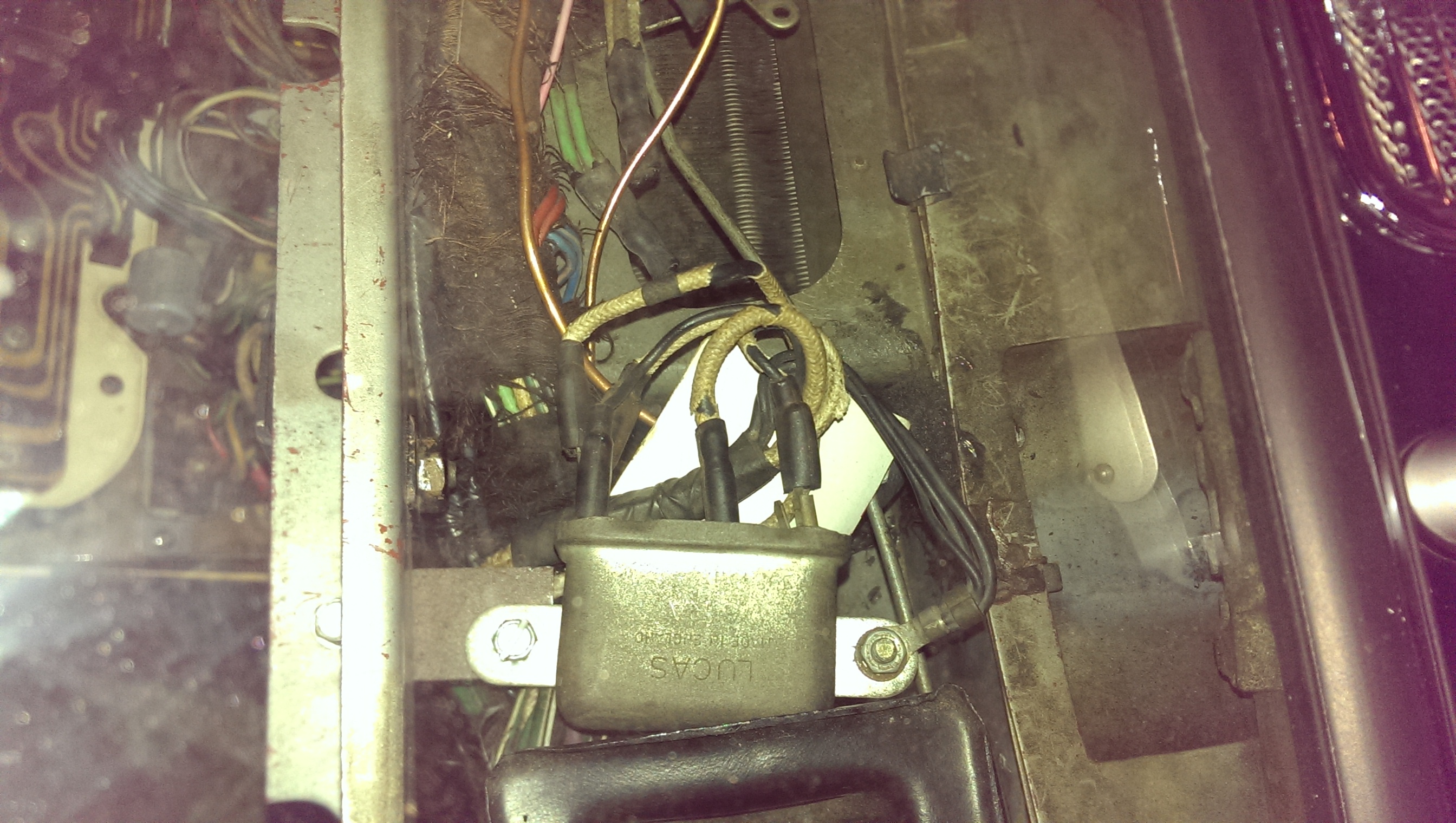

It is under the dash pad...near glove box in LHD. Other relay on LH side is for fans?
Jag never showed the location of the relays nor the "bullet" connectors.. bad documentation.
Attached Thumbnails ignition relay 1972 xj6-bracket-over-valve-removed-relay-turned-new-mounting-hole.jpg
