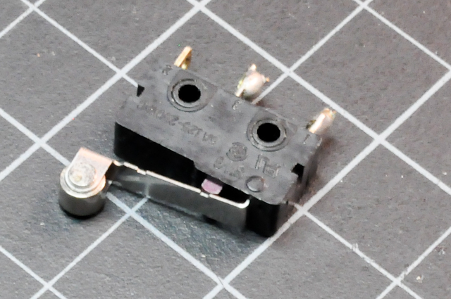

in my '84 the neutral safety switch also controls the Speed Control (Cruise), and the Reverse lights, it's a roller switch in front and to the right of the shifter. The ski /ashtray panel must come off.

the famous Neutral Safety switch: chances are the Neutral/Reverse/Cruise switch is out of adjustment, evidenced by the tests you made; (assuming yours is not mounted to the transmission itself like Doug says, mine is by the shifter),
if the switch was bad, you can find roller switch equivalents at Radio Shack and other electronic suppliers, it's not a special "Jaguar" part, it's a generic 2 or 3 way switch. (depends on what you have). I've pulled several from salvage yards and some are Double Pole, Double Throw, (DPDT), some are Single Pole Double Throw, (SPDT), you might have to solder/splice the wire plug, but no big deal.
