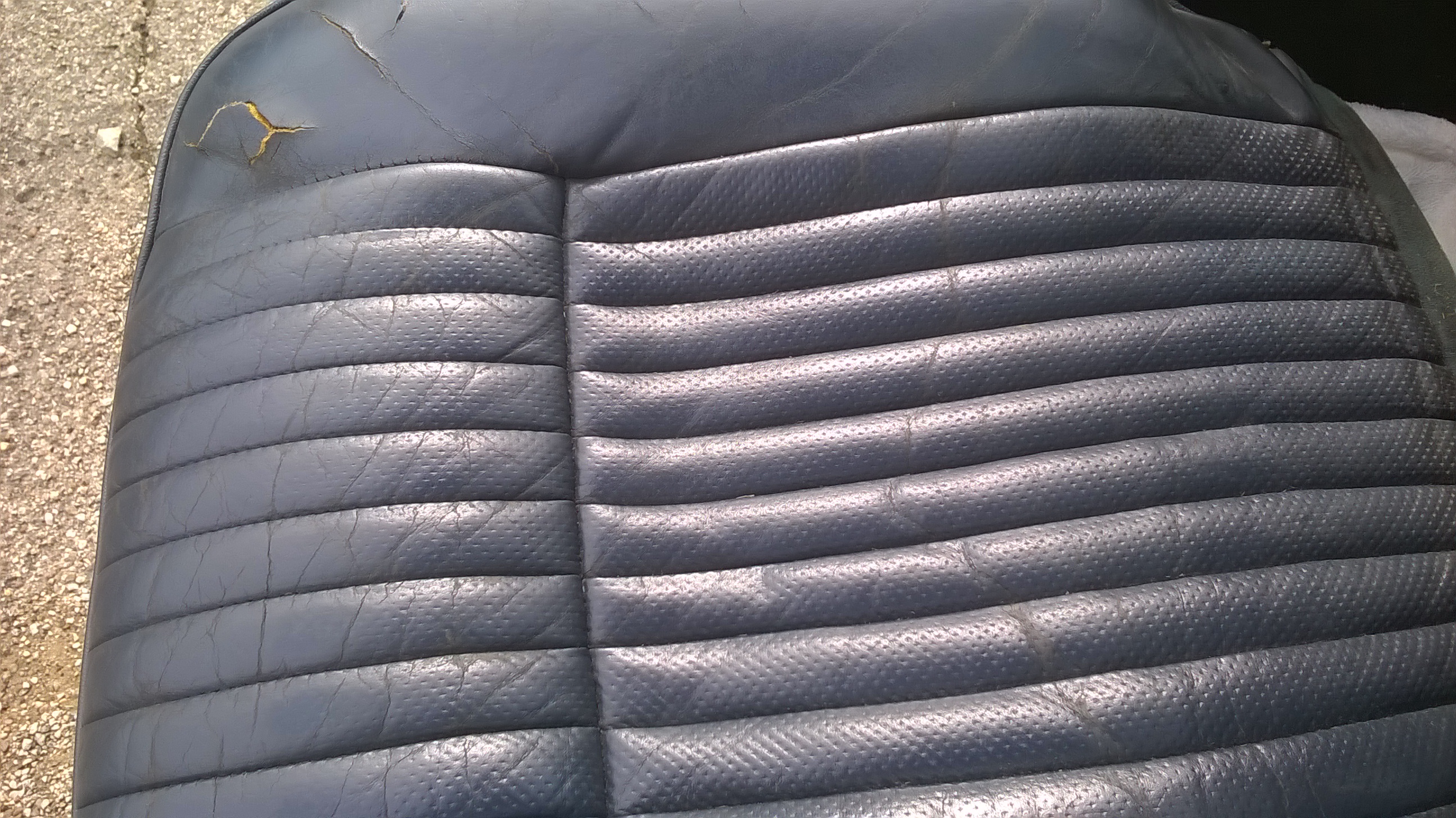

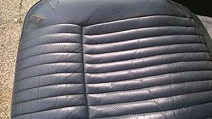

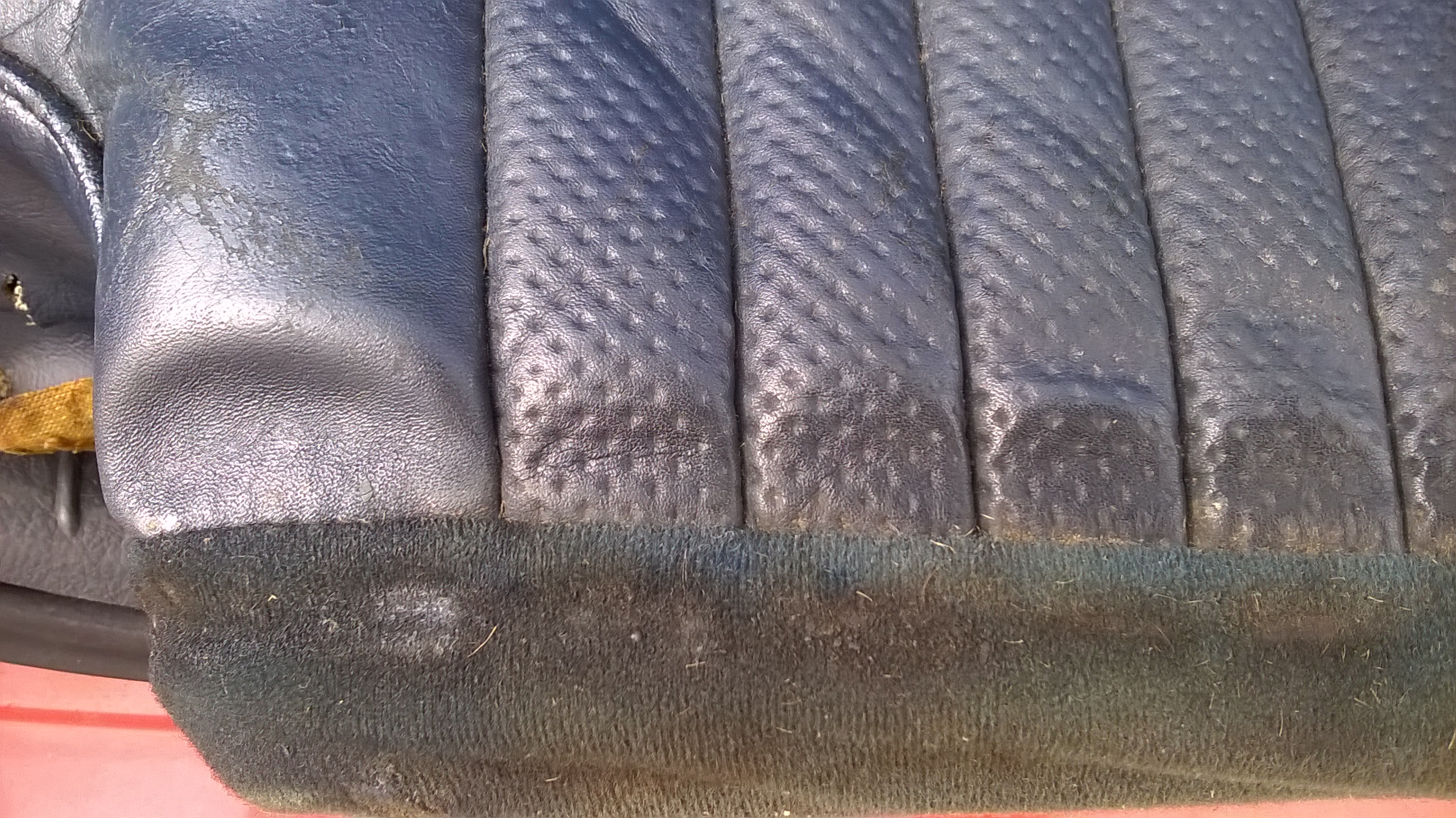

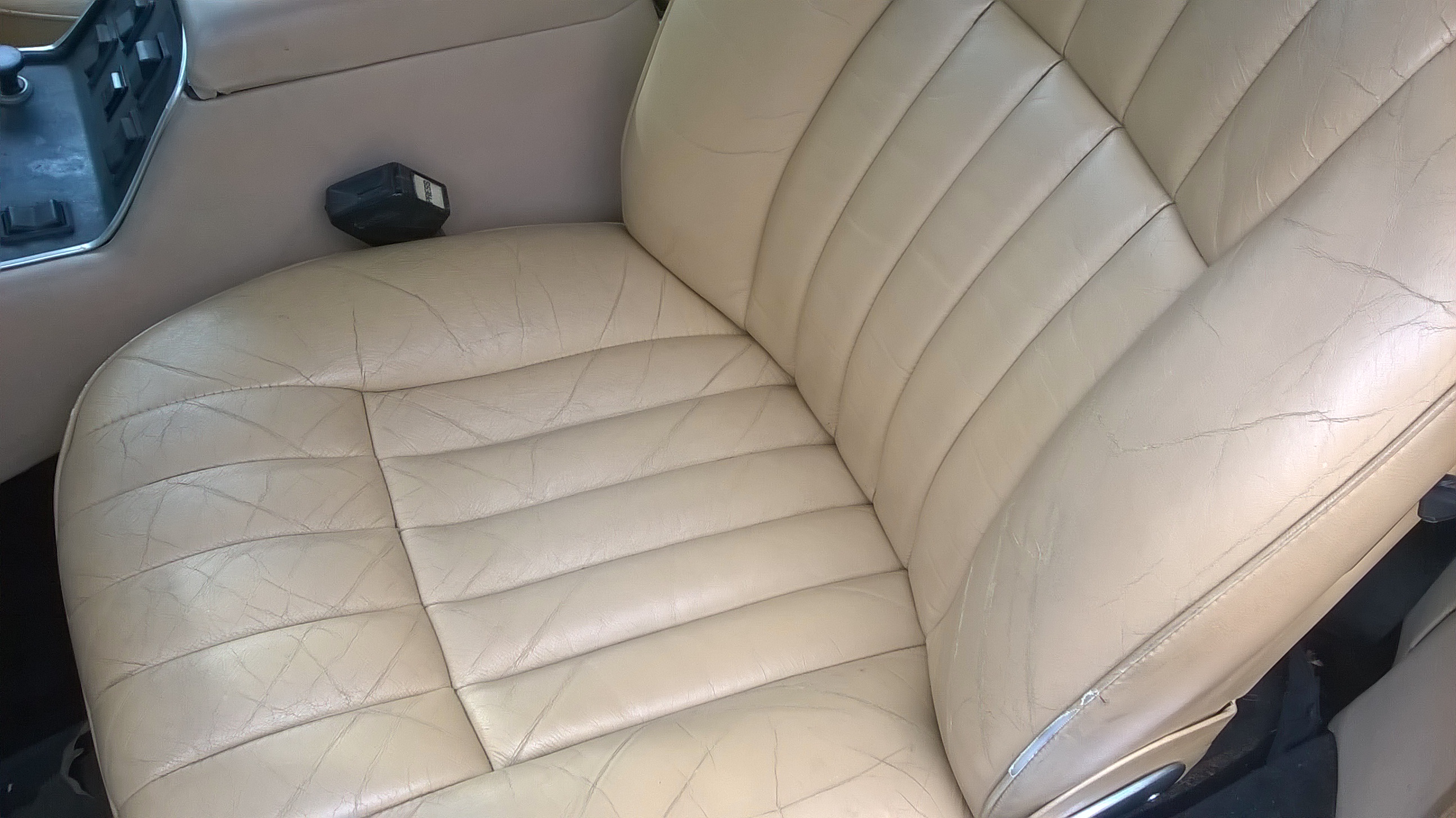

In addition to the question of "type" of leather, I want to know the original application of the two different styles of "pleats". I have two '77 XJ6Cs that need new leather, but one has the wide smooth pleats and the other has the narrow embossed pleats. I doubt either one of mine is original at this point, but I want to go back to with correct style if I can determine what that is.
The seat cover suppliers specifically ask which type of seat you have if you are shopping for replacements. I suspect you could chose at the dealership which seat colour and leather type (perf or not) and pleat width. Based on that I would assume it becomes which of those combinations you prefer...I like thin pleats, perforated...
The wide-pleat seats were used in the V12 versions of the Series II and the narrow-pleat perforated leather in the 6 cylinder versions (this was also the leather used in the Series III XJ6). The leather was not Vaumol - that was for the earlier 60's cars such as the Mk 2. Jaguar never specified the particular name of the leather in the Series II cars (except that it was by Connolly).
