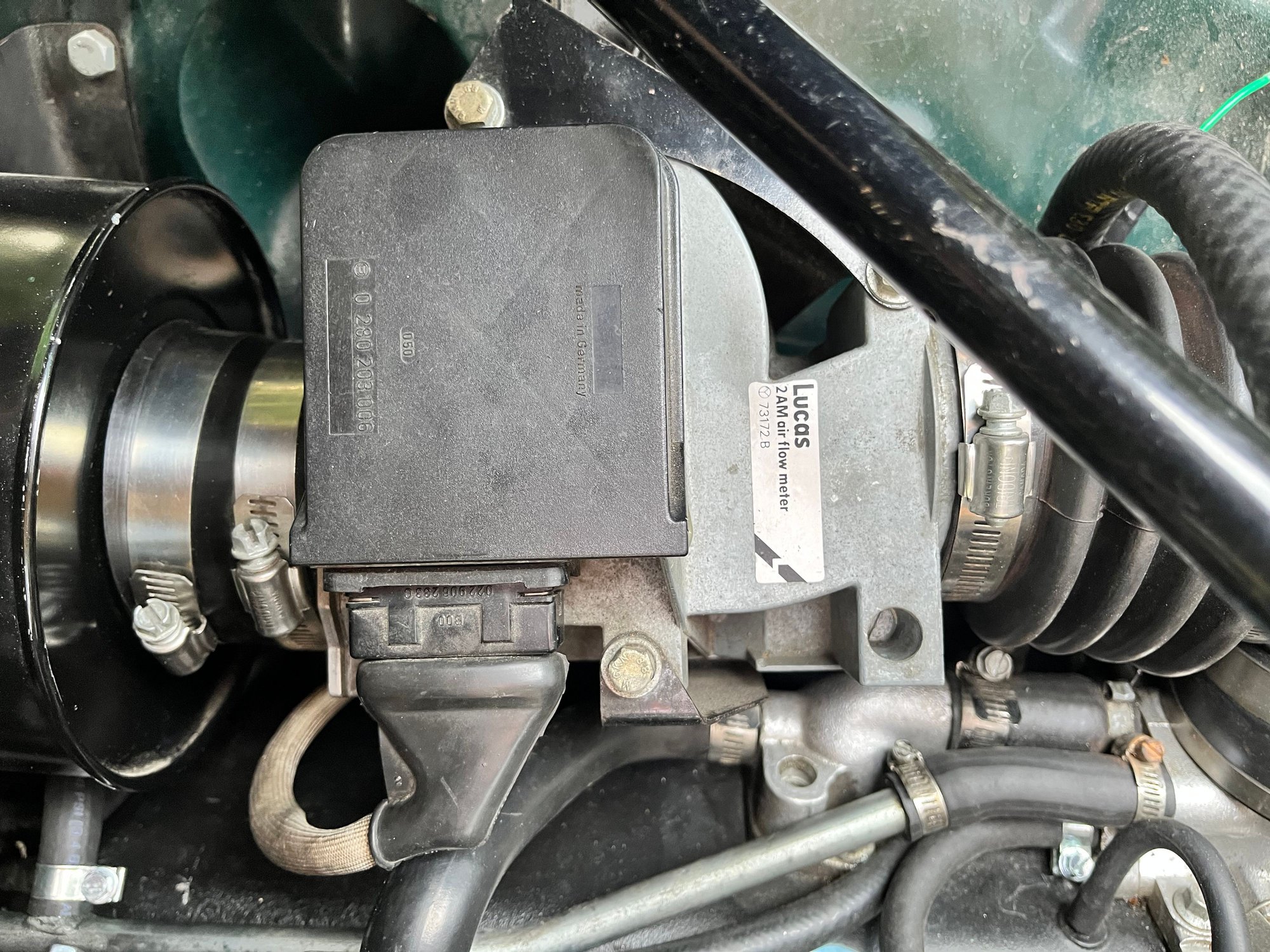

Hi,
is it possible to adjust the “mixture” screw on the air flow meter without any exhaust meter reading tools?
Old Sep 13, 2024 | 01:41 PM
Doug's Avatar
Posts: 25,544
Likes: 11,744
From: Pacific Northwest USA
Sure. You can make gradual adjustments. As you do you should hear/feel the engine respond. You’re looking for the point where the idle is smoothest. Note that this might put you outside of emissions. If that’s a consideration then you would an exhaust meter, yes.
