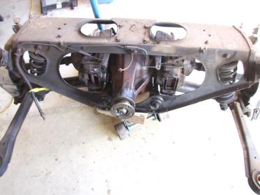

The first job was to repair the annoying squeak in the rear end. Turned out to be the one of the handbrake pads had worn through. Oh well out with the rear end to repair.
Attached Thumbnails My 1970 Daimler Sovereign-img_3890-1.jpg   My 1970 Daimler Sovereign-9a22d896.jpg

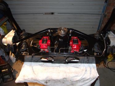

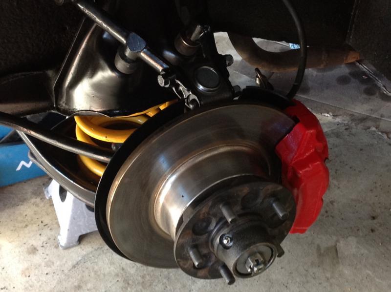

Turns out it wasnt just the handbrake pads but the calipers wore almost completely seized. So calipers out, new kits in and painted.
Didn't seem right to put freshly painted bits in with old grubby bits so I stripped everything down, replaced a heap of parts, (disks, bushes, brake lines etc etc) painted and reassembled. since this photo I have also replaced the springs and new shocks are on the way.
Very happy with the way it turned out, although in hindsight I would have had some parts powder coated instead of painted.

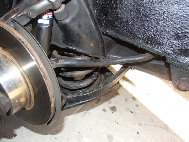

Not long after putting it back together I managed to score a nice set of wheels at a pretty good price. I love the look of these.
but I then noticed the car had a bit of a lean to it and didn't sit quite right, and the front drivers side tyre was scrubbing quite badly. So the front end was stripped down, all bushes, springs, bolts, bearings and disks replaced and calipers refurbished. The driver side spring had a real kink in it causing the odd angles.
And fixed.

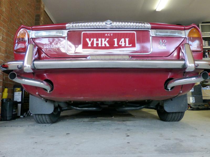

And I have just completed the exhaust system. Consists of a new set of headers into a sigle collector then back in to a twin system with mufflers. The exhaust place has done a magnificent job and the sound of the motor now is really nice.
Rather than routing the exhaust back through the diff cage and near the brakes, I was talked into having the pipes run under the diff, there is minimal heat transfer, have never hit anything and are very easy to remove if I ever need to take the rear assembly out again. I have seen quite a few exhausts done this way now and none have had any problems.
