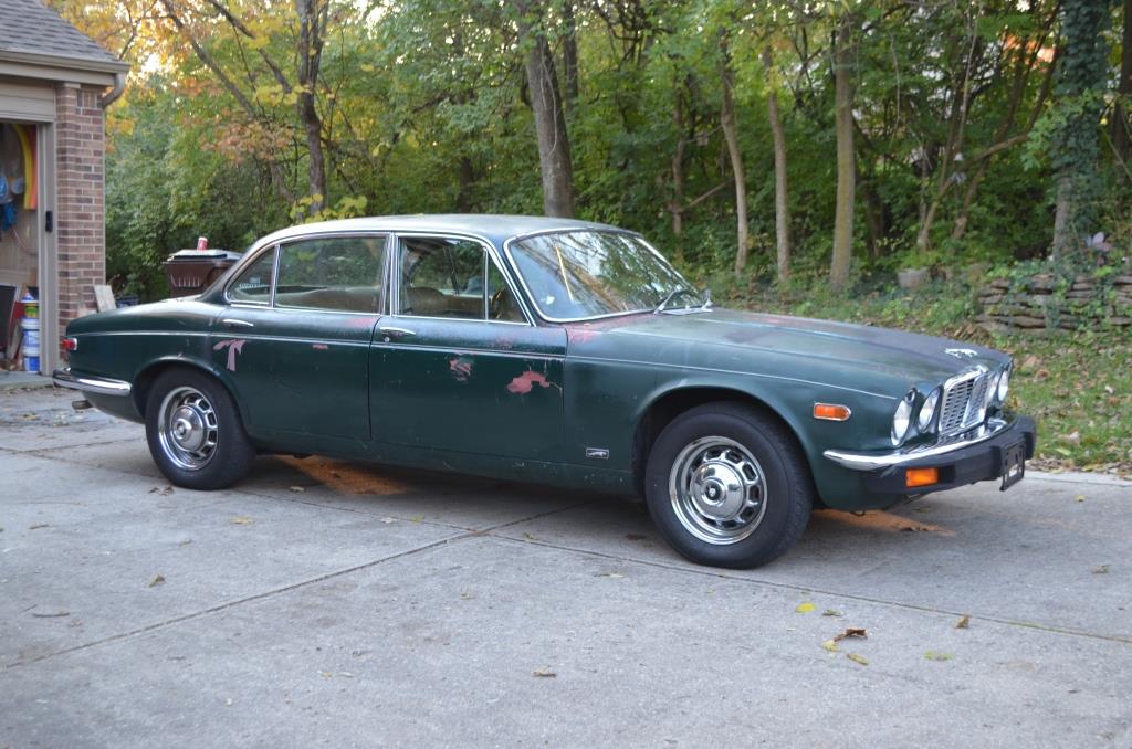

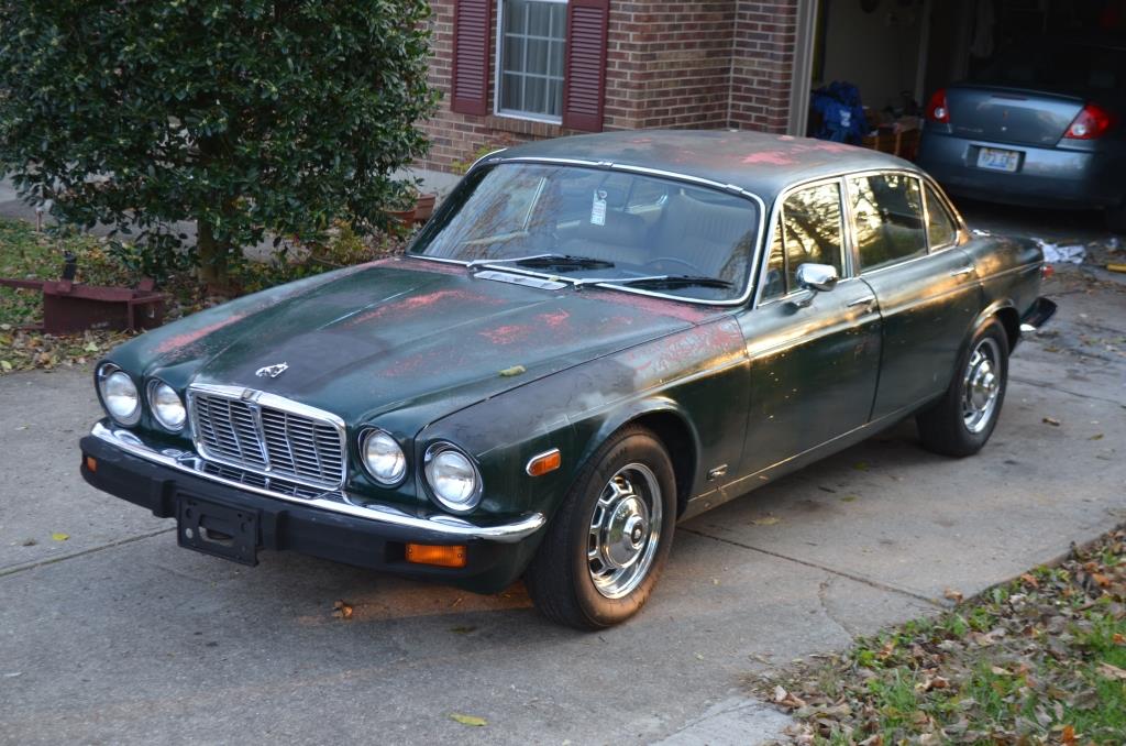

First: the car had been sitting outside, under a tarp with no windows (they had been shot out), since 2002, so the interior was mostly ruined from the humidity and temperature changes. Now that I"m driving it, I've been doing mostly interior work.

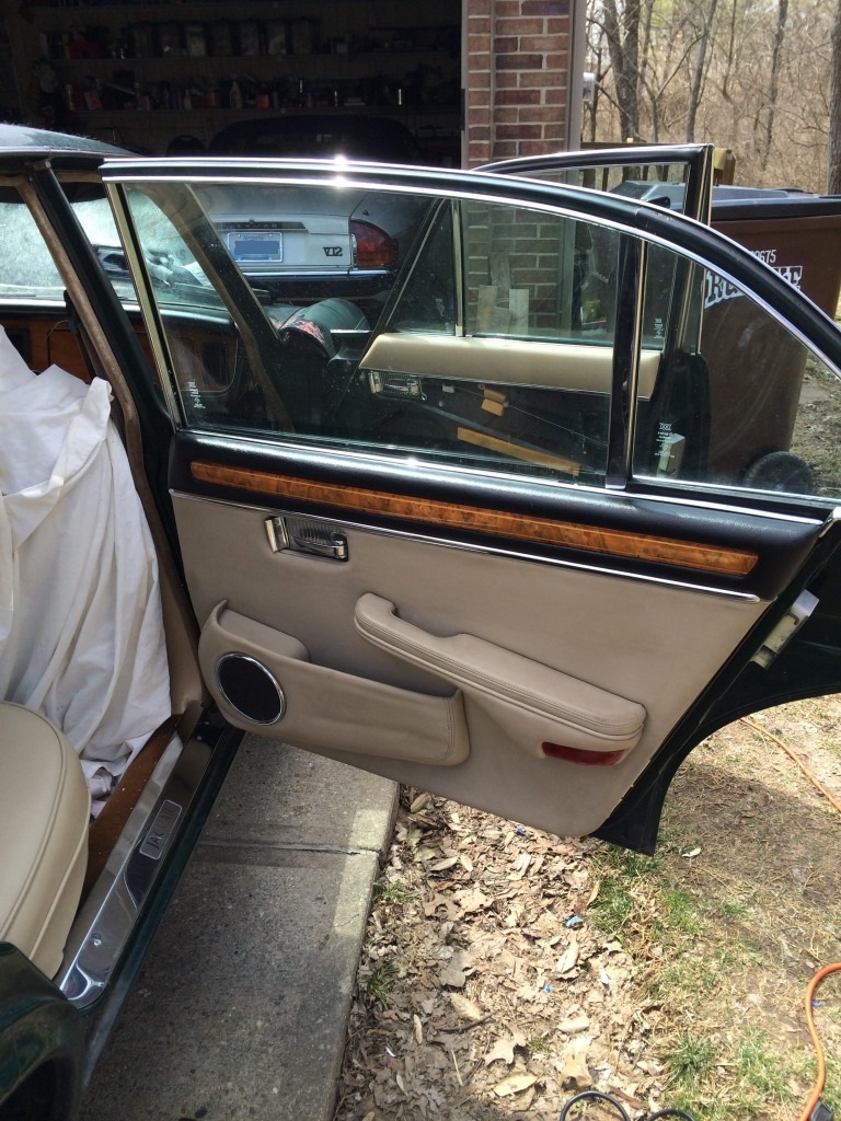

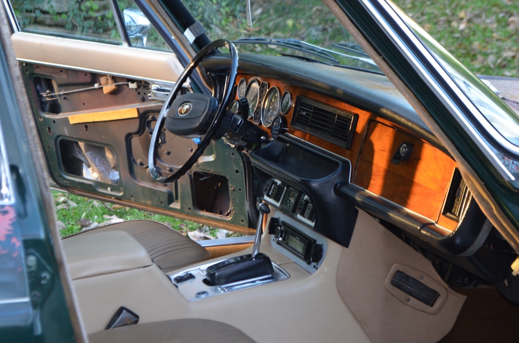

After stripping off all of the old vinyl, I created new pieces from Naugahyde, and re wrapped all of the pieces. I matched the color as close as I could to the original Biscuit color, and went to work. I redid the headliner and all of the trim components, made new door panels and wrapped them with a base of headliner material with the Naugahyde over them, and did all of the various other components the same way. I still don't have the doors done, because I'm still working on running wires for my stereo system.

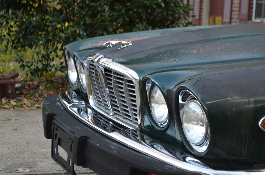

I decided that the car was missing something... Something iconic to a Jaguar. I custom fit the leaper on to my hood. I have the small leaper (5"), and even though it doesn't belong on a Series II, I get a lot of comments from people saying they like it.

So we found a SIII at a junkyard not too long ago, with a flawless interior, and we basically bought the car and took out the interior. We've transplanted all that we can from the junkyard one to mine. It's a world of difference in the interior! We are also finishing up the stereo system upgrade shortly. Here's a sneak peek of the interior... I'll post more photos later this week!
