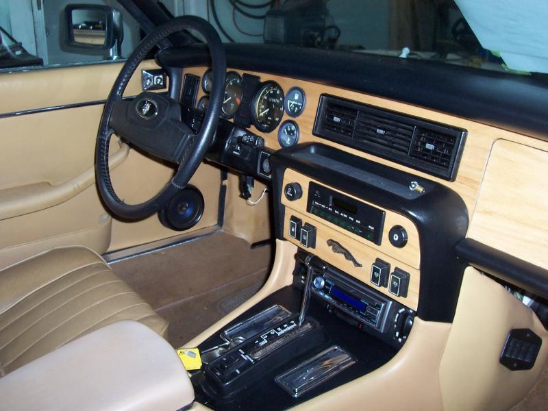

Just to clear the air. This is an 84 jag that was bought with a GM powertrain. See initial thread. To not continue the (GM) blasphemy, I used a 1975 Series II as a donor car for the powertrain to make the '84 a real jag again. So with the exception of the engine and transmission the car remains a 1984 Series III. Everything on the car is original 1984 Series III which includes the workings for a fuel injected car. The previous owner out of Texas did a John's car GM conversion but rather than leave the original electrical harnesses intact, they ripped them out of the car. if they were still there I would have put the original fuel injected engine back in. I bought this car on a whim on the internet and had it driven to Florida. To my amazement they removed everything that was not required for the GM engine to run. i.e all computers and electrical harnesses from front to back and even from behind the dash. As a result, the most cost effective way for me, based on what I had at my disposal was to put the Series II powertrain in and resolve all of the issues that would come with doing it. Maybe I am a glutton for punishment but when you have as much time as I have to invent being busy this was a great challenge. I am 90% complete and already thinking of what I am going to do with an XJS convertible I purchased a while back that is in need of (mucho dinero) to put together. To all those who fear the work and expense to get these cars together, I say that you should not be, because it is not as difficult as some people would make you believe. You may have to invest $ in a proper workshop manual and time in the Jaguar forum. There is a lot of good info there The rest is all common sense. See attachment of what someone can do if you set your mind to it. here are some pics of my dashboard. The darker one was the original and ugly. I redid it using oak veneer and twenty coats of polyurethane. It now matches the upholstery in my car.
Attached Thumbnails My 1984 xj6 project-100_0997.jpg   My 1984 xj6 project-100_0996.jpg   My 1984 xj6 project-100_1003.jpg

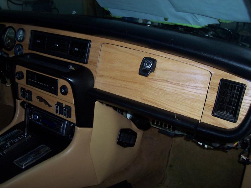

I'm selling a bunch of XJS parts if you need anything. I actually like that light blonde finish on the dash parts, never seen it like that, they're always dark.
Old Sep 11, 2012 | 03:01 PM
denraden1's Avatar
Joined: Mar 2012
Posts: 110
Likes: 12
From: florida
Jose, that's great. I will talk to you about that when I see you. The dash cost $24.00 for the veneer and $15.00 for the polyurethane. Total time: 4 hours. Used my DA to sand of the old finish then sprayed on two coats of adhesive promoter, laid down the veneer with a steam iron and walla!! Lightly sanded between each of the twenty coats. I used a heat lamp to accelerate the drying process. Buffed out with my polisher. What you see is the finished product. Will complete the console soon. Want to get the engine area done first. Re: the XJS i will be looking for a V12 for parts. Take two and make one. The engine in the may run, not sure yet. Still soaking with Marvel Mystery oil to free it up. Every other day it turns a little more. Was abandoned in FT Pierce for about 15 years but out of the weather. Lots of dry rot. No metal rot so far.
