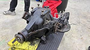

I would like to get “AEU1685J” a seal on the rear differential unit of 1991 Daimler Double Six as I found a major leak. Unfortunately, the part seems no longer available at any Jaguar parts stores. Does anyone know if any interchangeable parts available?

Try searching JLM11526 and/or CBC6923
These are earlier part numbers. As far as I know they'll work OK. I'm not aware of anything unique about the seal used in the v12 Series III cars such as yours

Also look for Land Rover part number AAU3381, it's the same seal.
https://rimmerbros.com/Item--i-AAU3381
