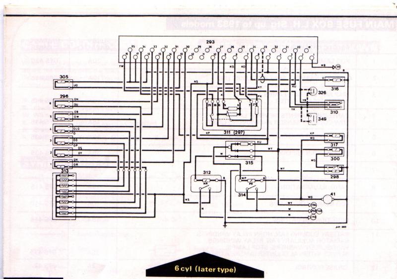

Default ecu diagram
anyone know what pin on the connector is the brown slate wire. i cant get to the wire or even see it. not much space in trunk . anyway i turn it i dont see it.

here's a diagram of the ECU wiring:

Default ecu brown/slate wire
has power ...thanks Jose
