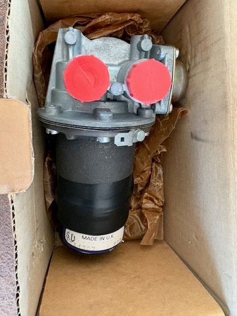

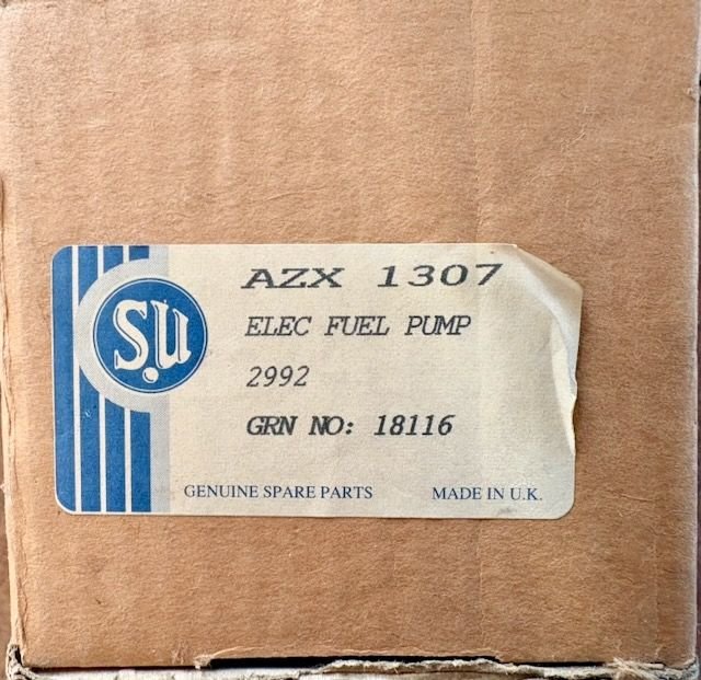

I have a genuine SU electric fuel pump, part number AZX 1307, made in the U.K., still new old stock in the original SU box. It was purchased decades ago as a spare for a mid-1970s carbureted XJ6 and was never installed.
Red caps are still in place. It has never been mounted or test-run.

Happy to post additional photos of casting numbers or ports if helpful.

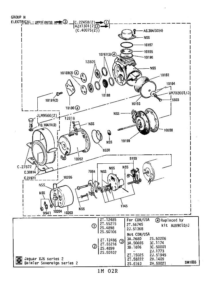

Unless it's a bargain, I have heard that the Hardi pumps are much better and longer lasting than the SU.
For Series 2 XJ, I see the pump specified as AZX1301 for VIN after 2T12486/ 2T55216/ 2S4889/ 2S50107. No idea what the difference is between AZX1301 and 1307.
