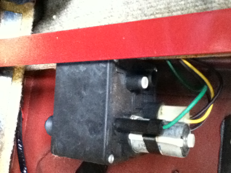

Recently had this happen to my car as well just as it rolled over to 96K. Thought I'd take a photo to clear it up for anyone still not sure where the reset switch/trigger is.
It's the white plunger in this photo. As stated above, neither the car nor the ignition need to be engaged for the reset to prevent the oxygen sensor light from being illuminated.

I found this thread about turning the sensor off on the dash lotsmof info. So I go to check in the trunk & I don't see a box that looks similar to the picture posted, is it in a different location on the 84' model?
Old Dec 24, 2014 | 08:15 AM
Jose's Avatar
Posts: 9,139
Likes: 2,662
in my1984 it is a black box mounted to the left of the sunroof motor, (which happens to be at the center), on a vertical metal support where the plastic screw that holds the upholstered panel screws into.
also mine has a white sticker that reads "XKE".

Found the o2 sensor & reset it! Name:  a2f2ea68e1524ea0b0e09d21fbc05c2e_zpse5816266.jpg
