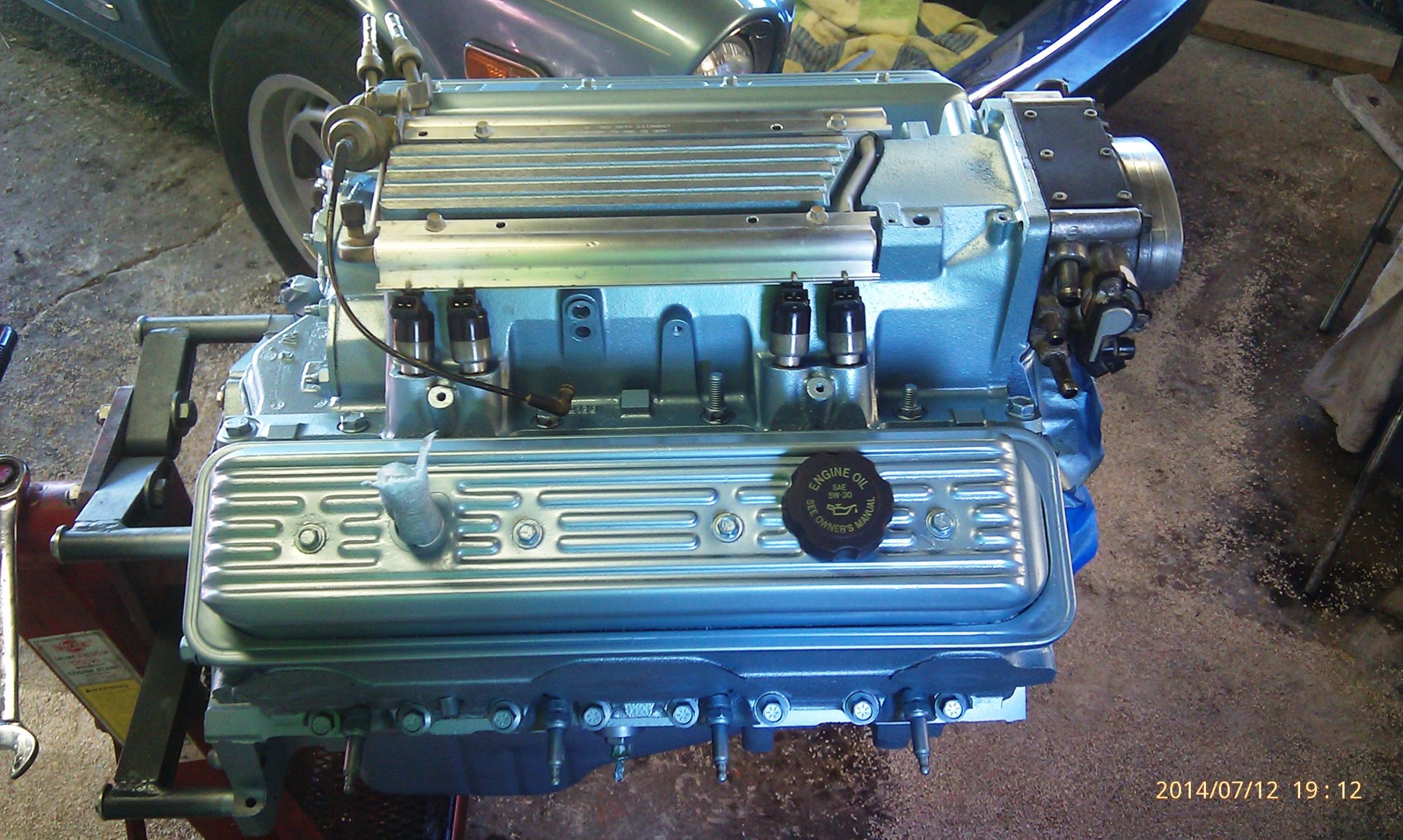

Sneak peak at my LT1:

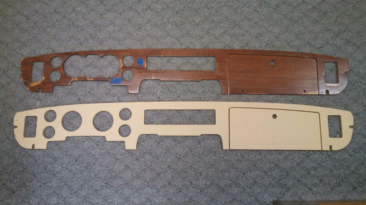

Well, I plan to spend the weekend test fitting my dash insert mockup board fitted with Autometer gauges! About 5 hours was spent just on the CAD drawing to get this trial piece cut on a CNC router. I plan to add indicators for the turn signals and high beams. Also, I have an addition to it in which I plan to have a small Jaguar logo routed into the lower right of the glovebox door by about 1/16". There is a technique I'm going to try which involves filling the recessed logo with a grey corian type glue material-letting it dry and then apply several layers of polyurethane coating so the surface is glossy and flat with a 2D logo look. It just seems there needs to be something on the door and a small Jaguar logo IMO would look pretty tough! I'll post more pics as project develops.
Attached Thumbnails pics of my XJ6 project "unghetto"-img_20140724_190704.jpg   pics of my XJ6 project "unghetto"-img_20140724_221247_010.jpg
Wow Nice work. Are you leaving out the idiot lamps?

The only idiot lamps I'm going to add are different colored LED's for brake warning, left/right turn signals and high beam indicator.
As for the glove box door logo badging, I am going to try to router about 1/16" out of the surface in the shape of the Jag logo, then fill the space with a grey Corian glue material and then once the whole piece is stained and poly coated, the logo will have a 3D look to it but be buried in the clear and I'll cut/buff the dash bezel just like an automotive finish and give the bezel surface a perfectly flat, glass like finish. I can see it in my mind so we'll see how it turns out.

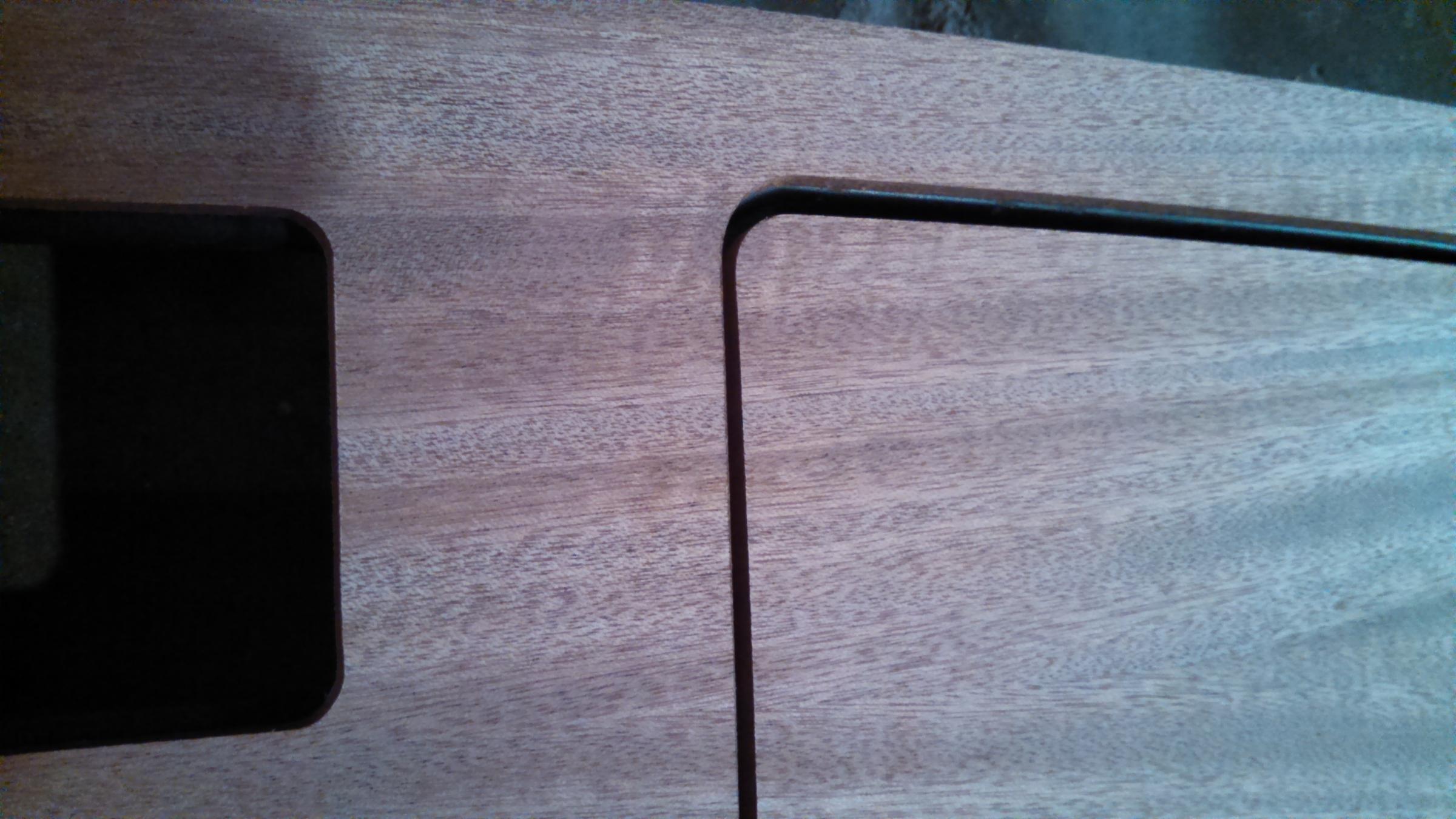

Ok...quick update-I got the final dash pieces routed and cut. I still need to figure a solution for the Jag logo-routing it out just wasn't an option in the CNC program so....thinking of a flat silver mylar that will lay over the stained surface and be buried in clear. But, the grain is really close to the original a the wood is a ribbon mahogany and is a solid piece instead of a laminate. Just test fitting right now....still need to add turn signal and high beam indicators LED's.
OK, You MUST tell us how you found the Exact tree from which the veneer was peeled!!
Joking aside, I don't know How you could get that any closer to an absolute match! I won't Even ask how many boards (or lumber yards) you had to sort through to get THE EXACT RIGHT ONE!!
As I have mentioned above, You, Sir, are an Artist!
