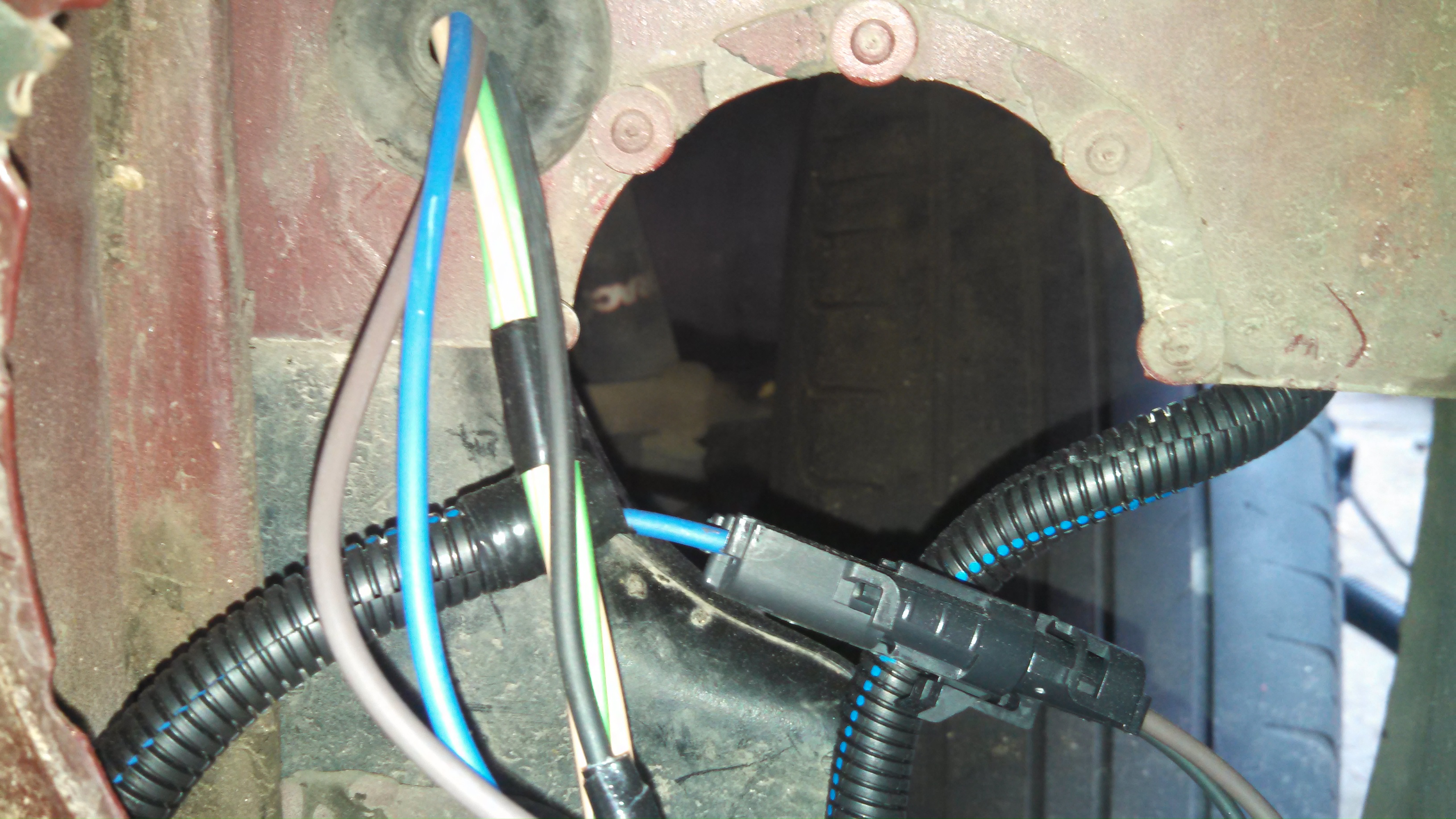

So....I did a little cleaning up of the factory front lighting harness to get it all ready for my GM conversion. I'm mounting a 2-gang relay bank for high and low beams, and tying in the turn signals and parking light leads off the stock headlight switch leads.
I removed the goofy "factory" aux. cooling fan and cleaned up that trough area and used the existing holes left from removing the fan bracketry for the GM style rosebud clips to secure the crossover lighting loom.

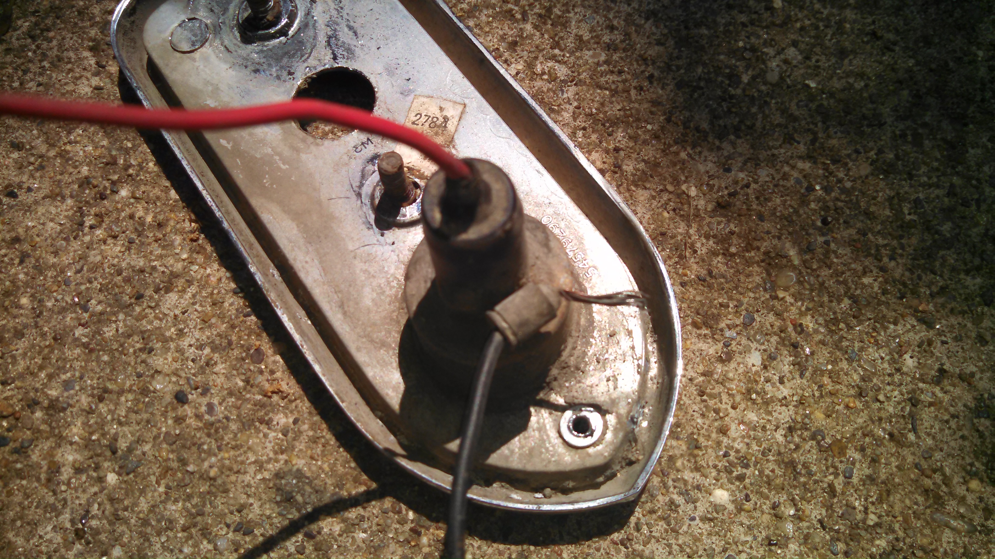

I had to solder the parking lense ground to the housing by folding the tab over flat, then slipping a connector over it and dip soldering. I'll undercoat it prior to final assembly.
