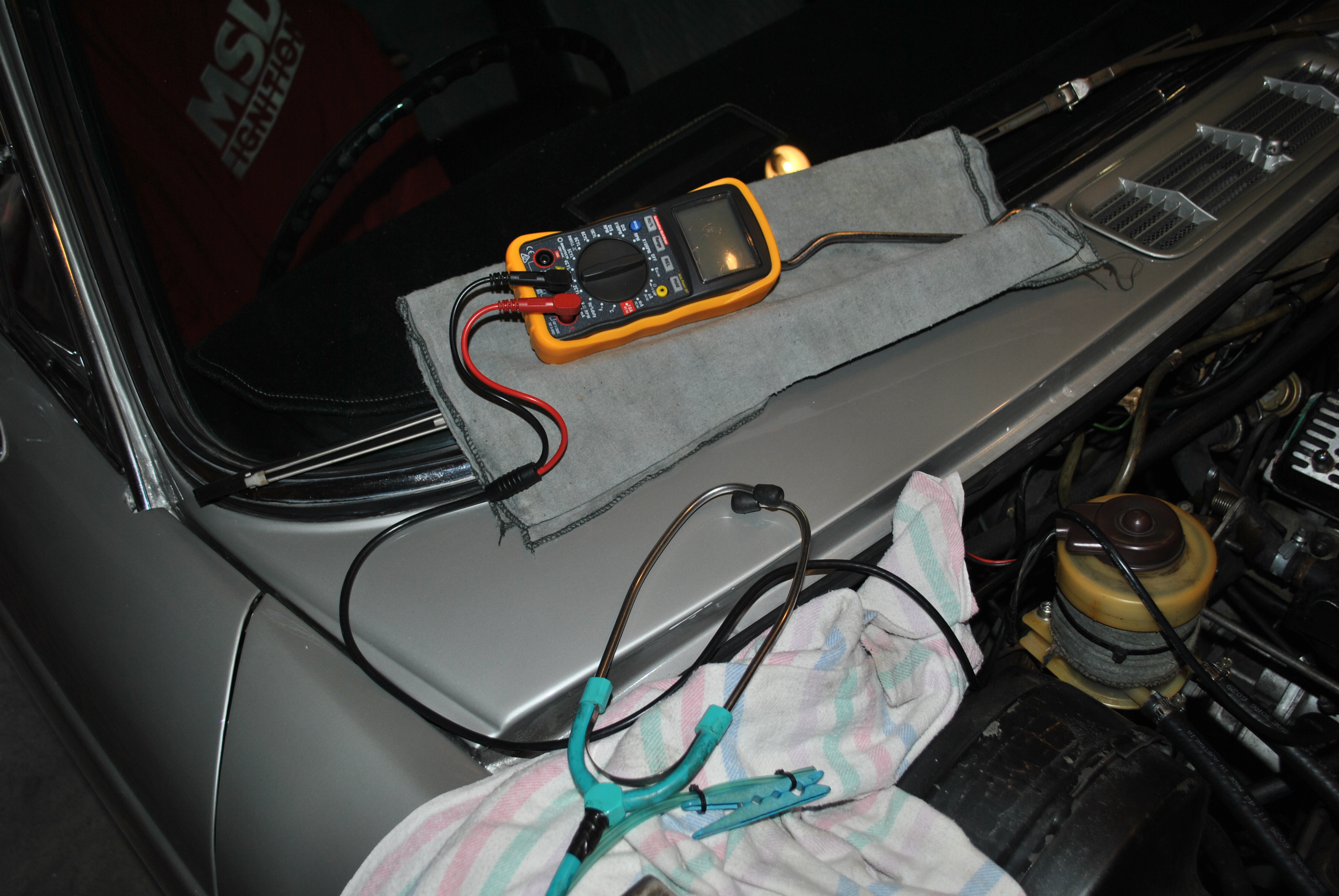

Default Competitive, maybe just a little.

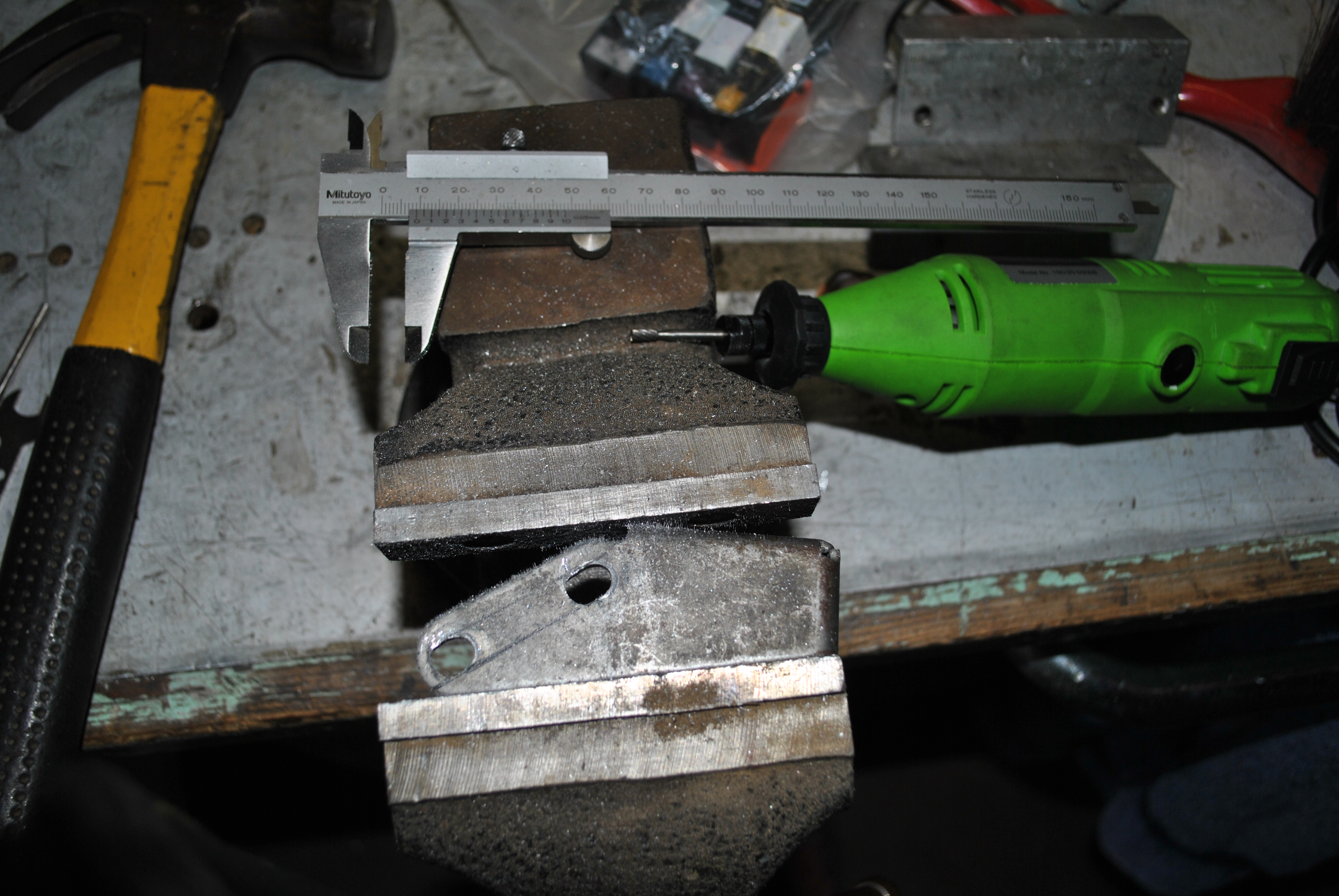

While the Dr is away the the owner will play.
Looking for a way to squeeze the extra couple of mph out of the old girl I started digging around. There was a bit of slack in the throttle cable when not extended and still a few degrees of movement left in the throttle rod when peddle was flat to the floor.
So by removing the cable bracket and making it's mounting holes into slots it has given about 3-4mm more adjustment taking the slack out of the cable,now being able to use the full travel of the peddle. Also lost 1/2 of the freeplay in the peddle from idle.
So now the throttle rod is turning further, but not quite making it to the stop. This should equate to more acceleration therefore higher top speed down the straight if my theory is right.
After playing around here I thought I would revisit setting the mixtures and idle balance. So after a bit of adjusting all sounds good and idle is spot on 650 rpm in park and just a gnats dick under 600 rpm in drive.
