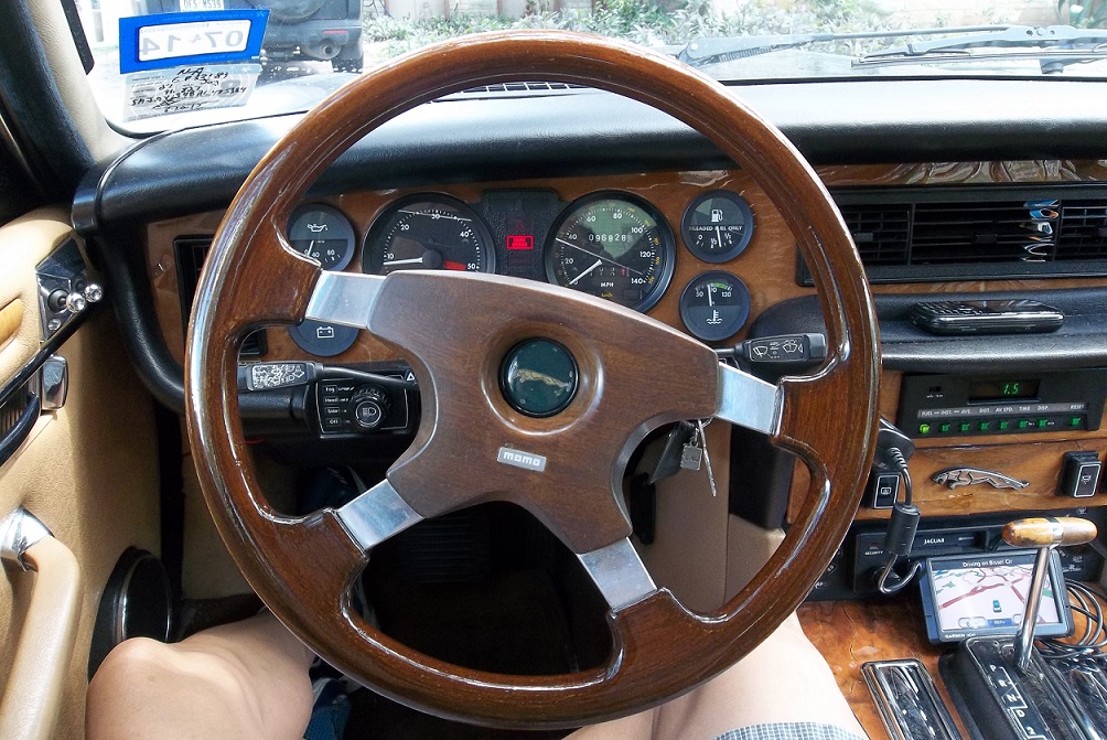

Ok, so I got my XJ6 all legal except my horn doesn't work all of a sudden. The fuse looks good but I figure it's a fault at the wheel (aftermarket wood Momo) so I'll trace that. Next on the list is getting the speedo to work. It is dead, except when shutting the car off the needle jumps slightly. Not sure where to start: new speedo, sender, something else? Got the AC working well again and overall the car drives like a dream. Also need to get windshield washer pump to fire up. Thankfully this car is in much better condition than my Triumph or MGB when I bought those.

Any chance of posting a pic of your momo wheel by the way ?

So my horn fuses are good, next I'll check the relay. Hopefully that with all the other suggestions will bring it back to life. I will post a pic of the wheel as soon as I take one. Tonight's project is to check the AC amplifier fuses and connections and clean all them.

Last edited by mikecyc72austin; Sep 9, 2013 at 12:00 PM. Reason: Image didn't post

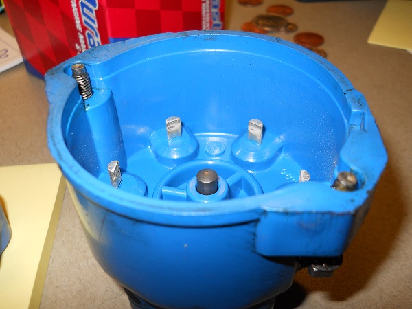

Well, at lunch I changed my rotor and cap. Wow. Rotor was worn and burned slightly, cap was worn and had lots of metal dust in it. Started up and had faster idle, and was smoother. We shall see how it runs enroute home (2 miles) and later tonight I'll do the plugs and wires. I'm curious to see if there is any driving improvement with just the cap and rotor. Part of this approach is to see if I can identify a main cause or if it is cumulative.
Ok, car ran much better, obviously. More power, smoother sound, still slightly lumpy idle but nowhere near as bad. Today is plug wires at lunchtime. Still had a few stumbles though minor at idle in drive, BUT also was low on that tank of gas, so I'm suspecting the fuel filter, which I have also ready to go in. I just want to see if any one of these items nails it.
