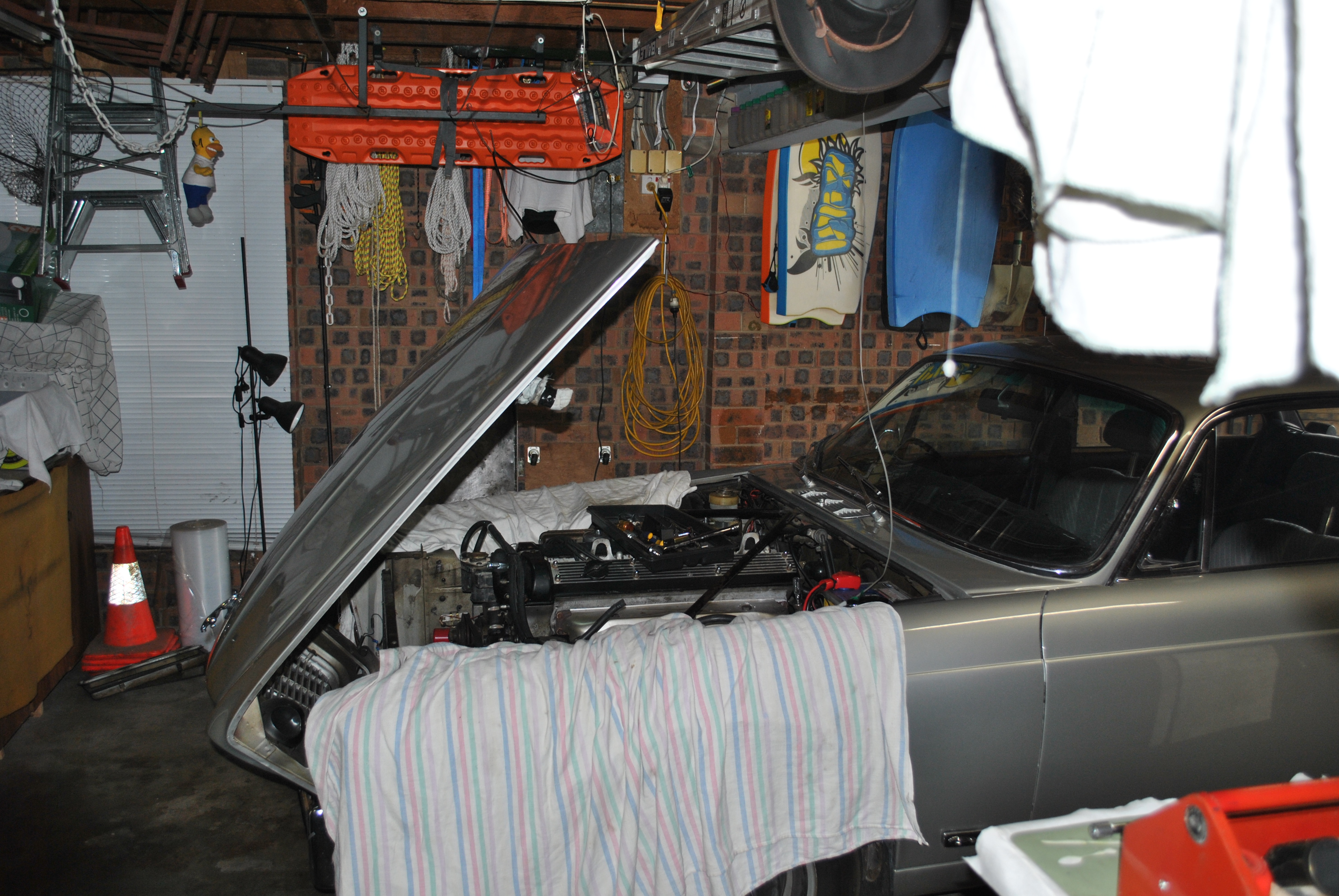

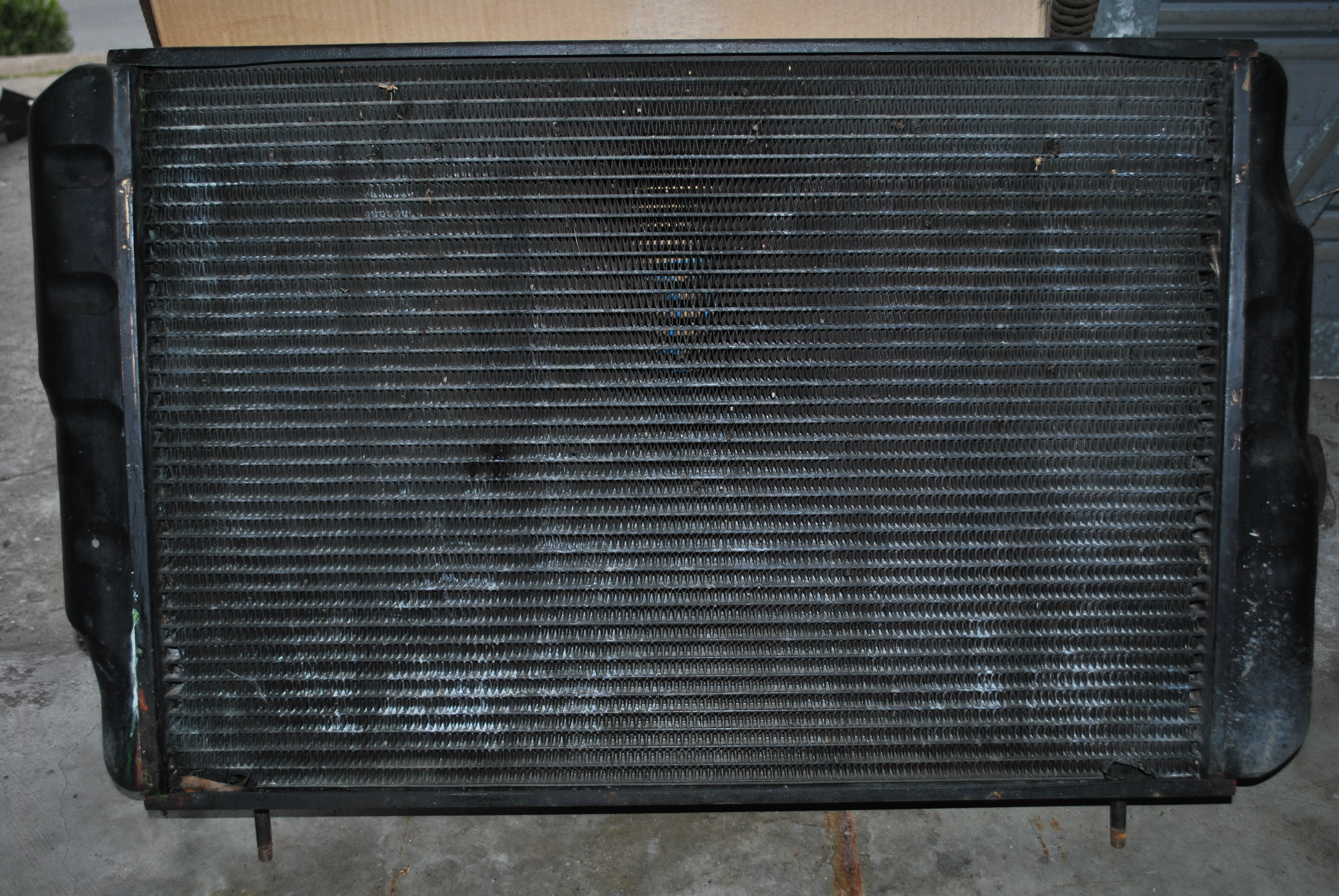

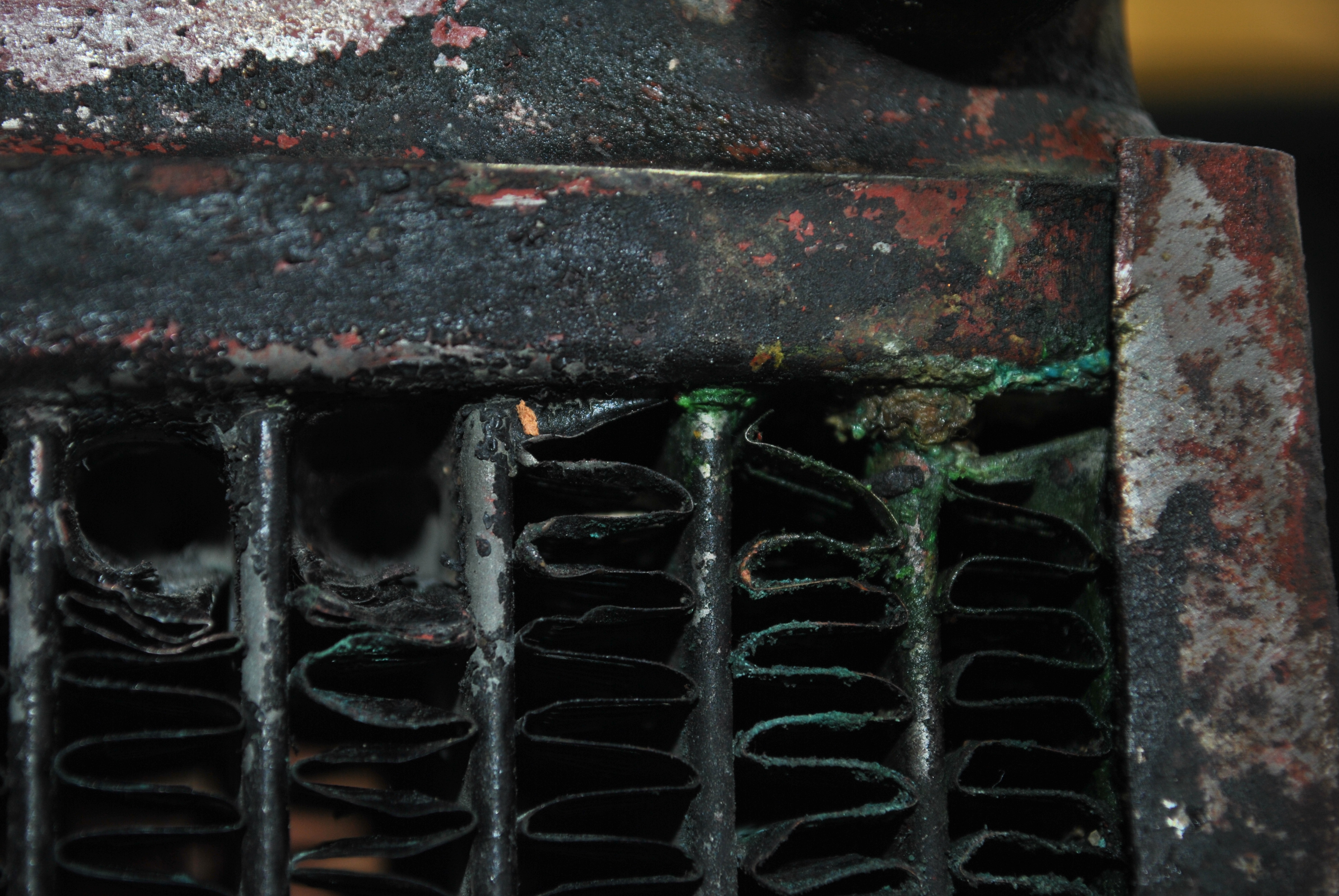

My XJ6 has been using(or losing) 200-500 mls of coolant a week. Not enough to cause problems, but enough for me to check it every few days. I have even driven it to Sydney(1000 km) without a concern.
I moved my car after leaving it sitting for 5 days, to find quite a decent pool of coolant where it was parked. Further checks came up with a 2 litre loss off coolant since last Sunday.
It hasn't lost any for the last few weeks since putting a cap on the overflow bottle.
I couldn't find any leaking hoses so I removed the radiator since I could see traces of evaporated coolant around the bottom of the left tank. I found a small leak at the top of the core on the left side, and a sizeable leak on the top the right side of the core. I think the leaked coolant came from the right side and found it's way to the left side before dripping on the floor. I had assumed the core was good because all the bits I could see looked like it was in pretty good nick.
Last time I drove it last Sunday we covered about 300 km and never had an issue with temp or leaks, I think I lost most of the coolant in the garage.
Will drop it off tomorrow to have it re cored and hopefully have it back for my next day off on Thursday.

Clarke, did you have to break into the AC to get the rad out?

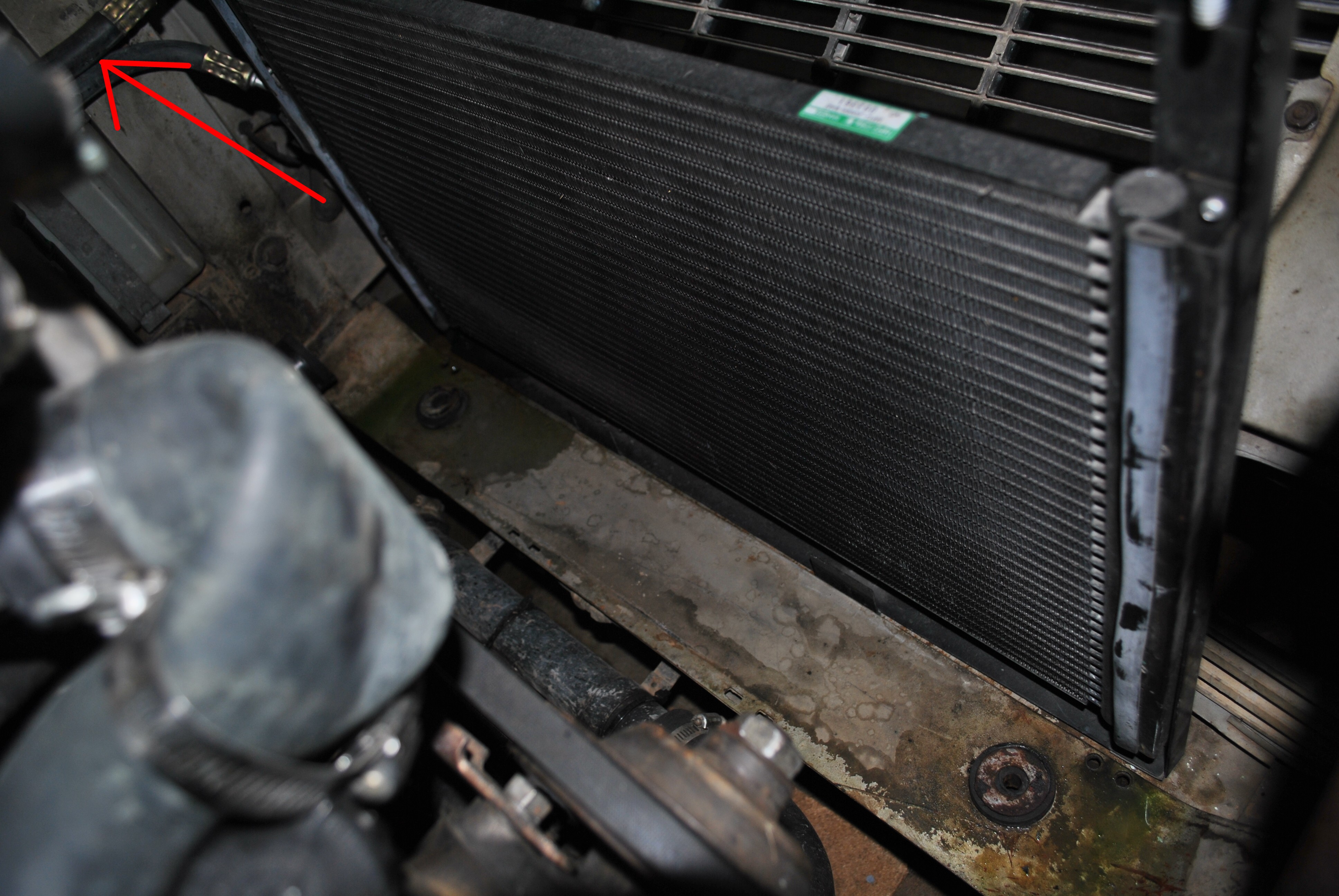

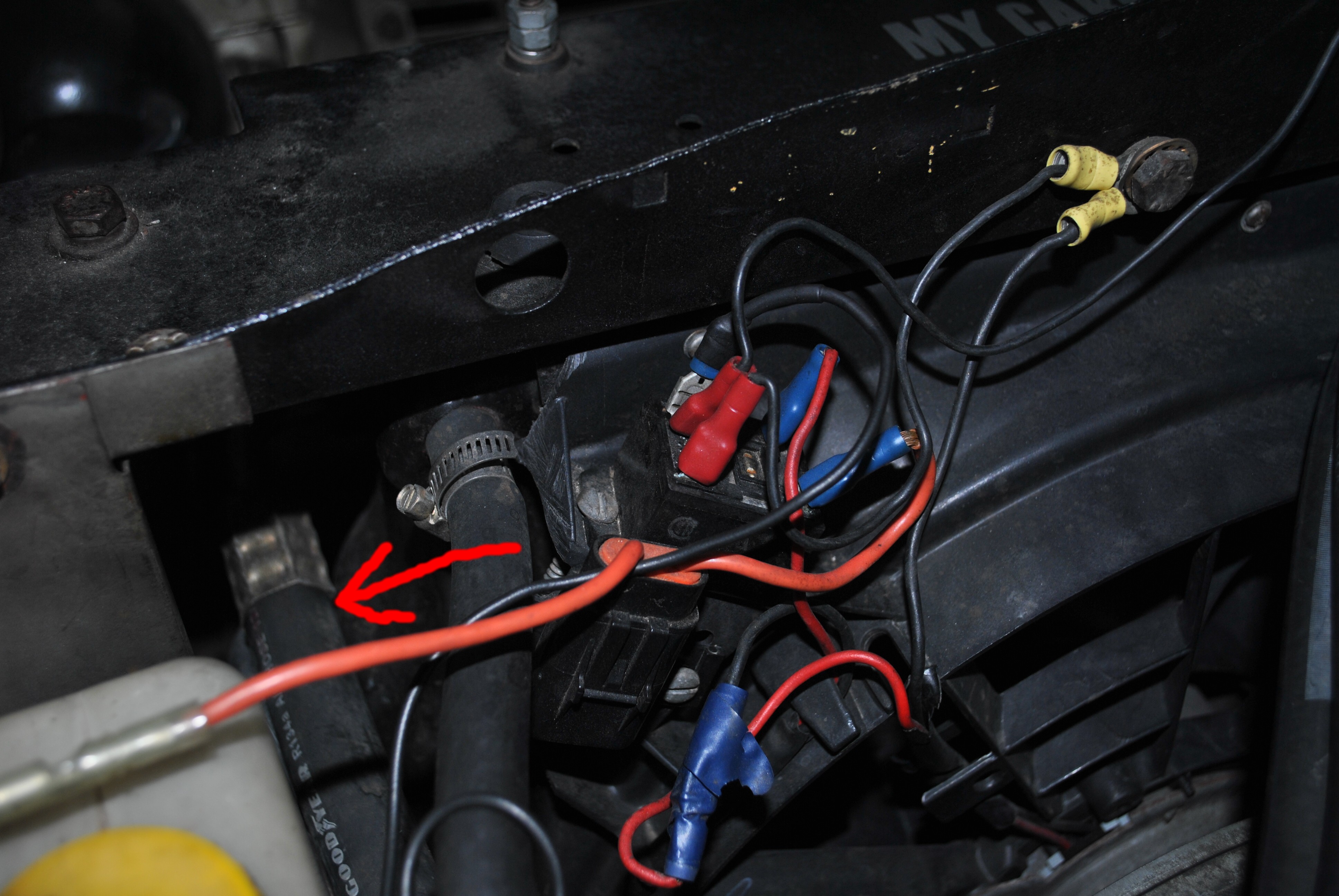

Just enough room to force the radiator past hoses, it took a bit gentle persuasion but it is all in tact.
I dropped the radiator off at 5 am on my way to work, had a phone call at 9.45 saying it was ready to pick up. Can't get back there until Thursday to pick it up.

Oh good!
It looks like you didn't have to take the hood off either. I didn't know one could disconnect the safety link and let it stand up on its own or I would have done that.
Now I have to get it back on without damaging the other body work. That promises to be a Lot of fun!

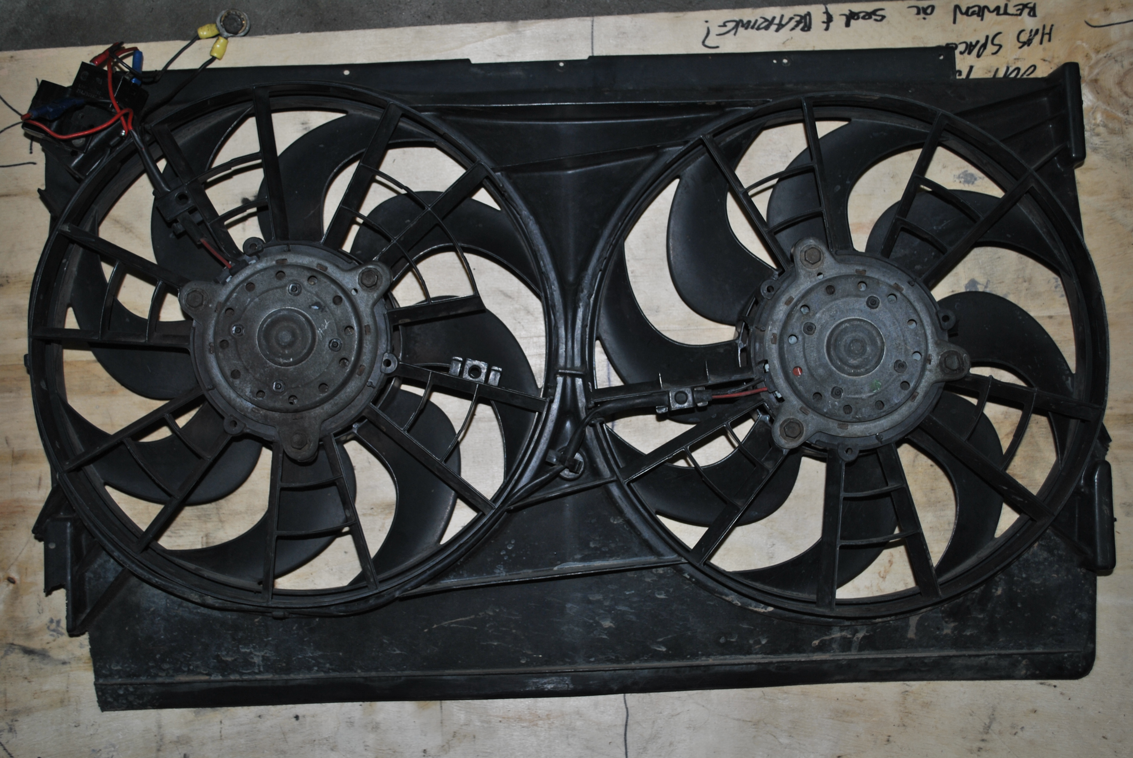

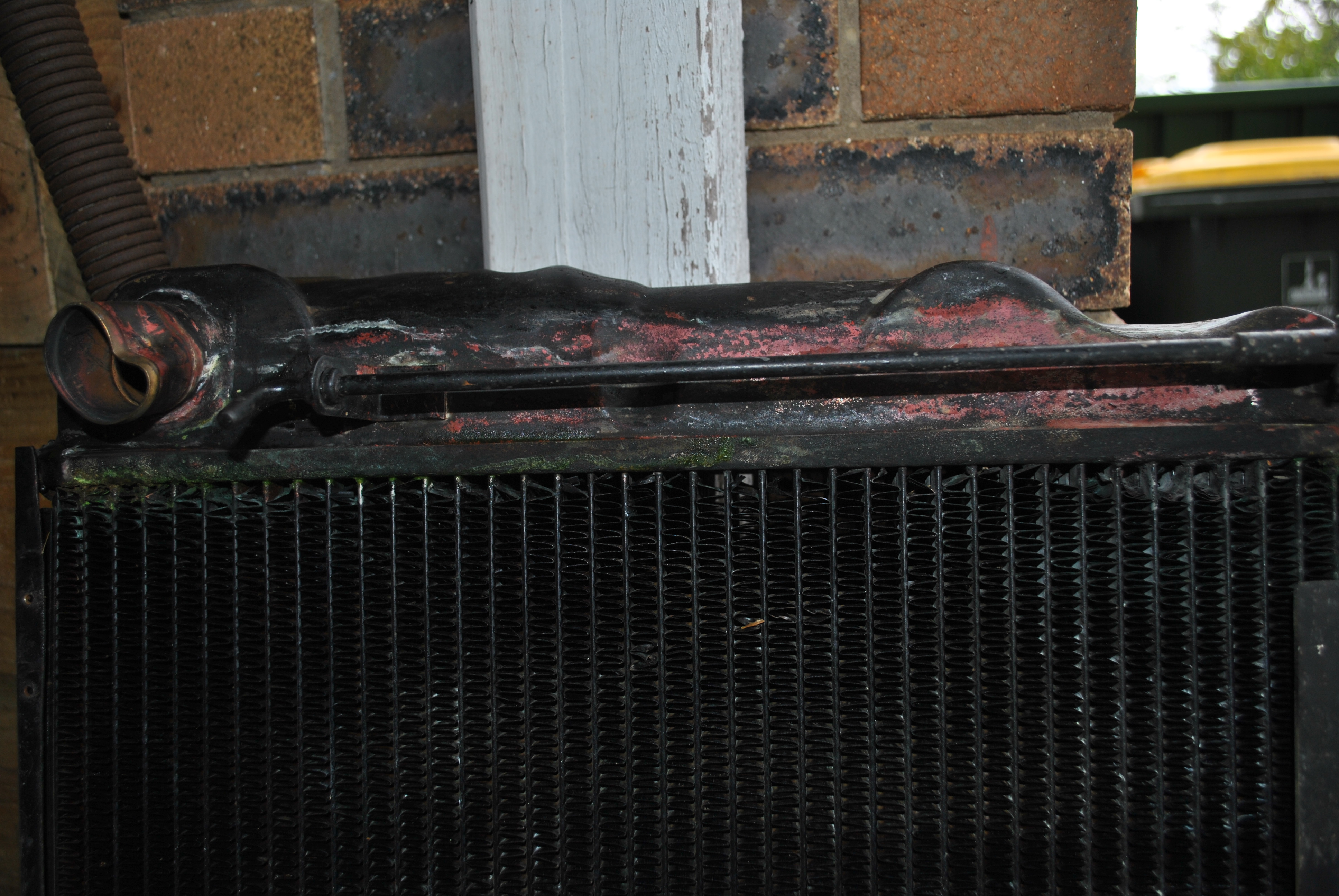

Oh good!
Safety link? Not on my car, and it doesn't look like anything has been removed. Maybe never had one, just tipped the rad back over the engine as I lifted it. Should have removed the fans first to make it lighter and give more room. I just assumed it was screwed on at the bottom, but they just sits in a channel(I know for next time now).

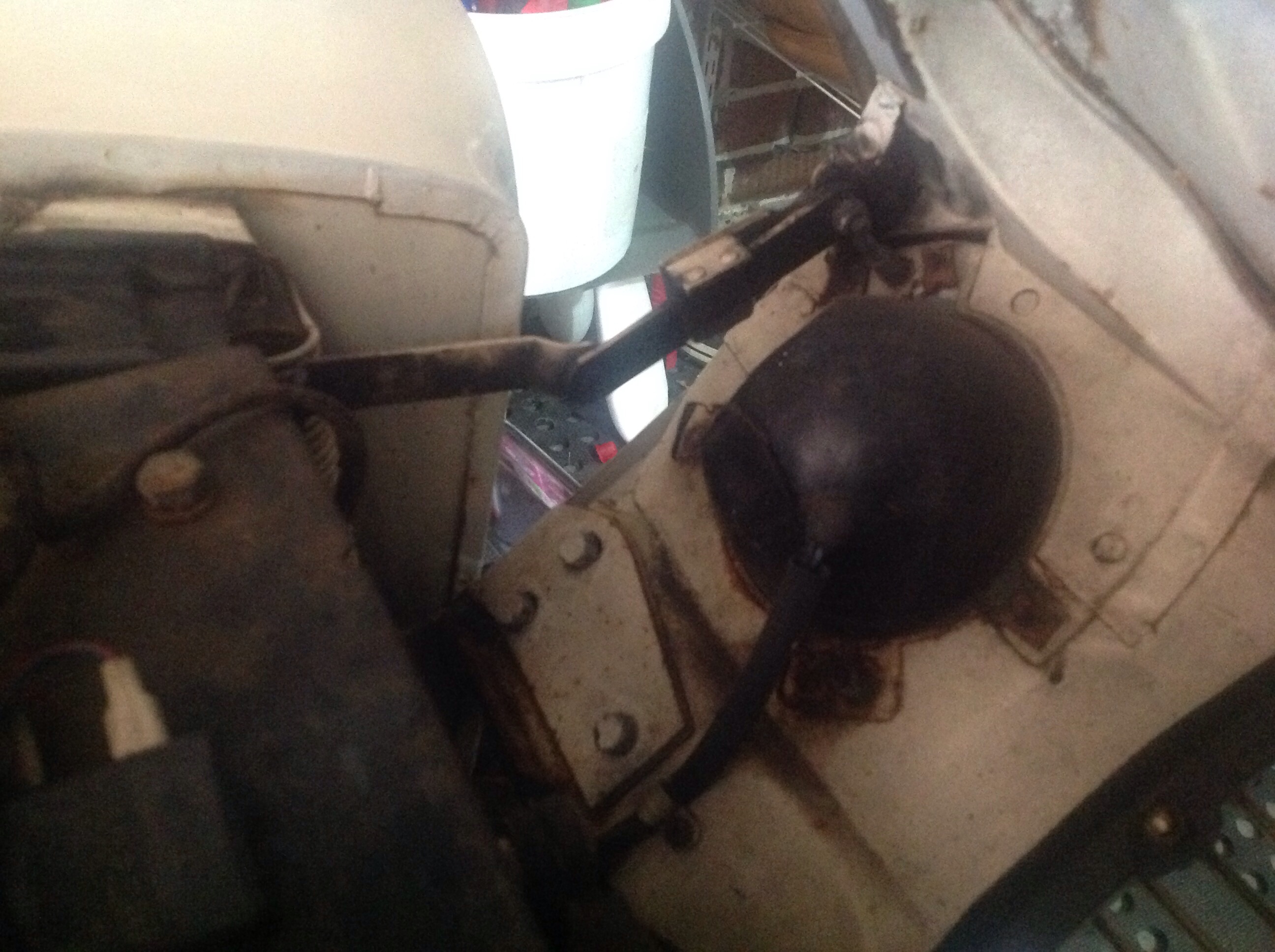

Maybe Series I didn't come with that link, Clarke.
Mine is on the driver side:

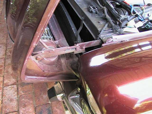

Old Jul 21, 2015 | 06:03 PM
Daf11e's Avatar
Posts: 46,034
Likes: 4,715
Same side on my ser 2 passenger down here.

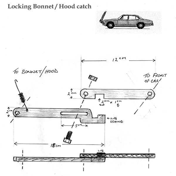

if you fabricate an extended linkage you can open the hood almost 90 degrees. I haven't done it because I don't understand the drawing.
Attached Thumbnails Radiator out.-xj6-bonnet-latch-2.jpg   Radiator out.-xj6-bonnet-latch-1.jpg
