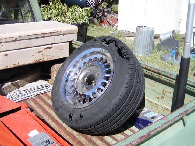

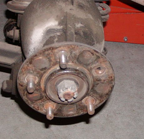

It's been several days since I posted about my blowout of a left rear tire on a right curve at 70 mph.
We thought it would be a straightforward process replacing of a tire, perhaps even under warrantee as it has fewer than 5000 miles since "new" and therefore not an expensive project. Well, that's not gonna happen.
Research for reasons for the failure revealed the tire, Michelin Radial X (no longer made), was built in April of 2004!! It came from COSTCO, probably a closeout from some tire warehouse somewhere. Just the thing to put on a car one is listing for sale! They still had rubber whiskers when we first looked at the car in August 2013. Upon that discovery, husband decided to replace all the tires with new, 130 mph rating, stiffer sidewalls, General Altimax HP. Not the best tires, but the best we could buy considering all else we're doing.
WHENEVER BUYING TIRES BE SURE TO CHECK MANUFACTURE DATE!!
There was also the issue of the missing rear stud. Husband decided to only replace that stud as we have a dead line and it won't be too difficult. But the front studs are also suspect because when the tire guy was mounting the last time, one of them simply kept turning, and turning, and turning until if finally reached the specified torque. Since we don't know exactly which one that was husband is going to replace all the front studs. That requires removal of the entire front hub assembly, calipers and all, contrary to what the Official Jaguar ROM said! BUMMER!!

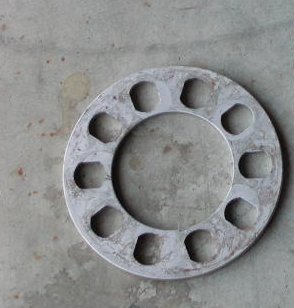

My Tear Drop rims require spacers so they don't interfere with suspension and body parts. When we got the car there were 2 (two) stacked 3/8 inch spacers, some of the cheapest known to mankind, on each front hub; 3/4 inch total offset (also 3/4 inch fewer threads holding each tire)! Perhaps that's one of the reasons it handled so poorly. We jettisoned one spacer from each side as soon as we discovered the situation. Handling improved. Only one spacer on each rear hub.
Husband found some hub-centric spacers, billet turned with flanges, with individually drilled holes instead if the Huge, sloppy slots intended to fit everything but fitting nothing correctly. Spacers should have longer lug bolts for optimum tire security. Those had to come from Across the Pond and they didn't exactly give them away.

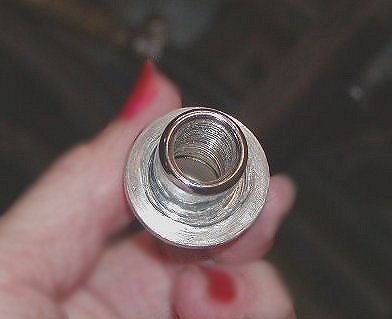

New longer studs should have new lug nuts, mostly because husband doesn't trust the ones we have. They weren't cheap either because he wanted good quality shiny ones, longer than stock, that would secure my rims.
Are you getting the picture now? What started out as a straight foward, easy repair has grown exponentially to a Major project! But he's the Banker and he wants to do all this, so I'm not going to stand in the way as he throws money about, especially when it's going toward my Jaguar. Still he assures me all will be finished in Plenty of time for the club cruise September 20.
There are probably several things I've neglected to mention, but as this thread goes along I'll doubtless add them.

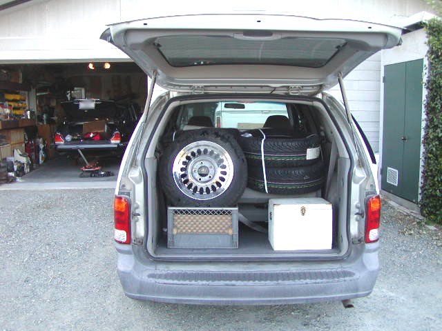

Below are some photos for your viewing pleasure.

Good call to fit a full set, I'll look forward to reading more.....
Elinor:
You got a good guy. Looks out for you. Keeping the wheels on is a biggie!!
Almost lost one a few decades ago. At "speed" on the Golden State Freeway in my 63 Corvair Camperized van. Only the body tin kept it sorta on. The drum was riding on the inner edge of the Mag wheel.
I was wondering just how the description of changing the front lugs was going to work!! Answer, it won't !!
And, yup, those spacers are awful, they did exactly as i suspected. Not wheel to hub centric. All the load on the bolts. Not good at all. Hubbie's choice is much better if you must have spacers. Have you tried fitting the wheels sans spacers??? Is it tin and suspension clash of a failure of the wheel centers to match the hub center?
COSTCO deserves a rip for selling 10 year old rubber.
Fresh studs and nuts is far from over kill in view of the risks and history.
Touring tires suit most of us just fine. How likely are you to exceed 130 for long stretches. That annual race in Nevada for the 200mph folks???

Elinor, for the teardrops to fit are you saying they have to have 3/4" spacers on the front and 3/8 on the rear? I'm looking into fitting my spare set of teardrops onto my S3 XJ6 for the extra rim width. Do yo mind if I ask where hubby sourced your spacers?

That's what the car had on it when we bought it, but husband was so astonished/furious about the shortened effective length of the lug bolts he took off one spacer from each side. I have had no interference between tire/body/suspension with only 3/8inch spacers in front, there was only one spacer on the rear and we left it one alone.
It's possible, however, that IF the car had 70 series tires, OEM specs, instead of 60, the situation might be Entirely different. I like how my car looks and how low and, well, menacing for lack of a better word, not to mention the lower center of mass and enhanced cornering, with the 60 series tires. It sits noticibly lower than one of the club member's SIII with 70 series tires.
Here's the web address:
Billet Hub Centric Wheel Spacers Jaguar (Pair)
He ordered 5 of these (individuals, not pairs) on August 20, they are supposed to arrive by September 3. I'll post when they arrive and how they fit, as the company warns they don't fit all cars without modification. I'll also post what if any mods are required for my car and why.

Quite a lot of thought has gone into these spacers, Carl. This is the first experience either of us has with such things. That's why he spent so much time looking for hub-centric ones. Something about getting used to not doing his own laundry or something.

Had a thought. The interior diameter of the hub spacer must be large enough to fit over the shoulder of the hubs. And the exterior circumference must be small enough to fit within the wheel. and, snugly in each case. As the material suggests, machining may be needed. Measurements and/or trial fittings may find things just right, or....

But husband has a contingency plan in case they don't bolt right up, because there will be no more of this business of the lug bolts supporting the weight of the car and stresses of cornering.
We won't know how they fit until the spacers arrive and we try them on the car. At that time I'll post if they fit or not and what modifications are needed if any.

No spacers yet (maybe tomorrow) but the rear lug bolt in regular and long variety is here. Only one of each just in case the longer one doesn't work the regular one is here for insertion without waiting. Whichever one works best will soon be joined by 9 others to make 2 complete sets.

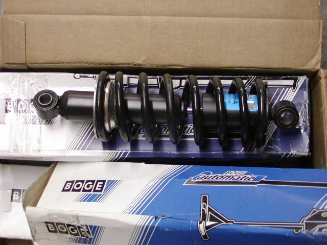

Front wheel seals came today as did spring-over shock absorbers, although their individual shock absorber boxes were much worse for their trip.
Proper washers for the chrome lug nuts (chrome nuts are still in the pipeline) also arrived. Not a single washer was the proper size.
If the washers fit snugly around the nut they were Very loose on the rim. Some were loose on both (that was a scary find!). Some of the washers bore scratches and scars, not to mention warping, because they just plain didn't fit and have become conical from being forced into a hole that was too big! (First photo)
The replacement washers are fully 1/8 inch thick (twice the thickness of the existing washers), fit both the lug nuts and depressions in the rim *Perfectly*! The second photo below shows the variety of fit -- or lack of it.
Hopefully you can make out that left washer (no nut) in the second photo (two lower holes are empty) is sloppy for both nut and hub, the right one is too small for the hub but fits the nut well. The center nut/washer is a perfect fit for both nut and rim and will hold the rim to the hub Much more securely than before. In fact, I'll go out on a limb and say no wheels since the car was new have fit as snugly as these Tear Drops will when I'm finished with them.
Already sitting on my desk are longer-than-standard front lug studs, which require disassembly of the rotor/caliper to install. That operation will come later.

McGaard is an old firm with an excellent reputation for their products.
Yup, I did not understand, how you could fit new lug studs to the front hubs without removing them. Odd Brit tech writing??? Or just that common language separating us???
