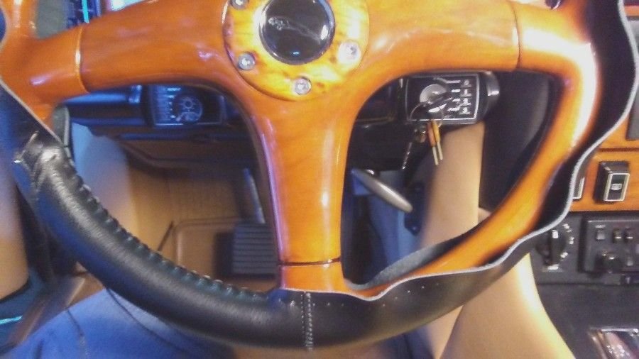

doing a cross stitch on my new Momo Italy wood steering wheel.
not easy. This will take 3 days at the rate I'm going.

I am doing cross-stitching, it requires two straight needles, one at each end of the thread. You cross a hole with one needle, then across it with the other to form an "X". Very difficult because I get confused and end up screwing it and have to pull the thread out and restart. If the phone rings and I answer, when I get back I have lost the rythm and have to figure it out again.
Then I use a curved needle to pull the previous two or three "X" stitches tight while pulling on the two other thread ends. It is starting to look "pro".
Today I'm doing another quarter and that's it, this is not an easy job. No wonder they charge $300.00+ to re-cover steering wheels in leather. Wearing blue rubber gloves helps with grabbing and torquing the thread and holding and pushing the needles through the leather.
I'll post a picture when I finish. The combination of black leather and wood spokes looks awesome, and the color tone of the Momo steering wheel matches the dash and console panel perfectly. I got this wheel from David. Then Saul at British Autowood did the horn push center ring because he owed me !

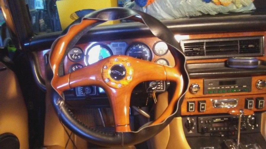

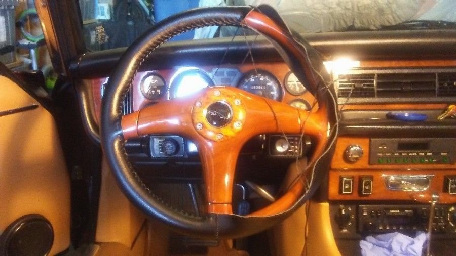

Day 3 or 4, can't remember. Only halfway there. I'll do another quarter today.

Now that you have so much done and I can see the difference, and more of the cabin shows in the picture, that Will look nice when finished!
