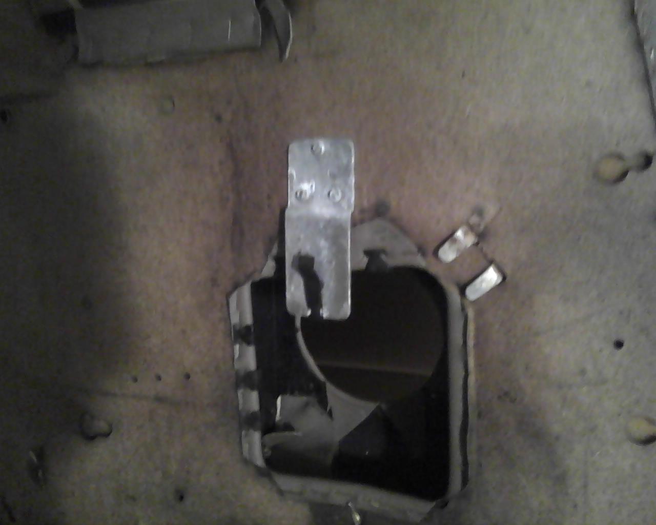

Here's a pic showing the tab. I had forgotten that there's another clip thingy attached to the tab which might account for your difficulty....or maybe not. I can't quite remember what purpose it serves. it was some time ago that I removed the panels
Well, anyhow, the pic will help you visualize what you're up against, hopefully

Originally Posted by Doug
Here's a pic showing the tab. I had forgotten that there's another clip thingy attached to the tab which might account for your difficulty....or maybe not. I can't quite remember what purpose it serves. it was some time ago that I removed the panels Cheers DD
it's a ground so people don't get electrocuted when lightning hits the car.
