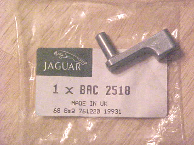

you can open it and close it manually;
there is a little tool that was included with the car when it was new, a little crank you can still order today from a Jaguar dealer. The picture below has the part number on it.
go to the trunk, remove the upholstery panel at the rear of the trunk removing two black plastic screws, (use a nickel or dime to unscrew those big screws), and you will see the sunroof motor at the center of the steel wall behind the rear seat; Attach the crank to the shaft sticking out at the bottom of the sunroof motor, and turn it counterclockwise to open it, and clockwise to close it.
While there, check the wiring connections to the motor. Also check that the connector at the back of the sunroof switch on the ski slope is correctly seated, very easy to mis-connect. These motors rarely go bad. I bet it is a wire / plug connection issue.
