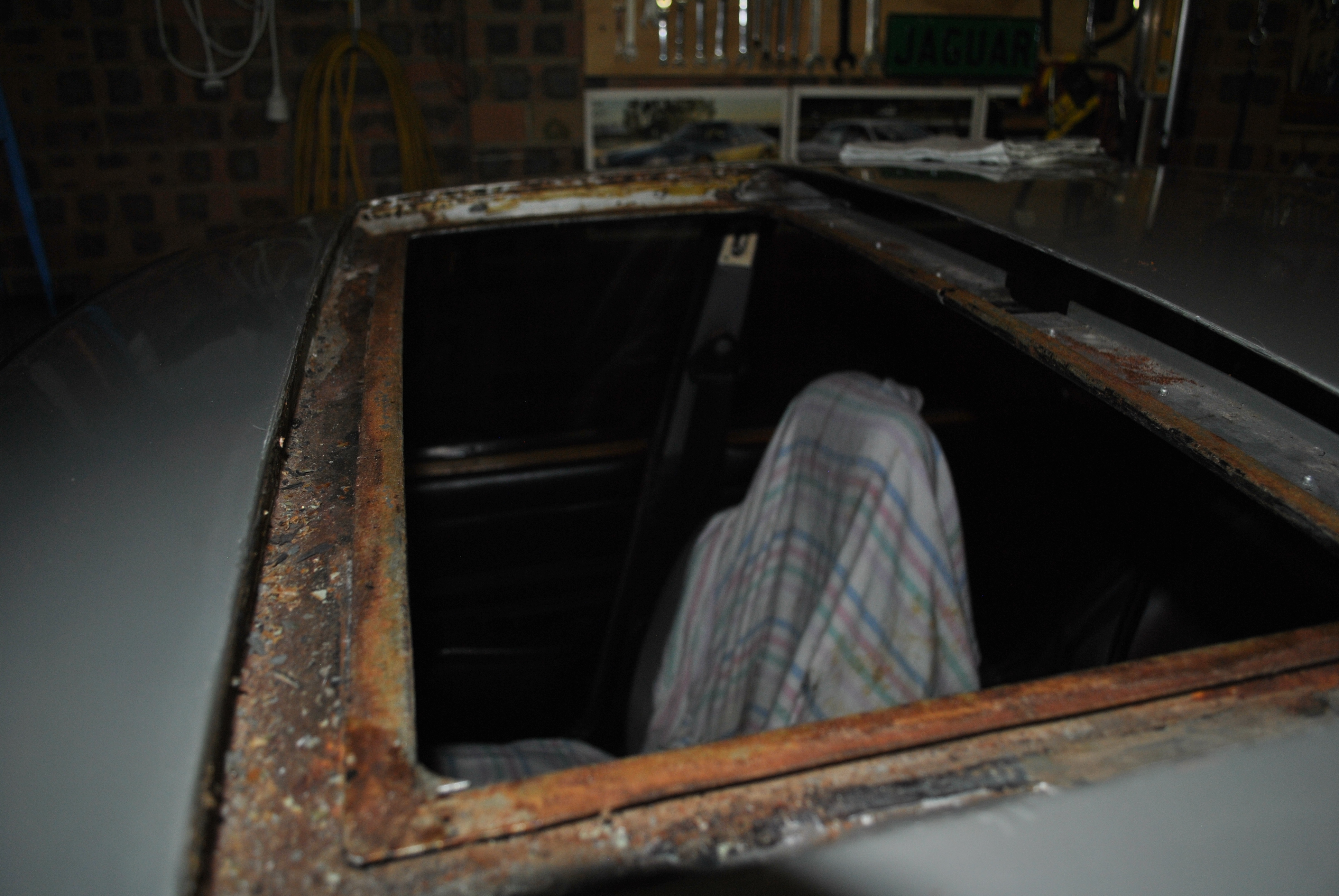

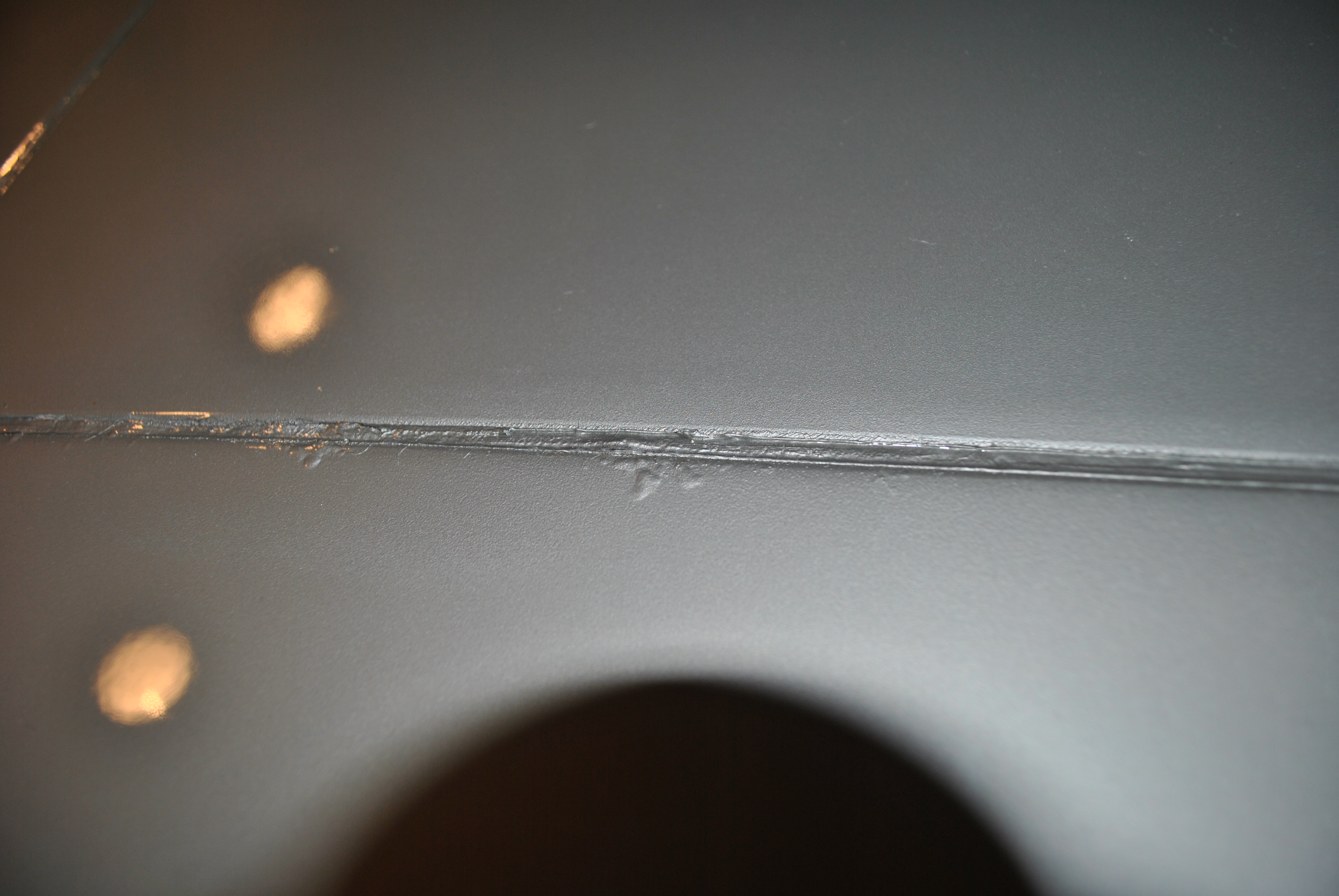

Not wanting to scare you, but what started out as a couple of little bubbles in the paint around my sunroof 12 months ago.(very like the picture below.)

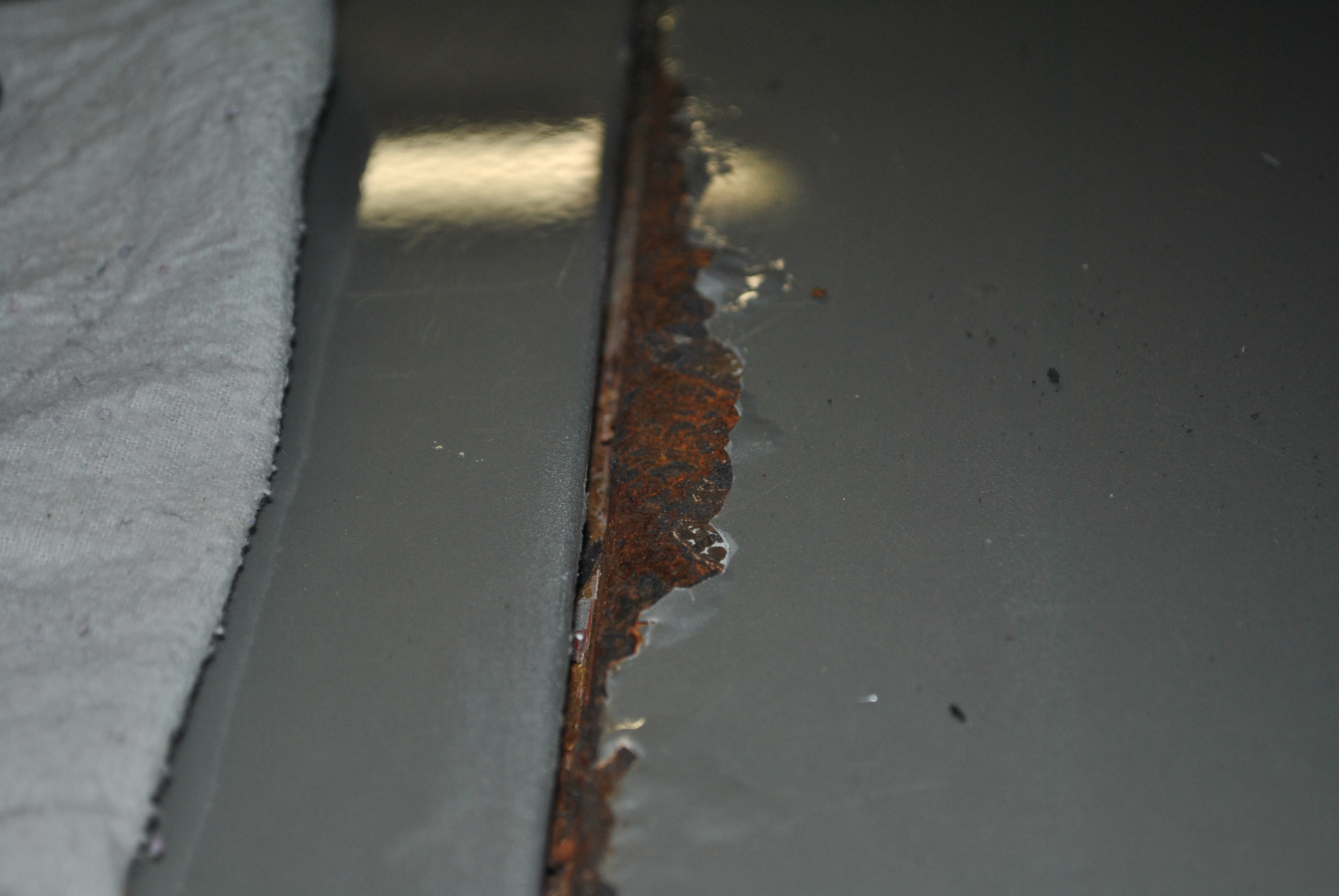

Turned out to be this rust monster once uncovered.
A Tale of Two Rusts...-dsc_1283.jpgA Tale of Two Rusts...-dsc_1304.jpgA Tale of Two Rusts...-dsc_1318.jpg
