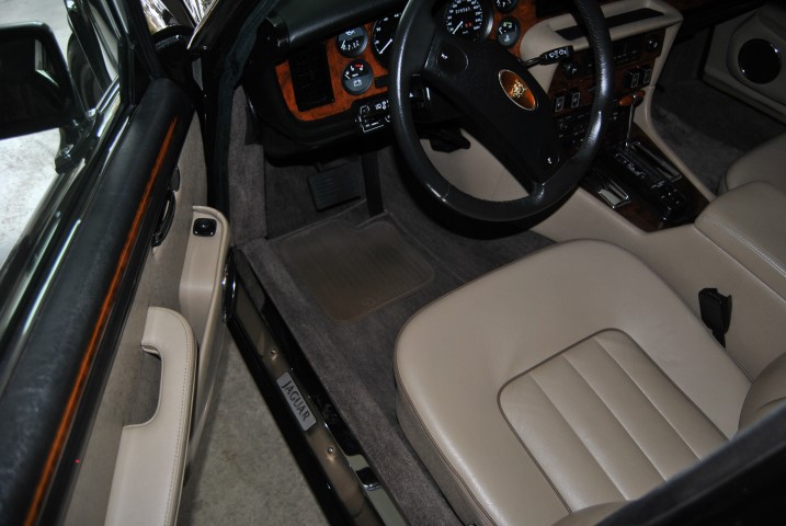

I'm changing out the seats on my '88 Canadian S3 VDP to those from an earlier 80s US VDP model. The main motivation is that the U.S. VDP seats are so much nicer and luxurious with full leather instead of vinyl side panels.
Some interesting observations:
Front Seats: No chrome adjustment bar on front seat for US model. No passenger electric seat height adjustment. Both can be swapped easily.
Rear seats get interesting. The U.S. Version has no headrest (came in late 80s I understand) but is an excellent twin bucket outfit with a deep armrest compared to the Canadian bench seat.
The rear parcel shelf needs to be longer and has a lip where it meets the seat. Further, the center section is different to cover the sunroof cables hiding just above the center armrest
The old parcel shelf is water damaged, and I need to either repair or replace. But even so, I see a gap in the corners where the seat meets the C pillar. Can anybody with US VDP please post a pic of this part so I can see what the original looks like?

Hi Warlock,
Just an aside, but..
Also happy to be corrected as there seem to be some peculiar differences with different market specs.
However, it is my understanding that Vanden Plas interiors meant all leather (no vinyl surfaces anywhere) and individual seats in the rear, not bench.
The upholstery in the front should match the rear, in that the pleats on the seat part are hemmed in by an outer hoop of leather ie. the pleats don't extend all the way across the length of the seat.
Your Canadian VDP seats look like stock xj6 / sovereign seats.
That was also my thinking. Not sure about XJ6, but those seats are exactly the same as in my '84 Sovereign.
Yeah, jaguar reckoned the Canucks wouldn't notice. I've seen a number of Canadian S3 V12 VDPs on eBay and they all appear to have the same seats. That's why I'm going though this exercise

Gentlemen: a primer on the Canadian V12 Van den Plas:
The V12 VDP was produced from 1982 to 1992 inclusive, and after 1984 was made for Canada ONLY, in in very small numbers, the largest number being in 1986 when 624 were made. By 1989 the number was down to 69 (and these are calendar years not model years - Jaguar kept no separate model year figures for the V12 VDP) ...for 1992 a run of exactly 100 specially equipped and trimmed and individually numbered cars was produced.
From 1982 to 1987 inclusive, and again in 1992, these cars were straight Daimler Double Sixes (and listed as such in the factory build records), but badged as Jaguars for the Canadian market and with certain Canada-only items - such as the bonnet-mounted windscreen washers heated by the tubes running in the engine compartment under the bonnet (!) .
From 1988 to 1991 inclusive the cars were taken from the V12 Sovereign line with upgraded Daimler wood, door panels and door and console armrest in leather. The seats in the 88 to 91 cars were normal Sovereign seats (which explains the seat swap in question). The earlier and the 1992 cars were trimmed in all leather as the Daimlers were. The final 1992 cars had ABS brakes, a factor mounted CD changer and various other upgrades - I attach a few photos of such a car, my former car #92/100.
Right, but note that the base model XJ6 seat and the Sovereign seats, while being the same style and appearing identical at a glance, are actually different. The cushion/bottom part is about an inch or so smaller/shorter on the Sovereign.

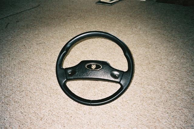

Originally Posted by sov211
finally the 1990 to 1992 cars used the same (excellent) steering wheel that was on the 1989 US XJS. Properly speaking, this is a Series III V12 wheel used on the Jaguar variant only, not on the Daimler which continued with the (awful) skinny Daimler wheel (which had a rim even thinner than on the pre 1990 Series III).
While looking for a nice Nardi wheel for my own Series III project I happened across a near mint 89 XJS wheel and snapped it up. You've been commenting on how great the XJS wheel is for so many years I decided to see for myself
I'd still like a Nardi but I'll have to admit that the feel of the XJS wheel is very nice.
