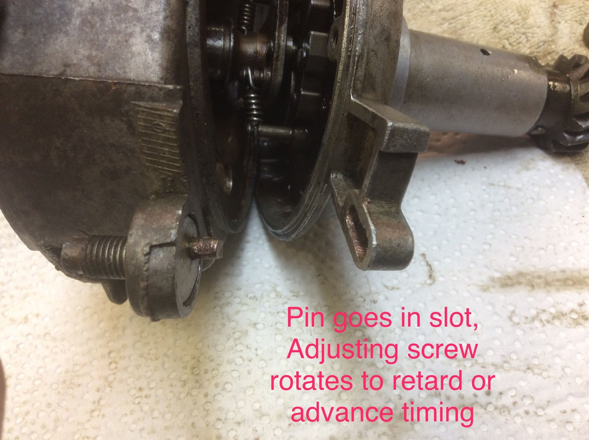

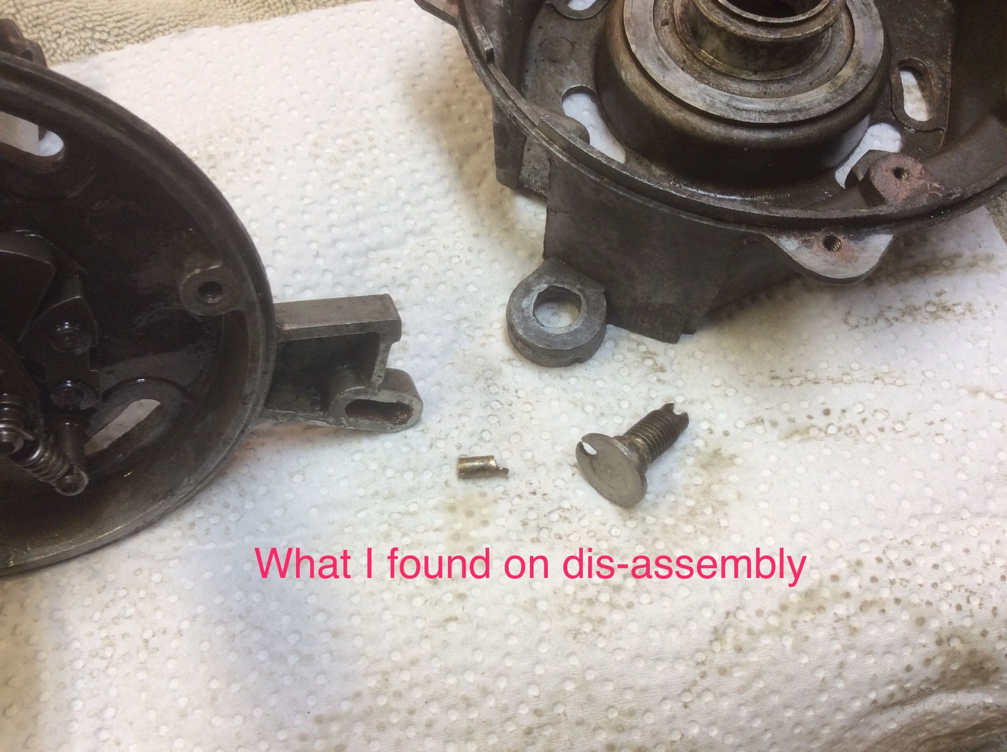

V-12 distributor woes
Don,
I dont have one, or it would be yours.
That is the same as all V12 engines up to late 1988, so maybe with that expanded model info you may find one.
Looks like someone tried to adjust the timing more than the limits of that thing, instead of loosening the lower screws to rotate the whole housing.
Good luck.

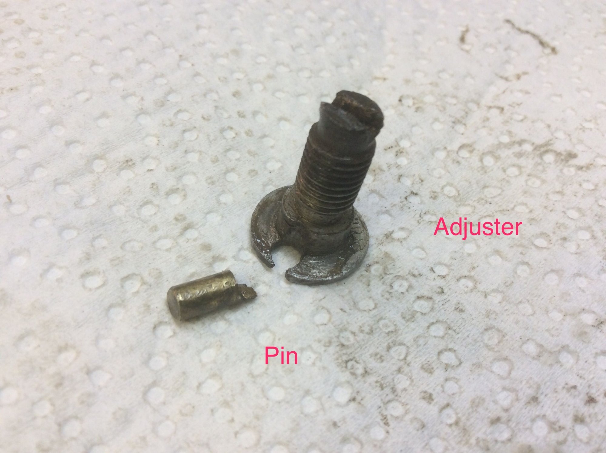

Too bad you are on the far side of our globe. Even with my very limited MIG "skills"',
I could tack the pin in place.
But, I'm sure a source for a minor weld is somewhere near you.

Thanks for the idea, Jagcad, the pin is brass so maybe brazing is the way to go?
I was thinking the softer brass could be squished, ( I think the term is "upset") like a rivet, but I only want to do this once.

Brass, interesting. Yes, but, maybe not. A skilled person could likely just add a touch of brass to secure the pin and not "melt" the piece. Brazing calls for melting the rod, but not the work. Merely just short of cherry red to accept the molten brass. Flux needed as a catalyst to make the bond.
On the other hand, I did pull something like that off decades ago. An early self propelled lawn mower used a machined piece of brass as a trunion for a shaft. Alas, it
wore off the top part and the shaft went adrift. With a huge mount of luck as a substitute for skill, I added enough brass to make the trunion whole. A big drill reamed it out to fit the shaft and I was back to mowing the grass.
But, In your case, I do have an idea. Brass accepts solder very well. In your case, load is not involved. Merely securing the load piece in place is the objective.
So, got to the plumber's skills in "sweating" copper pipe joints. Heat the part, apply the solder and let it flow into the joint.
Or pin it. Drill a small hole with the pin in place that intersects both. Ease in a pin that
fits snugly. Secure it by peening or better yet, old friend JB Weld.
