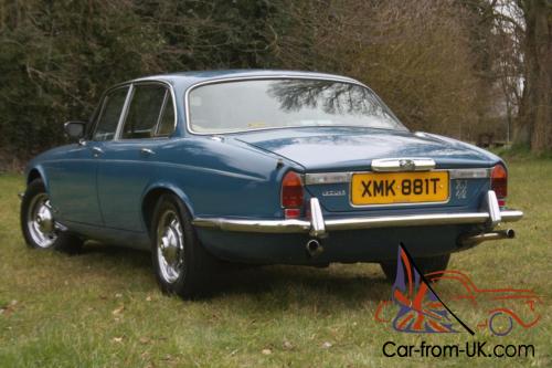

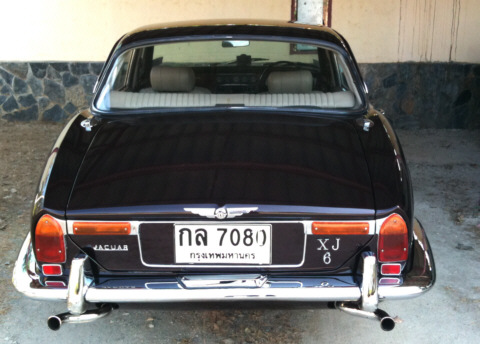

I know in our market the series I & II have the same tail light, the diffrence between the two is where the rego plate lights are mounted. Series I on the rear bumper, series two in the plinth on the boot.
