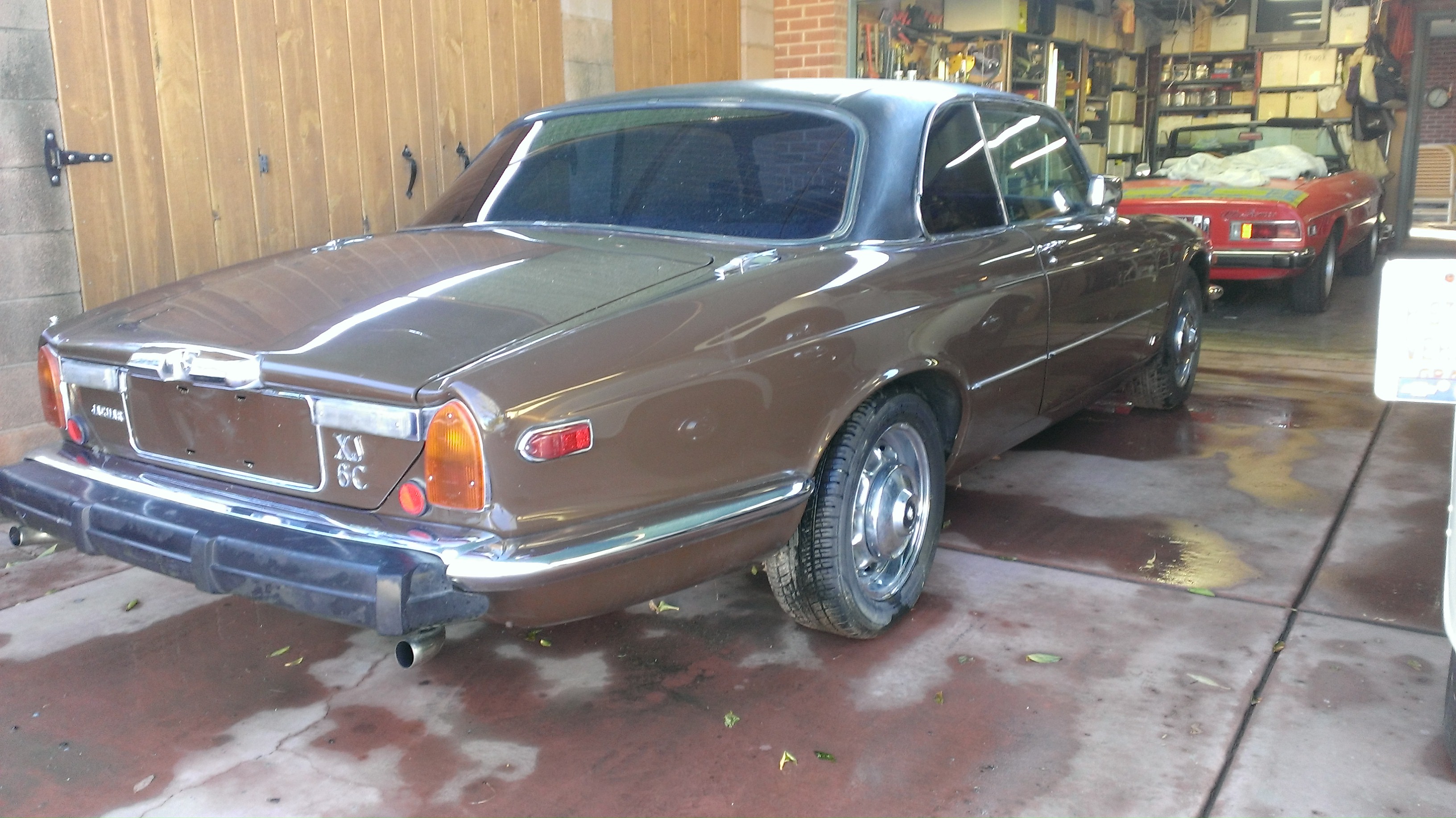

I am wondering if the water heated manifolds are necessaryfor the operation of my Jag 4.2 engine. I assume they were provided to helpwith cold weather starting and running. I live in Phoenix and rarely would haveneed for them. Of course, if I don'tfully understand their purpose, then I will put them back on.
With the talent and experience of the participants onthis forum, I have to believe there are many opinions.
1977 XJ6-C, withdown draft Webers
Thanks geneo
