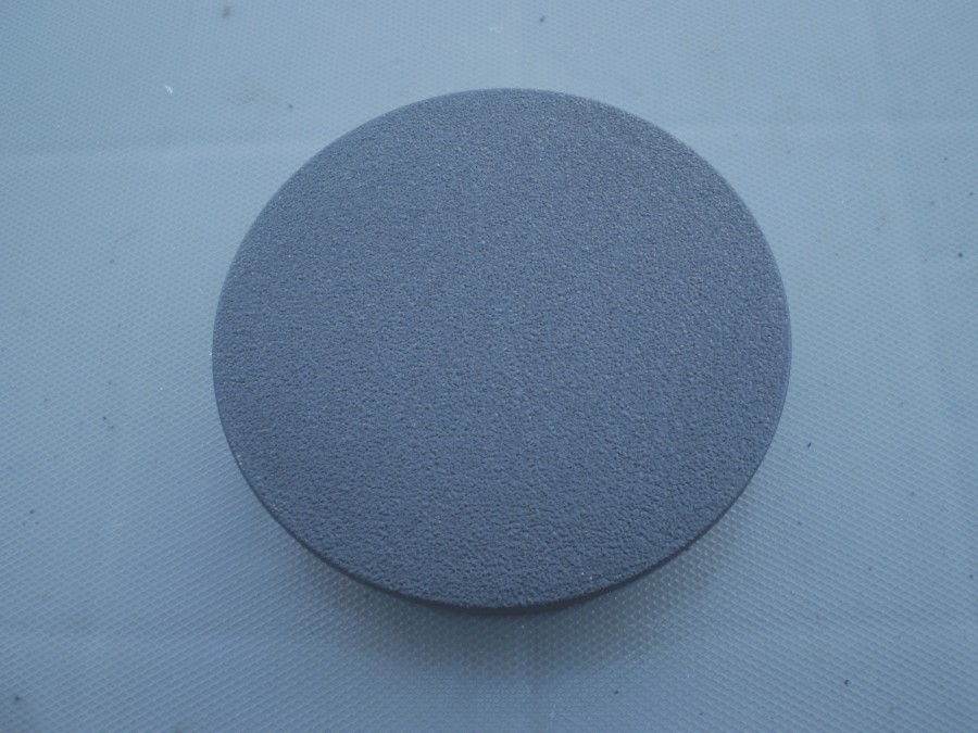

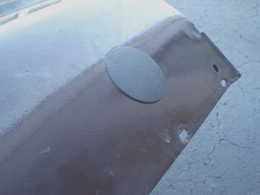

Regarding the impossible-to-remove-and-replace factory hole covers located at the bottom-inside of the quarter panels below the tanks, and which cover the Tank Drain Bolts, I decided to resolve the problem and now have OUTSIDE FITTING hole plugs which fit flush with the quarter panels and can be removed and refitted from outside the panels.
while testing the plugs I discovered that some cars have two hole sizes, and this is true in all the XJ Series from 1 to 3. Some cars have a larger hole, some have a smaller hole. Some cars have a mix of one smaller hole panel and one larger hole panel, if the panel has been replaced at some point.
the below pictures show the final mod and the outside fitting plugs.
If anyone is interested in a pair of these plugs, contact me via PM. I ordered 30 pair of these plugs, 15 in one size, 15 in the other. You need to measure both hole openings as accurately as possible.

please measure both holes, it's going to take either 2-1/4" inch (2.25") or 2½" inch
(2.50") plugs.
some cars might have one of each size as it happened with another car in California. (maybe one of the panels was replaced, I don't know).
my 1984 has 2½" holes on both panels.

Originally Posted by LnrB
!! I didn't even know those holes originally had plugs!!(';')
yes they all came with inside-mounted plugs that were glued with a little contact cement at the factory so they wouldn't move during installation of the panel;
the factory plugs were then kept in place by a piece of foam placed between the drain bolt head and the top rear of the plug, pressuring the plug against the panel hole.
when you wanted to drain the tanks, you had to pry up and push the plugs out of the way to get to the drain bolt head.
but once you pushed the plugs out of the way, you could not get them back in place unles you removed the bumper blade and the panel, so people gave up, too much hassle, and ended with an open hole where insects and rodents take residence, not to mention collecting water when driving in rain, causing the bottom of the tanks to start rusting and also creating mildew or mold inside the panel where any humidity remains.
