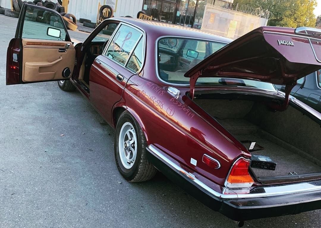

Hi everybody!
I bought my jaguar at the junkyard couple weeks ago.
Just changed water pump and then drove two-three days.

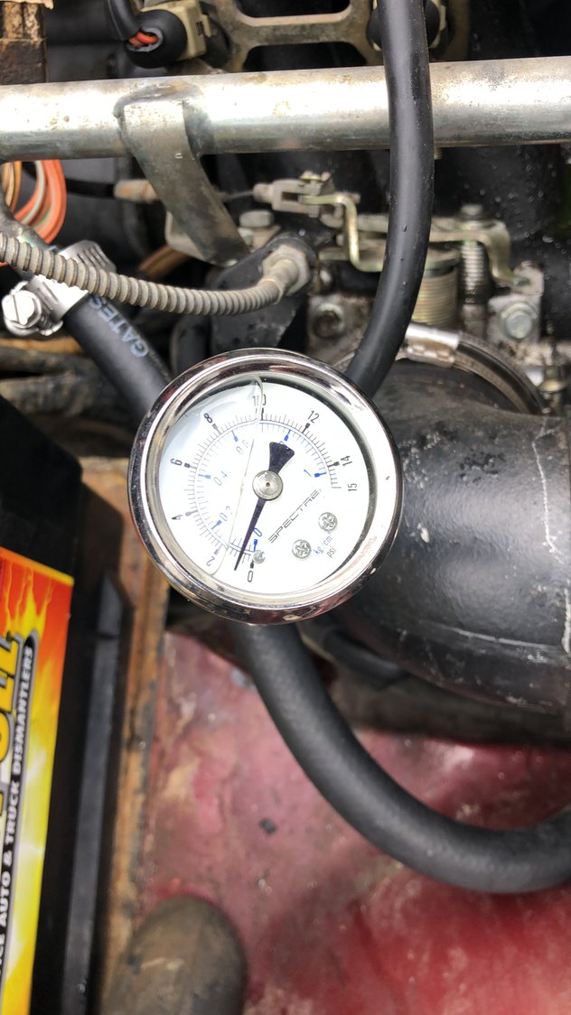

it was a couple of times that the engine sometimes stopped right while driving, but it was easy to start right away. On the third day of driving, the engine went out and did not start again until it was cold. gasoline is, there is a spark, candles are good. At the nozzle power checked, ok help find the cause. I started this morning on a cold one, five minutes later the engine went dead. If you work with the gas pedal, the engine starts and stalls.

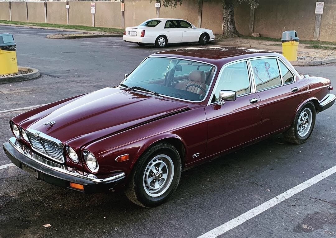

Hi,
that car looks very good, the problems are easy to fix.

Junkyard.....Jeeez...wish that level of car was in a junkyard here!

What a beauty! Congratulations.
It will be interesting to see how you get on with it – please keep us posted. And of course, we are here to help with any advice you may need.

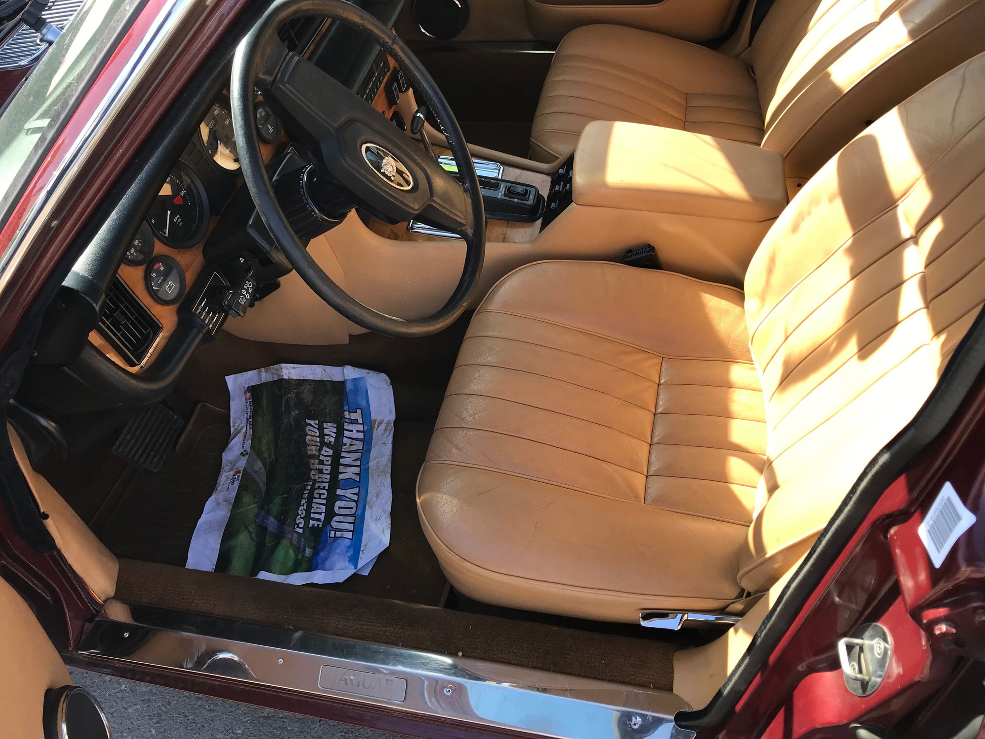

Congratulations, she's a beauty. That interior looks in better condition than a lot of XJ6's that sell for many thousands of $$ on eBay. This gives new meaning to the phrase, one man's trash is another man's treasure.

I did all this just now and started the engine, worked for two minutes and died out. Repeated startup attempts are useless. It seems that something is heating up and shutting down, until I understand what. What is the pressure to the fuel pump?

Nice pick up Leksvndr. Is that gauge in your pictures a fuel pressure gauge? If so your fuel pressure may be low. If you have the 4.2 litre motor the fuel pressure should be around
36 lb/squ in. If yours is lower than that you will need to check the fuel system. The tanks can have rust and sediment in them that can block fuel flow. There are also filters on the uptake pipes in the tanks that can need to be changed. Also the main fuel filter may be over due for changing. That's in the trunk on the back wall near the ecu. Next culprit could be the actual fuel pressure regulator on the front of the motor. Start checking these things and be methodical in your approach, it shouldn't take too long to fingers the problem. Of course there is also the fuel pump and associated switching gear. Get the Factory Service Manual as Jose says you are going to get a bit of use from it. Report back if you get stuck,

I changed the main filter, it is clean. Gasoline in the fuel rail is also clean, no rust. I'm going to replace the pressure gauge , because on the photo, the maximum value is very low.
need to figure out how to check the fuel regulator for performance
