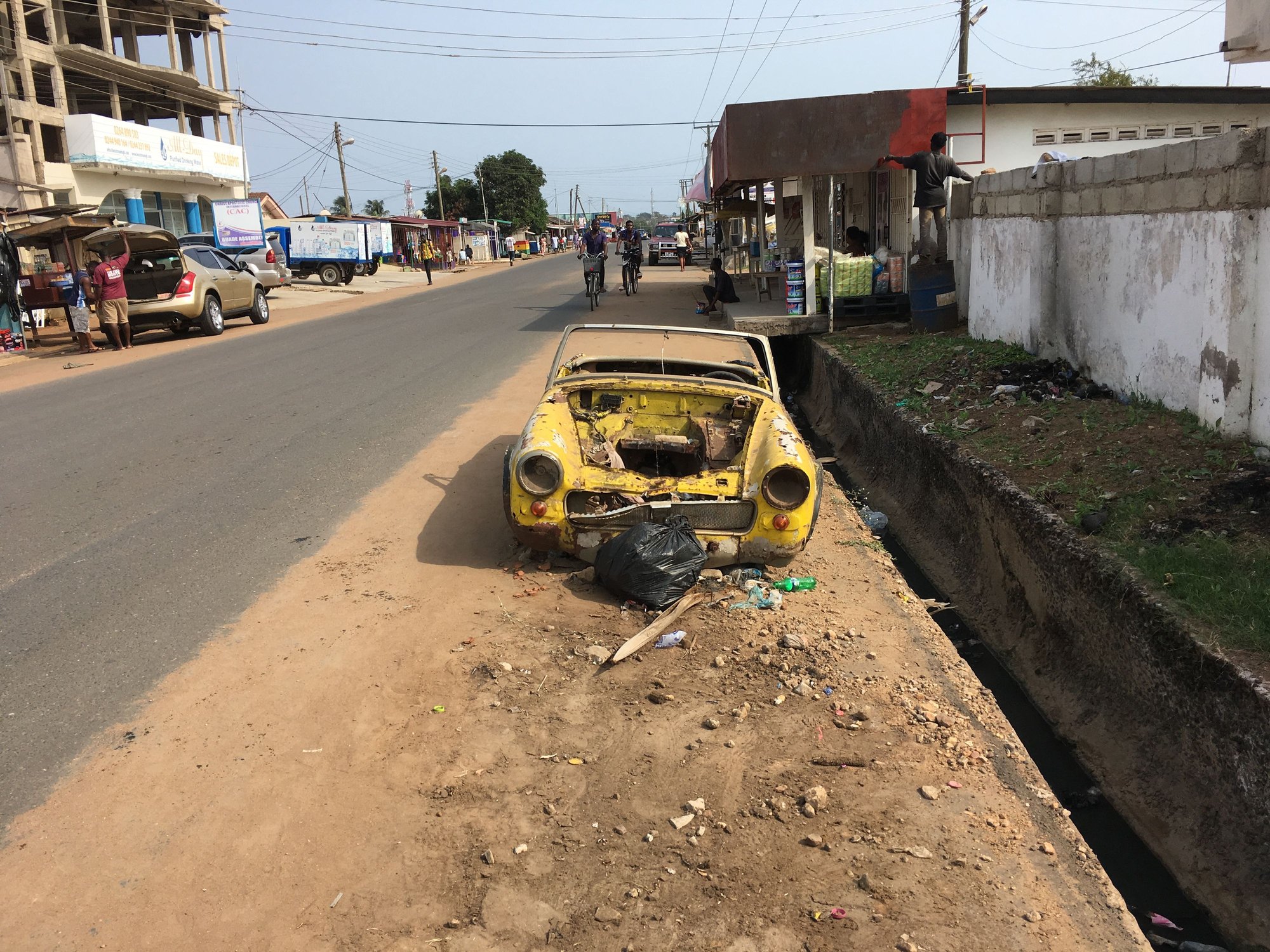

When I was in Accra I came across this old MG Midget, but thought it too far gone to save now:
[/QUOTE]
Ok, do you remember the part or area of Accra you the MG?
I would have make a move to that place to check if I could locate it.
Old Jul 25, 2020 | 07:20 AM
Andy T.'s Avatar
Joined: Jun 2019
Posts: 283
Likes: 265
From: Khon Kaen, Thailand
It is on Buade Road, area near the port by Tema
I have done some major car restorations in the past but this one looked too far gone even for my optimistic approach!
Take a look, you may think otherwise. It is parked right outside a colleague’s house and she could probably make contact with the owner

I just spoke to her and unfortunately she says the car was taken away by a scrap dealer some weeks ago

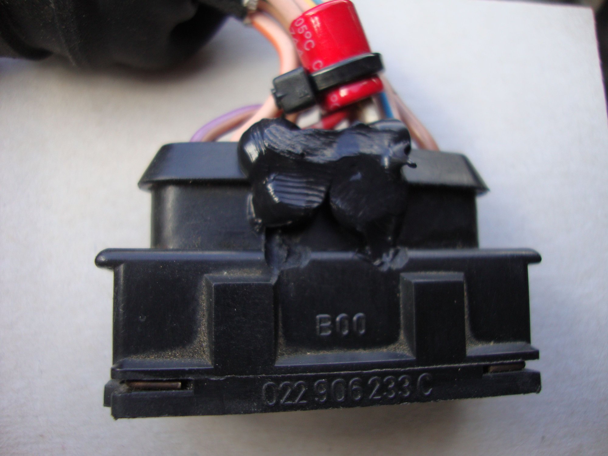

Check what I have done, hope I did the right thing.

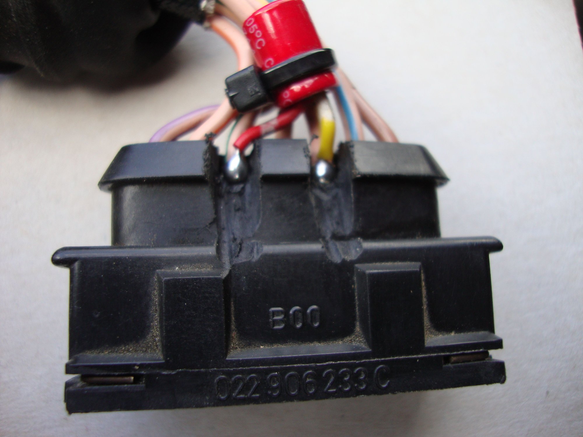

Dear Andy, I am very grateful for your postings and solution to the problem of rough running whilst cold.
I too had been trying to overcoming the problem and replaced spark plugs, HT leads, distributor cap, rotor arm, fuel filter, air filter, water temp sensor, and also had it kypton tuned. Then I saw that you had very similar symptoms and fitting a capacitor to the wiring of the AFM provided a cure. I decided to use a dremmell cutting disc and make two gaps just above where the cable connects to the metal conductor. I then insulated the two legs of the capacitor and soldered it directly to the tops of the conductors. Used a nylon cable tie to secure the cap to the cableform and finished off by applying black silicon over the exposed soldering. I have attached two images, I hope this method might assist members who also have to carry out this lovely modification.
Very best wishes, Danny.
Two cuts with dremmell per connection, insulated the capacitors legs, then secured to cables with nylon tie.
Black silicon applied before replacing rubber cover.

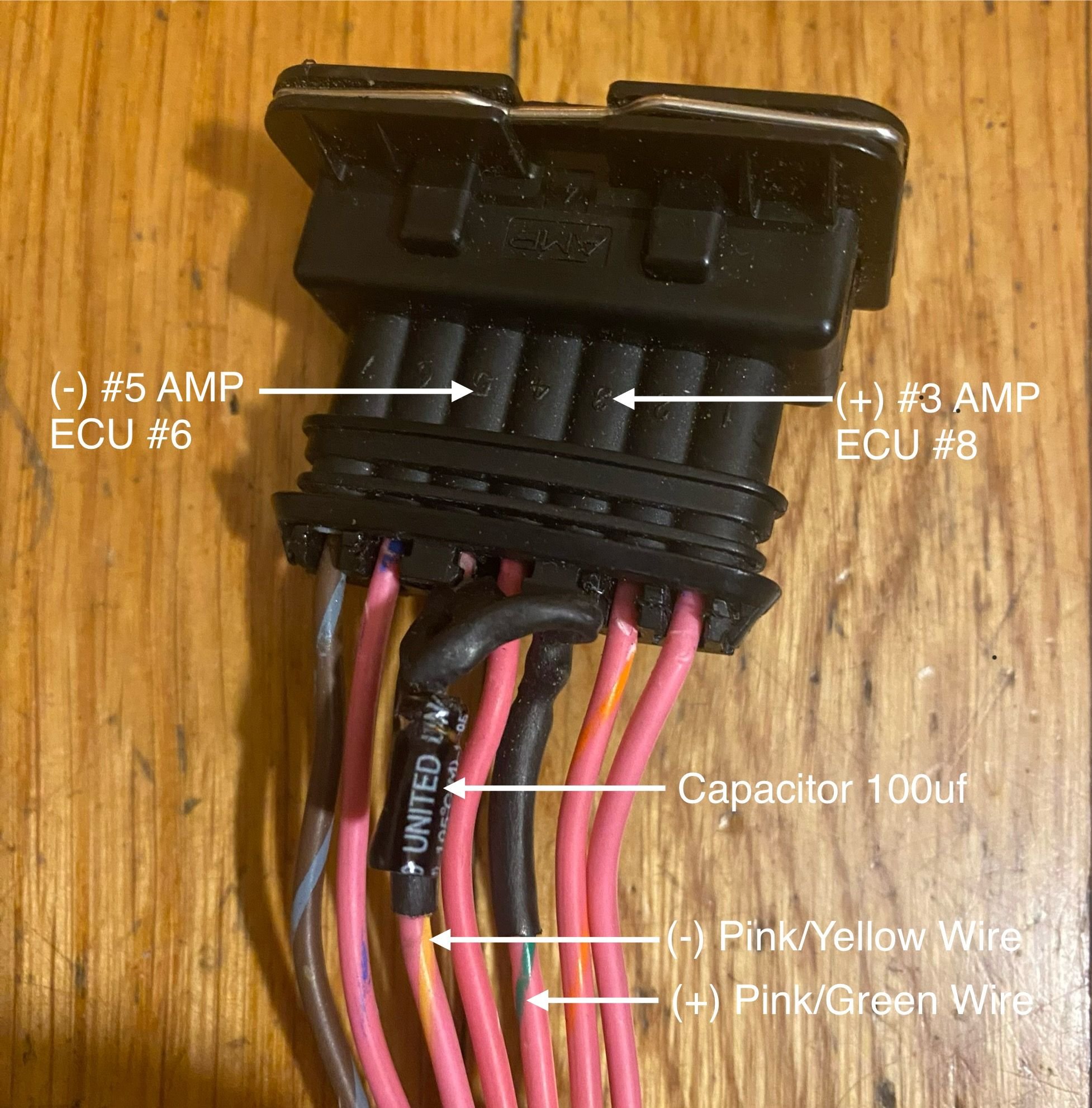

If using an AMP connector see attached photo
Capacitor Mod
