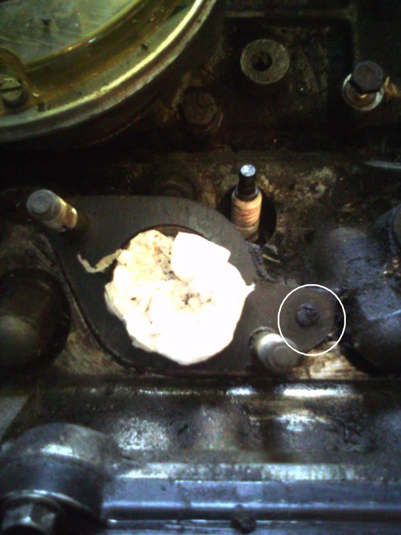

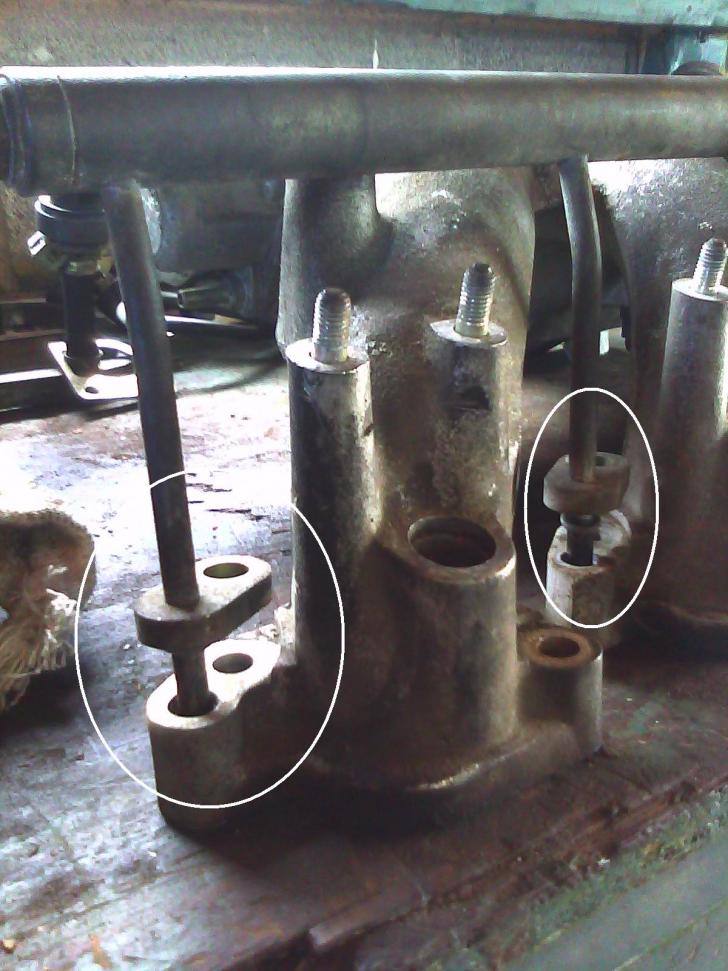

Since I am still waiting for a fuel pump I started pulling the intakes off so I can polish them and clean everything under them (it's pretty bad). I found the vacuum hose to the ECU
I'm just wondering what the piece is in the picture. The 'stems' pass through the intake flanges and into the head. When I removed the intake manifolds, those 'stems' were completely clogged with carbon and the holes into the head are as well. I cleaned the stems out but how can I clean out the holes in the heads without all that junk falling into the heads? And what are those for anyway? I don't see them in any manual or parts catalog.
. I'm just wondering what the piece is in the picture. The 'stems' pass through the intake flanges and into the head. When I removed the intake manifolds, those 'stems' were completely clogged with carbon and the holes into the head are as well. I cleaned the stems out but how can I clean out the holes in the heads without all that junk falling into the heads? And what are those for anyway? I don't see them in any manual or parts catalog.

You can remove those air injection tubes and the rest of their piping. They most likely so plugged with carbon that no air flows through them.
Tap the holes in the intake manifold a plug them with small bolts or screws.
After some more research, I've decided that I'll just take all that out along with the air pump.
