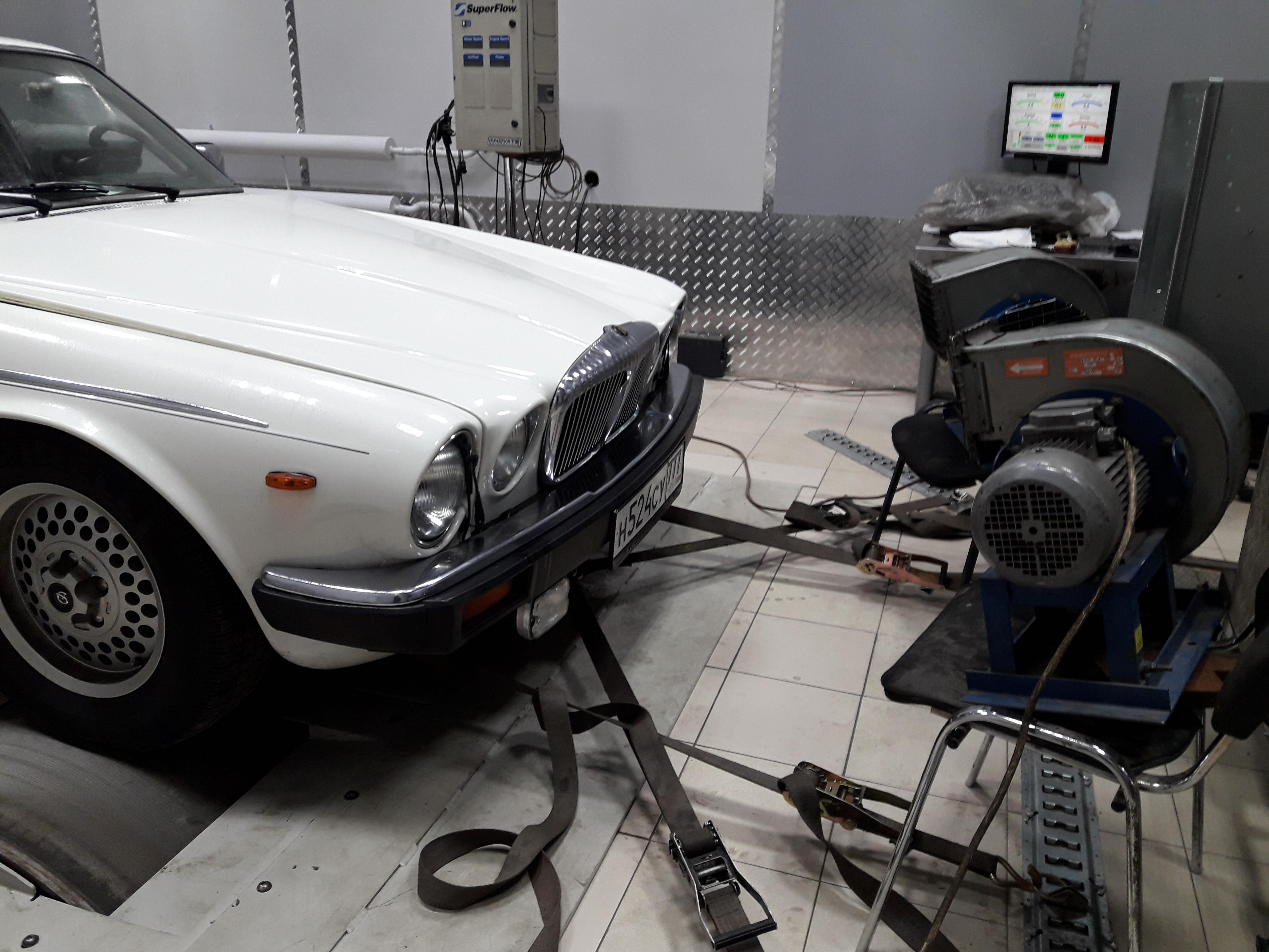

We did measure the power of DDS my friend. The car has a fully stock, the German specification, catalysts. The measurements were stopped at 4500 rpm due to the lean of the mixture. Fuel pump needs to be replaced. Cylinder head and intake manifold modified. Fully rounded off from the valve seat to plenium. The outlet port is aligned, flattened.
Is the HP at the wheels or corrected for engine? As the torque looks like its corrected for engine.
those are right on with the numbers I posted...
so I would think corrected for the engine.....
if not the engine would be about 302hp which would be 15% over the stock at that rpm

The graph said 262HP not kW and 382Nm which is why I questioned it
that torque curve shows an almost flat V12 curve,nice!
very typical for V12 engines, HP is somewhat disappointing tho.
yeah I know it is confusing until you go convert the Nm to Ft/lbs

I was wondering why they used SAE and Metric on one graph.
But more importantly 388Nm is 30Nm less than my car had stock.
he did state that one of the fuel pumps was bad... and the air/fuel ratio went out of range so they shut down...
