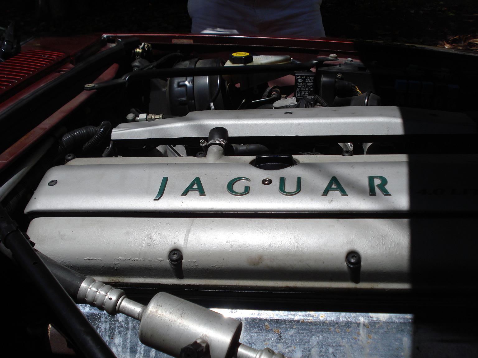

As soon as I got my new 1995 6-cylinder XJS coupe, I replaced the spark plugs and took pictures. I'm a novice mechanic, so I apologize for any mistakes or misinformation. Here's the procedure I followed:
  1. Open the hood and find the coil cover with the Jaguar logo
  2. Unscrew the three (3) Torx screws holding the coil cover in place. The Torx screws appeared to be larger than T40, the largest I have, so I'm guessing they're T45 or T50
  3. Remove the coil cover

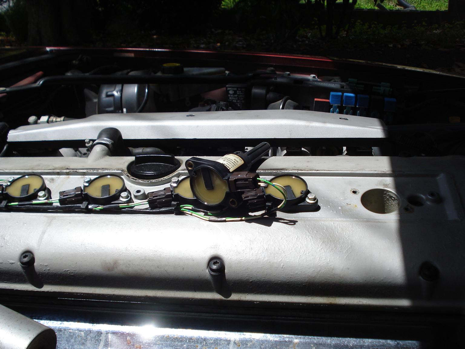

  4. The coils are held in place by two (2) 8 mm hexagonal bolts each. Remove these. I removed all six coils before replacing any of the spark plugs. The ignition wires must be unclipped from their clips before removal
  5. Pull out the coils. They should just unsnap from the spark plugs
  6. Using a spark plug socket with a socket wrench and extender, unscrew and remove each spark plug in turn
  7. Smear a thin coating of anti-seize compound on the threads of each new spark plug before installing and torquing down with a torque wrench to 21 lb-ft. I used Bosch Platinum spark plugs.
