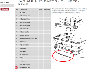

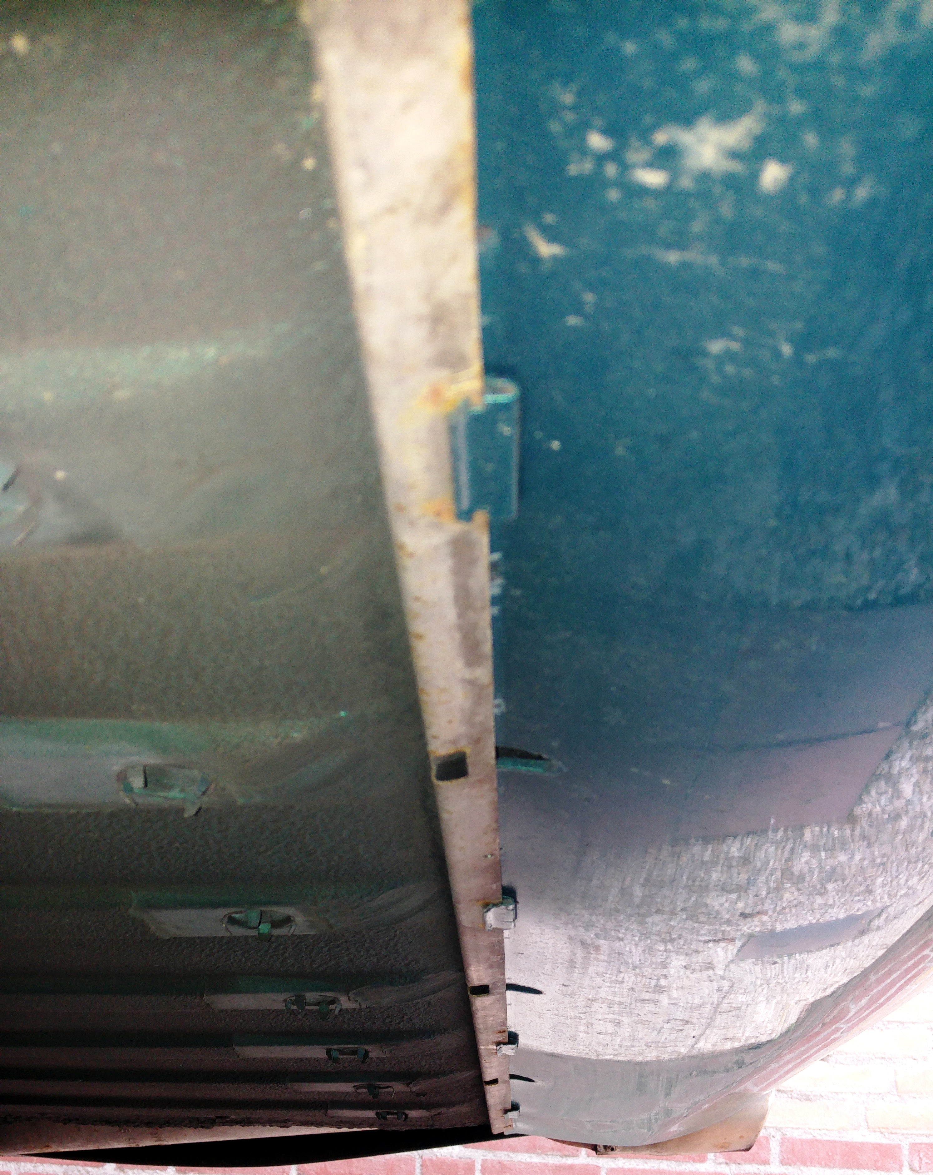

Old Apr 23, 2018 | 10:53 AM
Keesh's Avatar
Joined: Jan 2009
Posts: 379
Likes: 217
From: The Netherlands
Attached Thumbnails 1995 XJS facelift rear bumper attachement question.-naamloos.png   1995 XJS facelift rear bumper attachement question.-20180423_174428.jpg
Old Apr 23, 2018 | 12:20 PM
Jagsandmgs's Avatar
Joined: Mar 2017
Posts: 699
Likes: 415
From: Jaffrey, NH
Mine all fell out too. Look at the photo of the long metal strip in the post above... there are some holes in it. I ended up drilling small holes the cover itself to match and zip tying it to those holes. Been like that for over 50000 miles with no ill effect. It’s so far under the car nobody will notice.
