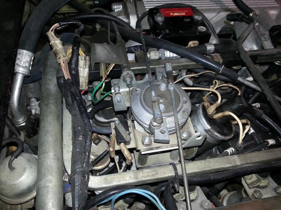

on this last one, more of a curiosity than anything...the two green wires near the throttle have never been connected to anything, yet there are clearly 2 places for them to connect to. could somebody possibly help me identify these wires? the come off the ignition amp.
i labeled all the wires as i was disconnecting it, of course and plugged the vacuum hoses back in. unfortunately no change. i plan to test each plug and associated wire when my assistant (wife) gets back from her business trip.

I have read through this a couple of times now, still with no hard and fast explanation of what could be happening.
I’m going go out on a limb here, just from what has being said and done so far and the pics you posted. Back to basics

Those 2 hoses on the side and cap of the distributor, are NOT vac hoses, They are purely distributor vnting hoses. One end is open to the atmosphere with a small plastic filter shoved in its end. The other end is in the "draught" section of the AAV hose that travels from the rear of the RH air cleaner backing to the AAV inlet.
Refit that cap, refit the plug leads in thr correct order, and grab an old spark plug, any will do, and insert it in the end on the easiest lead to get at, and sit the side of it on the cylinder head, and crank the thing over. Do you have spark AT the spark plugs, and a good fat Blue one at that.
The fact you have spark AT the coil lead going into the cap indicates that the amp/coil. etc is all doing what it should.
