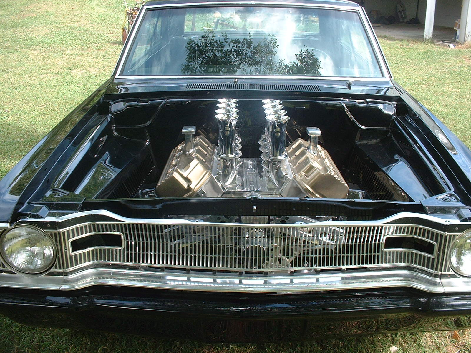

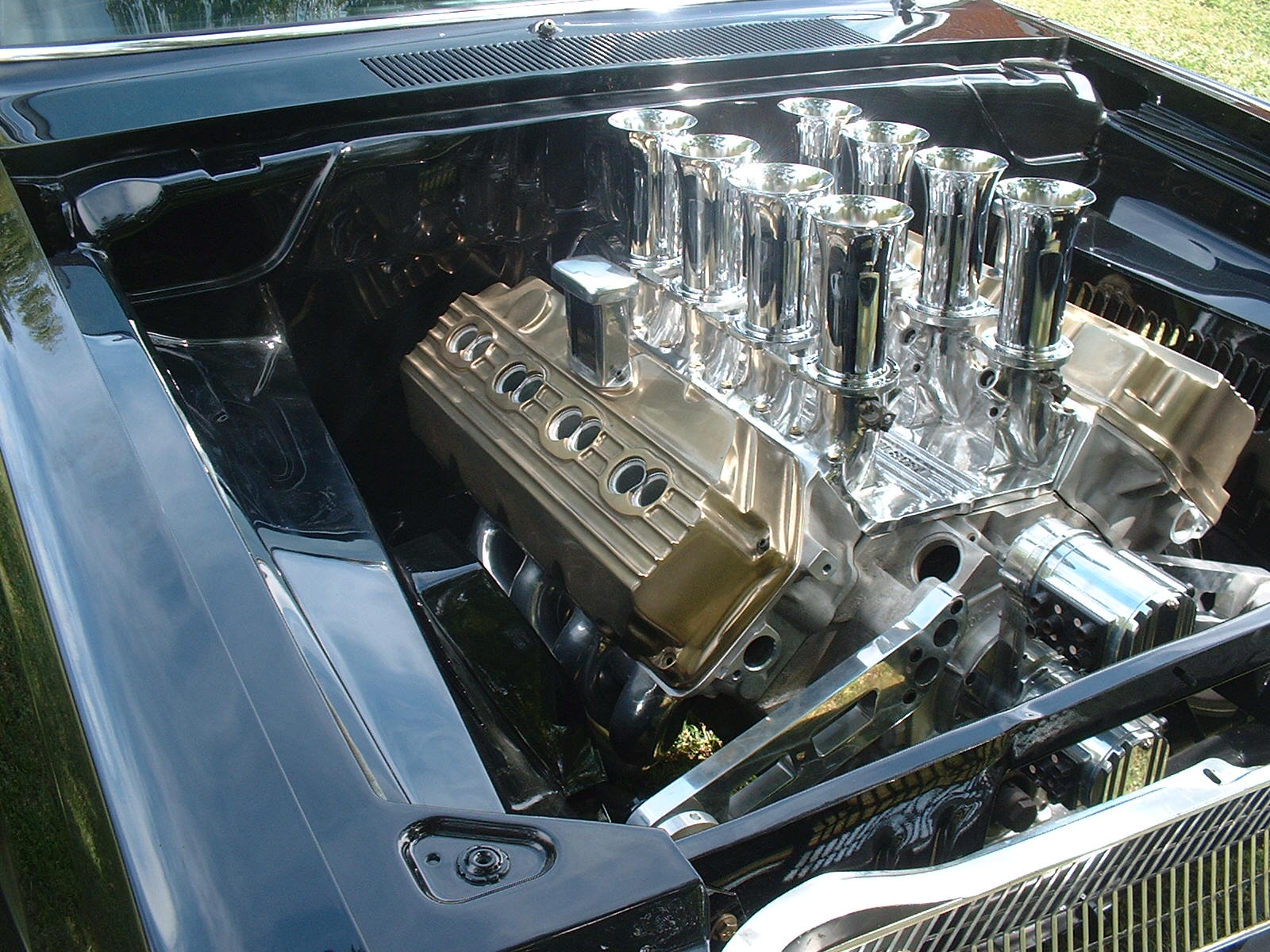

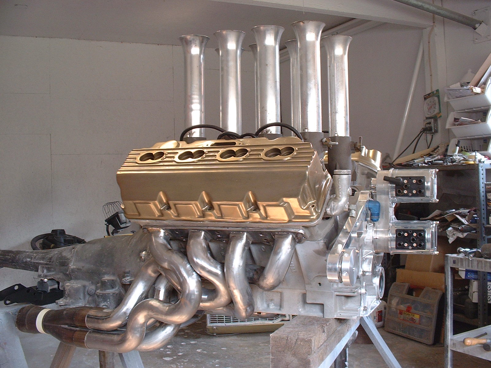

Have a look at the throttle bodies sitting on some Weber EFI plates I made a while back to use injectors under the 48mm carbs.
These are the same height as the intakes will be so you get the idea of how this will look with the short stacks for an under-hood system.
We'll add extensions for the truck, or not, when he figures out where the body will sit on the chassis in relation to the engine.
Also a few shots of the '67 Hemi Dart I'm building so you get what I mean about relocating or tossing stuff.
With a little coaching you can make it a stunning machine, as you're already heading that direction.

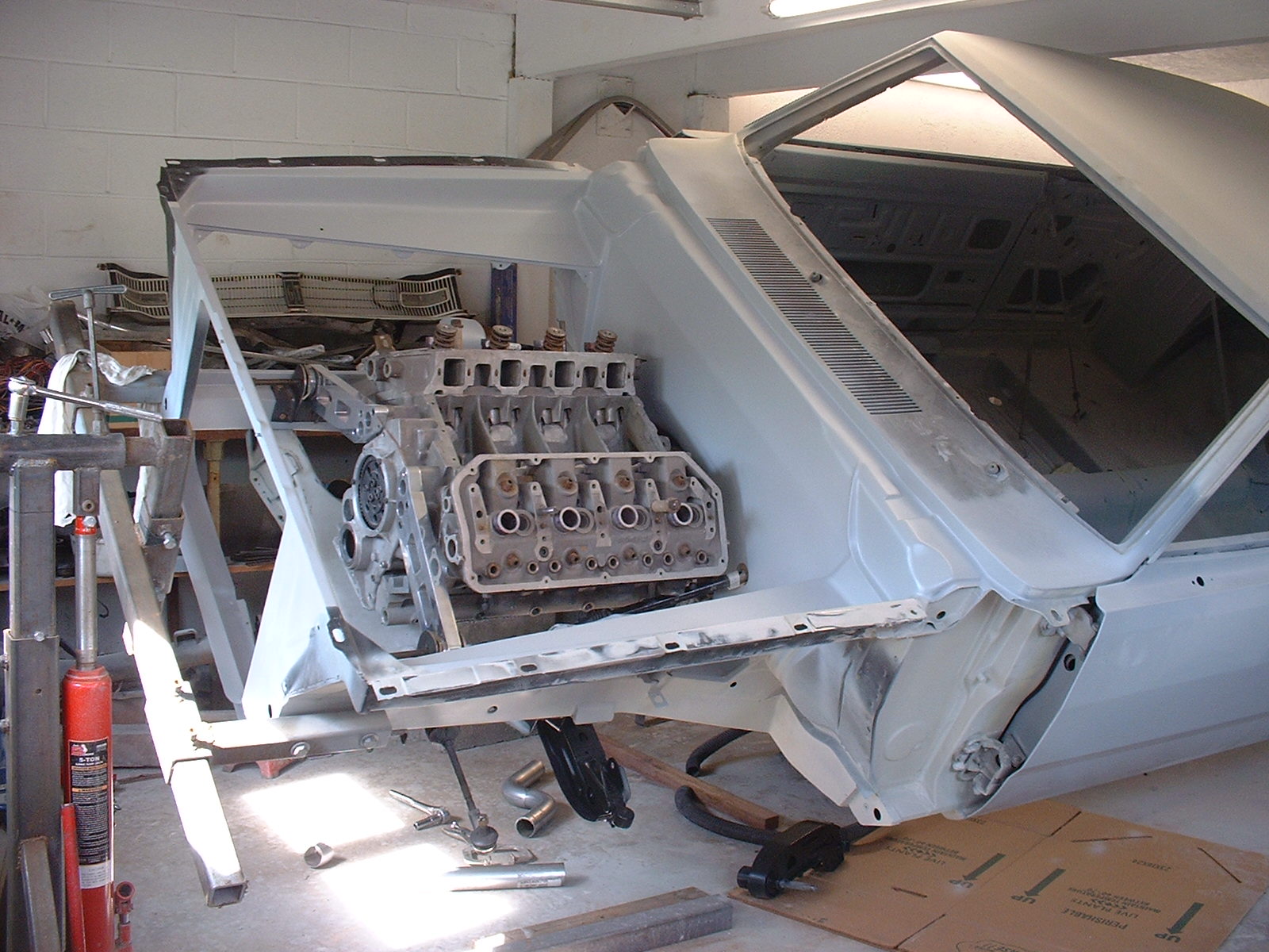

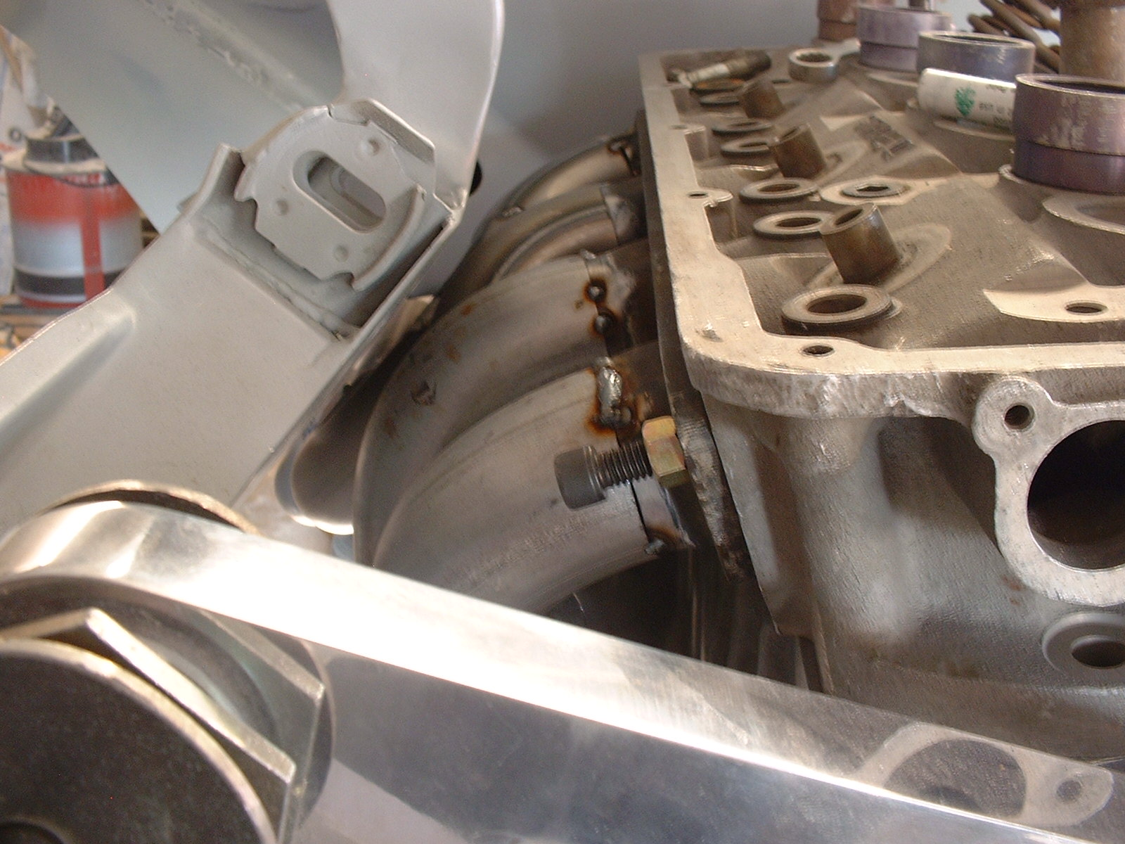

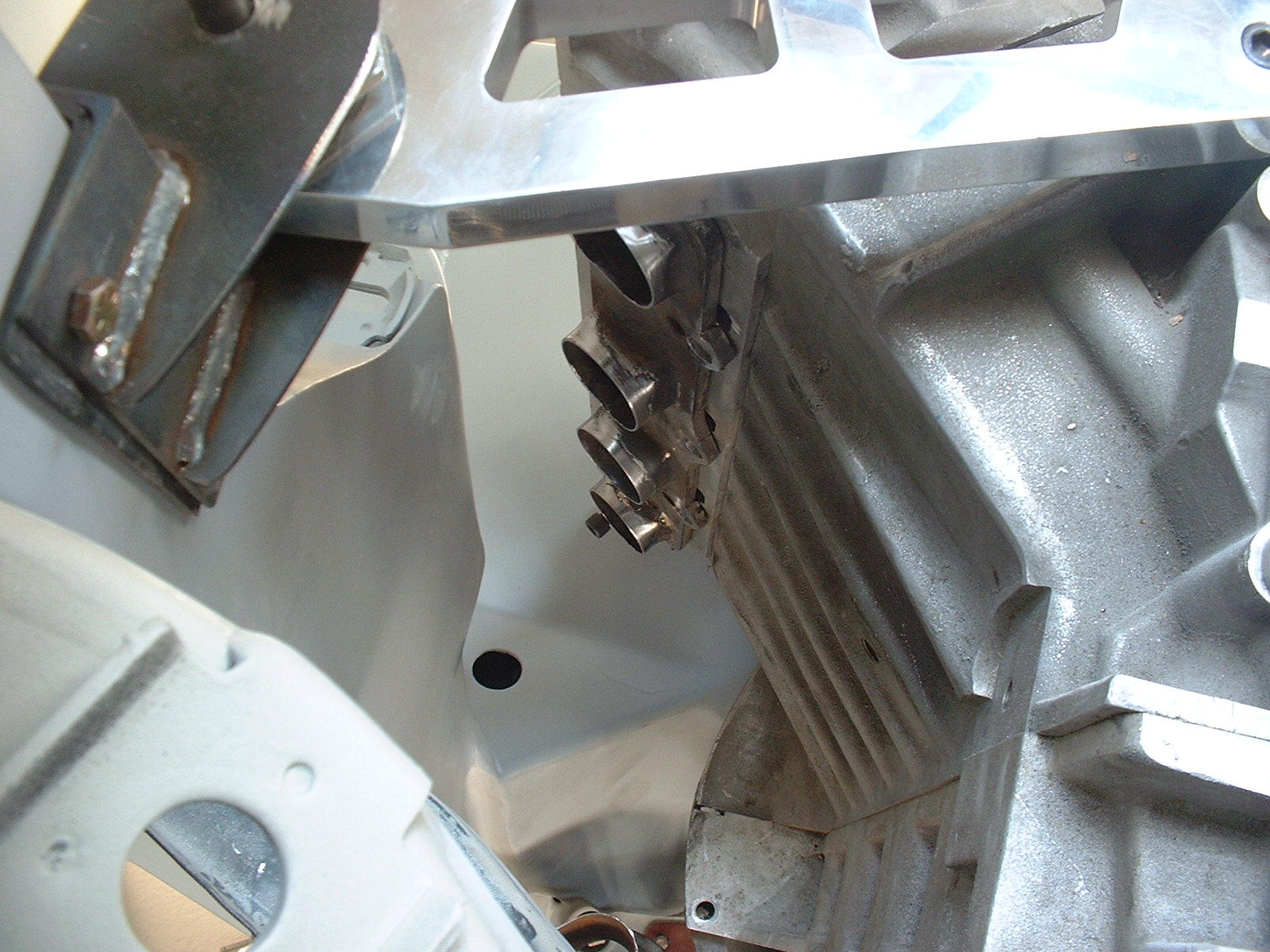

Here are just a couple of the pics of the header build on the Dart.
It was engineered to have them not hanging under the car.
Everyone else does it that way as it's easier.
But with the body mods it wasn't that hard.
It was less tight than stock and I had room to make the right bends work.
I really wouldn't want to make them for the XJS unless I was building the car, as I'd probably make some good changes in the car itself to do it so they could work better, and come out easy.
