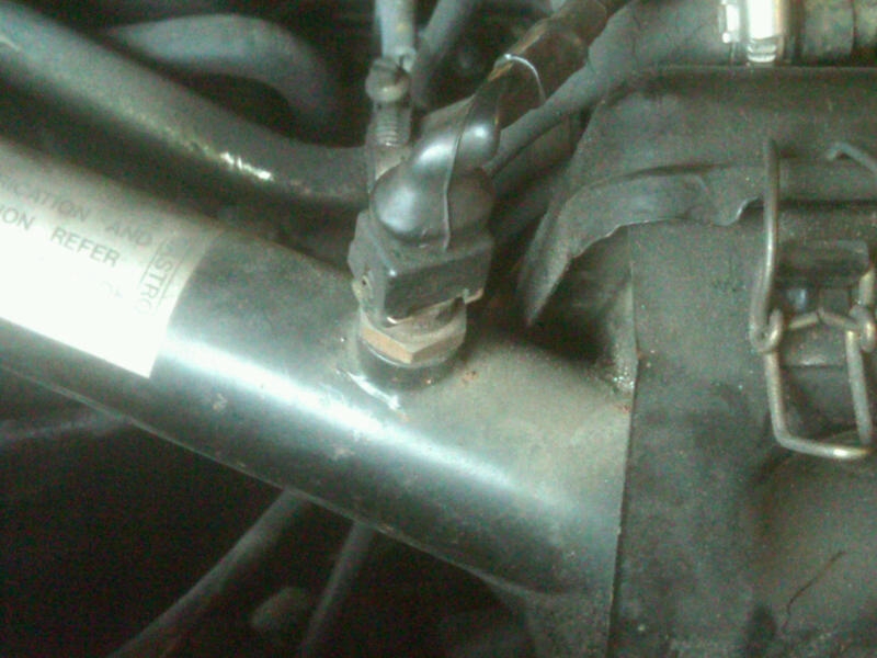

Go check the connection on the Intake Air Temperature Sensor on the LH (US Driver's side) air filter housing tube...

Dave, is the attached photo the sensor you are talking about? If so, are their particular tests I can do with it?

BTW, yes, your picture does show the Air Temp Sensor. This is basically for fuel mixture "trimming" according to air temp.
Dave may have additional input regarding this sensor but I'd focus on the "no spark" situation first.

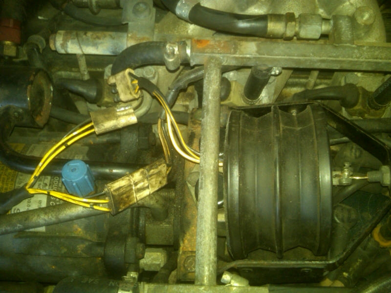

One photo is from under the hood. The bellows device has three wires coming out of it, and you can see they were not attached to their respective connector. I attached them, but didn't notice that anything in particular changed. What does this bellows device do?

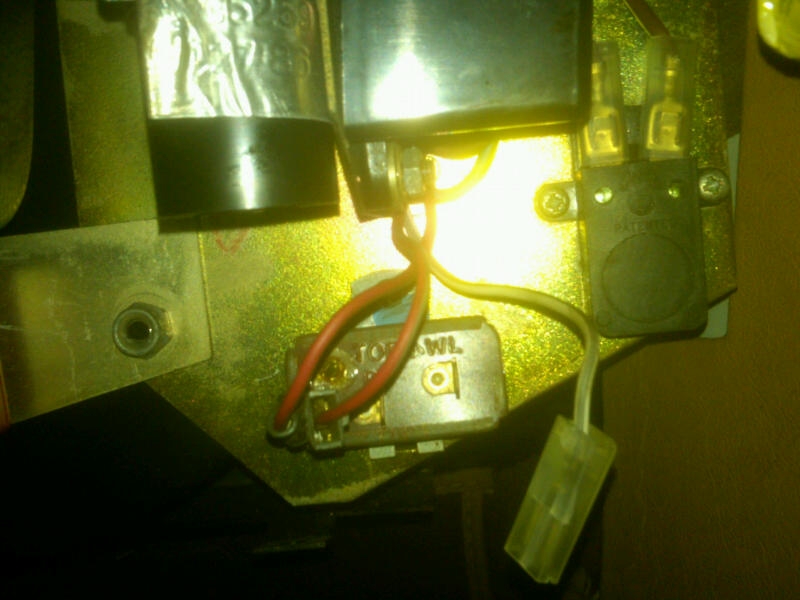

The other photo is from under the passenger (right) side dashboard. There are three wires that lead to this relay. Two of the wires are clipped together and are then clipped into the far left lug of the relay. The relay has two other lugs, labeled "B" (near the center) and "WL" (to the right). I would suspect that the loose wire clips to one of these lugs, but don't know which, or what this relay controls.

That's the cruise control bellows in the center of the engine.
The widget under the dash with one wire unplugged looks like a "bulb failure unit"
FTR, the squarish part to the right is a circuit breaker....probably for the power windows
