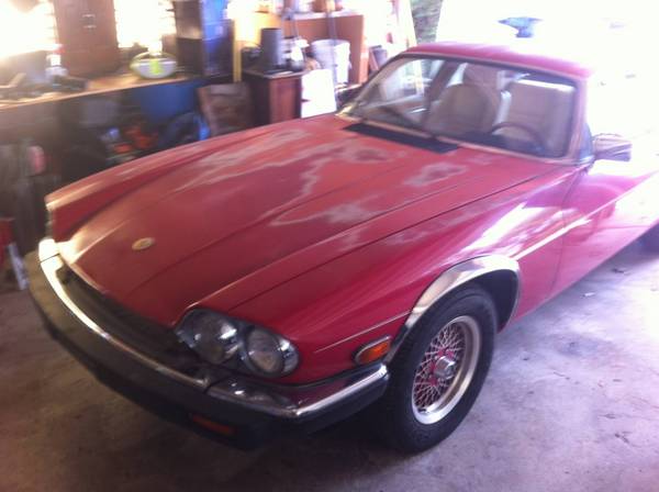

Here it is, everything is there but the grill:

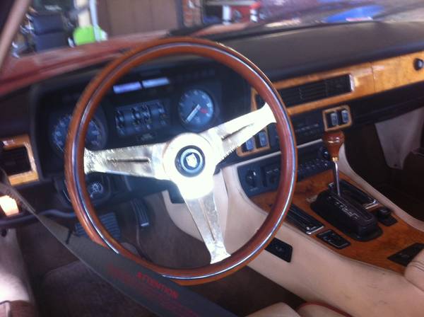

nice nardi steering wheel, Mustang.
were you thinking of keeping the lattice wheels red? might influence the choice of red accents you go with.
Old Feb 3, 2013 | 07:30 PM
MustangO4's Avatar
Joined: Feb 2013
Posts: 16
From: California
Yes, either red or white. But I will repaint them to match either way.

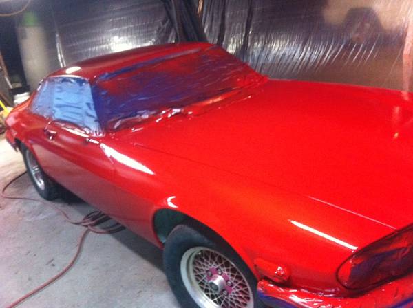

Well, got the sanding finished and the first paint coats down. Tomorrow I sand and do the final coats. Decided to stick with red, just a brighter, "safety red"
The color is good, but it will take a lot of sanding and polish to get it nice. I cleaned it meticulously, and sure enough when I was on the trunk, out of nowhere a bunch of leaf bits blasted out of a crack when the sprayer hit and it settled over alll the wet paint !!!! So, basically had to wipe off the paint and try again. Tomorrow's sanding should show if it worked or not.......

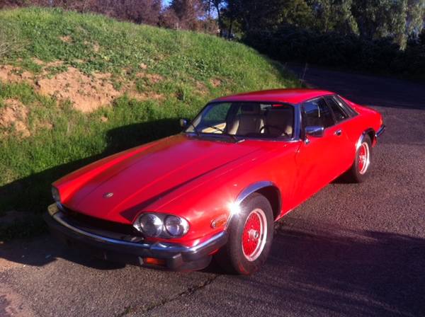

Ok, it's done with me for now. Now it is time to list it for sale...
(Still polishing out the rims)
