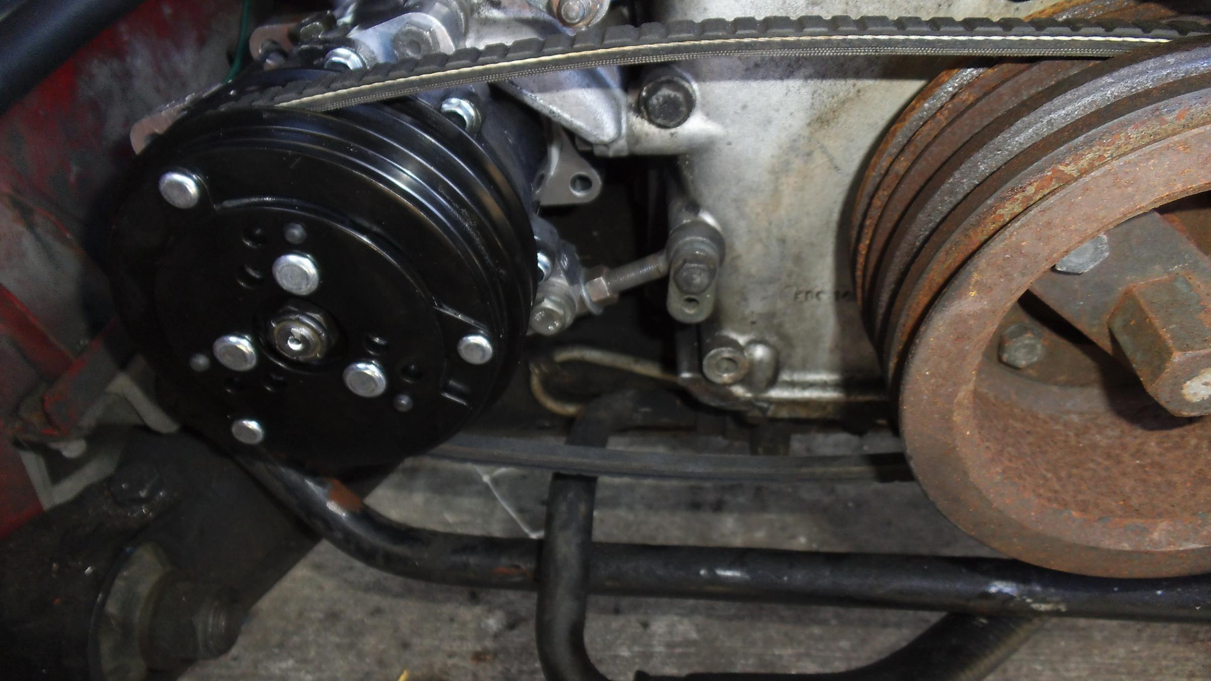

Replaced all ac components with a modern and more efficient unit. Purchased ac kit from coldmaster, tampa, Florida. Sanden sd508 compressor, evaporator, condenser, and all the hoses and fittings for $477.00. Compressor mounted where alternator was, alternator relocated to old ac location.
Attached Thumbnails ac replacement-dscf0144.jpg   ac replacement-dscf0150.jpg   ac replacement-%24_57.jpg

hey there... some questions:
- are the compressor and alternator on 2 separate belts? are any other components running off those belts, like the fan?
- did you do the in-dash evaporator replacement yourself? how long did that take?
Old Jan 13, 2014 | 07:06 PM
Hep320's Avatar
Joined: Mar 2012
Posts: 52
Likes: 17
From: Fort myers florida
Default ac
separate belts, now have 3 belts. yes i did the evaporator, just modified from front exit to top,

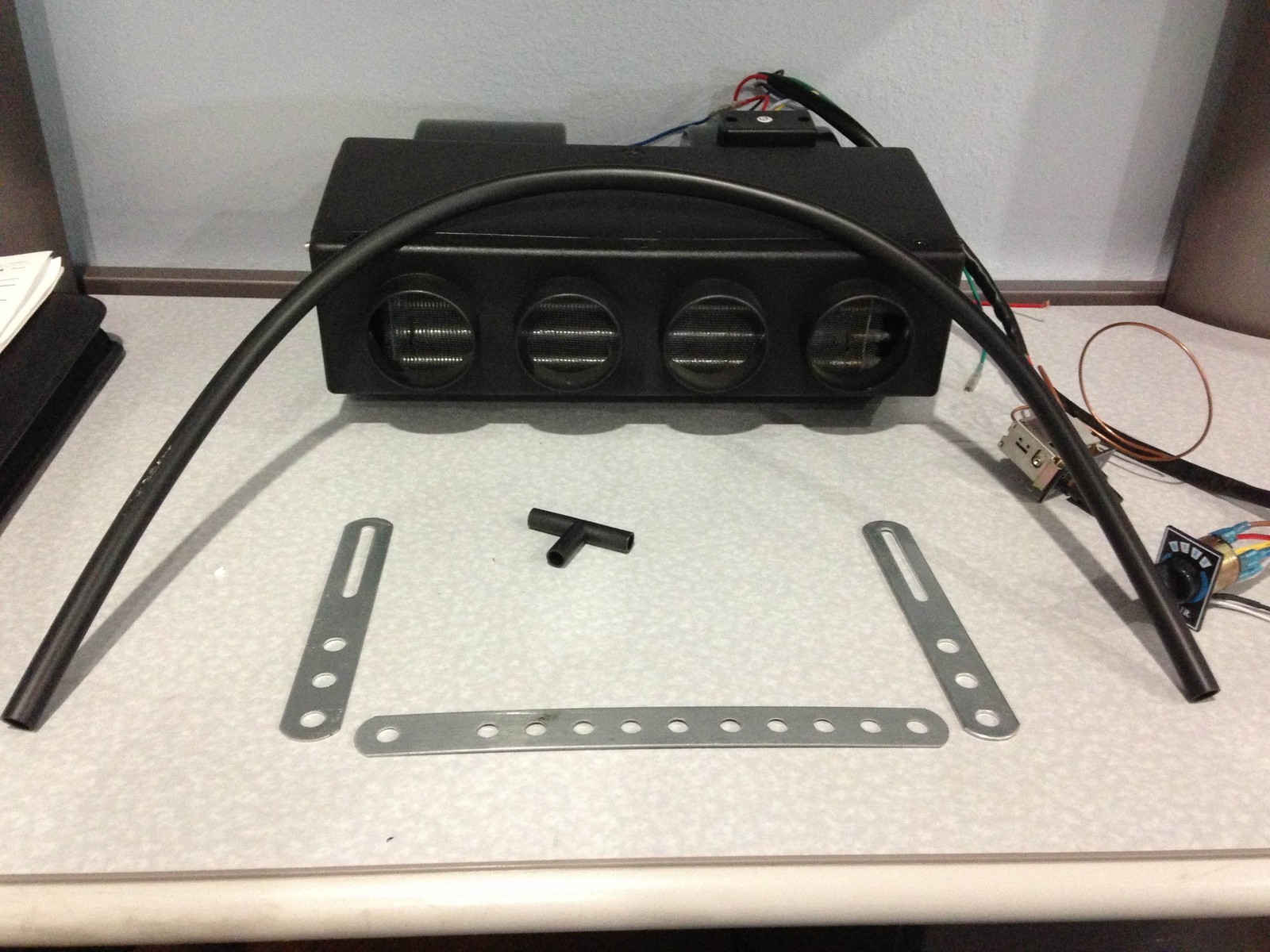

Default Evaporator
Warren,
Thanks, the new evaporator is so much stronger than the old. The fans are in the back so its a very short run to the vents. The evaporator came with the kit from ColdMaster. Here are some pictures of the unit previous to modifying the hose manifolds to the top. I will take some pictures on the instalation today.
Attached Thumbnails ac replacement-%24-kgrhqf-o0fhgby-br9s-qsey-%7E%7E60_57.jpg   ac replacement-%24t2ec16fhjhqe9nzeygpnbrscglrbpg%7E%7E60_57.jpg   ac replacement-%24-kgrhqfhjc8fff2qm-smbrscg-wbuq%7E%7E60_57.jpg   ac replacement-%24t2ec16vhjf8e9nnc7o-bbrschg79pg%7E%7E60_57.jpg
