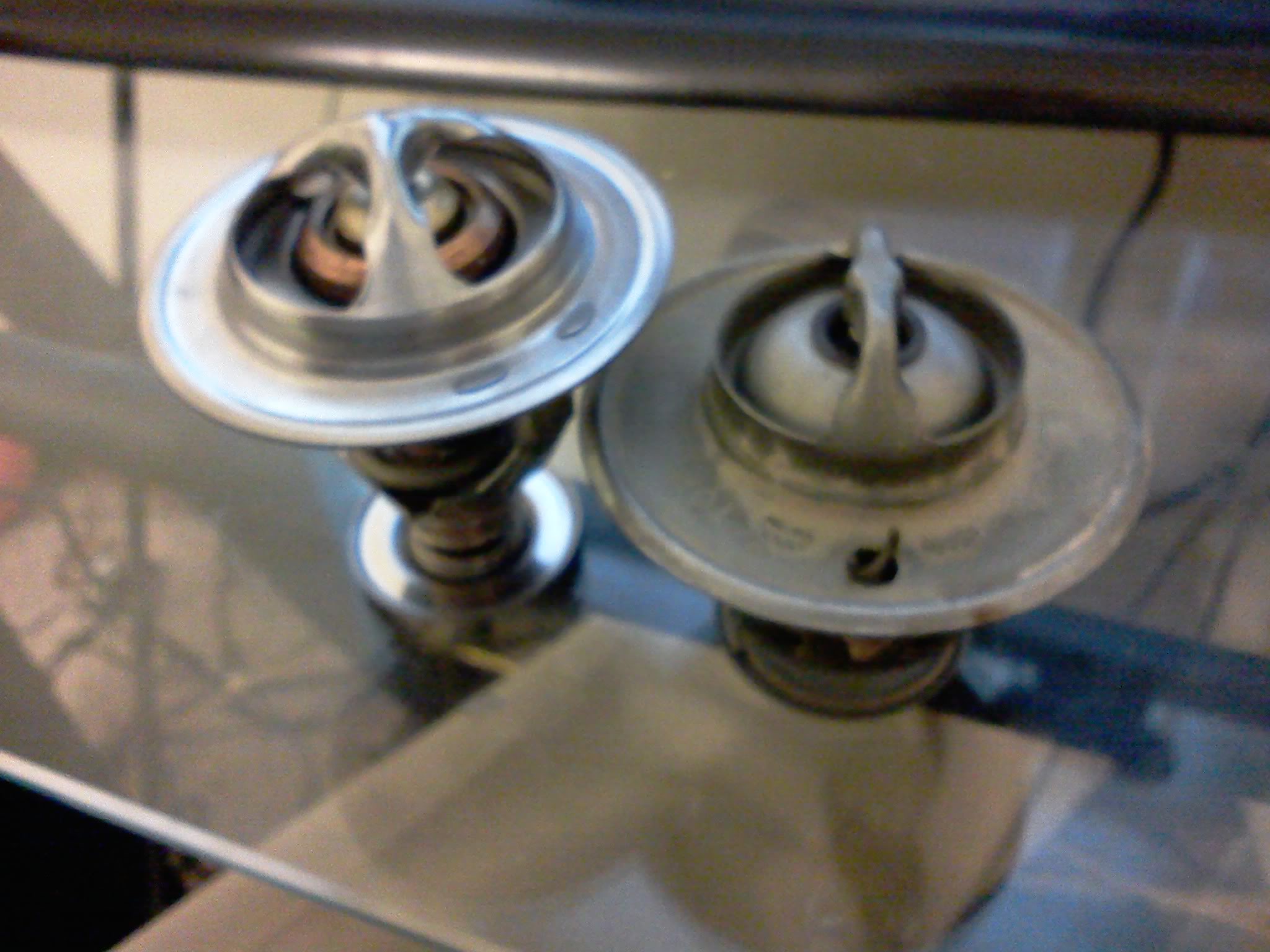

okay SO.
I haven't checked to fit but i was about to measure the length of the new thermostat just to post it...its pretty different.
the new one is 59mm long.
The diamter is like 53.9mm on the old one and this one is 46.9!!!
what gives?? this is a duralast brand part bought at AutoZone listed to fit an 88 Jaguar XJS v12.
I still wanna go put it in and see what it feels like but its completely different from the old one.
the new one has alot more copper on it but the spring tension is also way higher. Cldnt hurt to test it right?

AHA, now that is what I had with mine, the stats are TOO SHORT (old ones I mean), and that will NEVER close those by-pass ports.
The new one will by the look of that one.
The measuring of length etc is done by measuring from the "larger" flange, to the smaller flange/disc at the bottom. Basically the distance between the 2 flanges/discs.
The "top hat" section "above" that large flange is of little importance in our application.

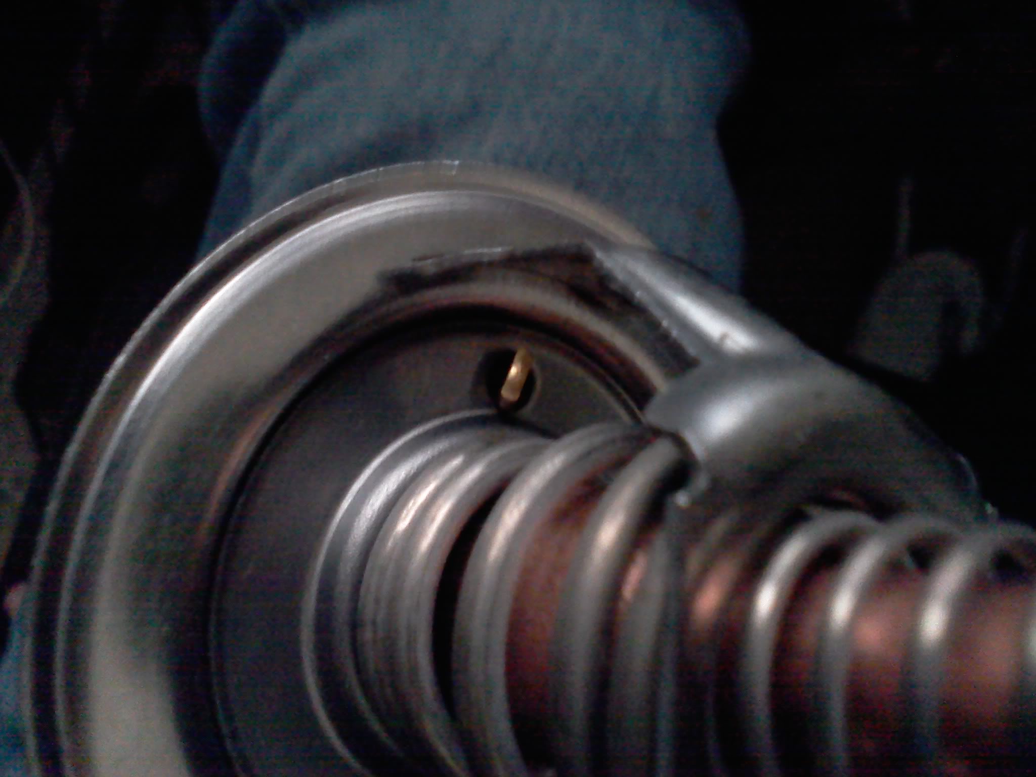

So i guess thats GOOD, what about the diameter being different. im probably gonna go stick it in before someone else responds but im rly wondering.
ALSO you can't see it in that pic but the new thermostat DOES have a hole in it with a pin but its on the inside not the outside edge.

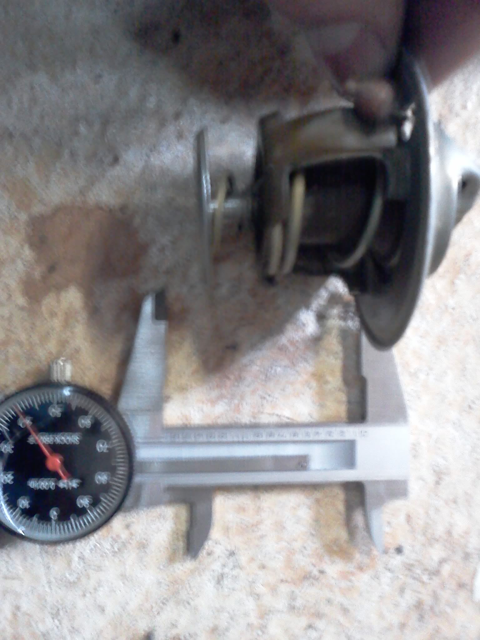

okay so some more stuff on the thermostats
the jaguar one is DEFINITELY too short and doesn't do anything, I would guess because of the reduced pressure compared to the open end probably 60% or more of coolant goes right back into the engine. IF this is seriously what every jaguar V12 had in it then THIS is why they are known for running hot.
I have it set to the Depth of the thermostat housing and here is the Jag thermostat next to it.
Here is the aftermarket one, it is the perfect length

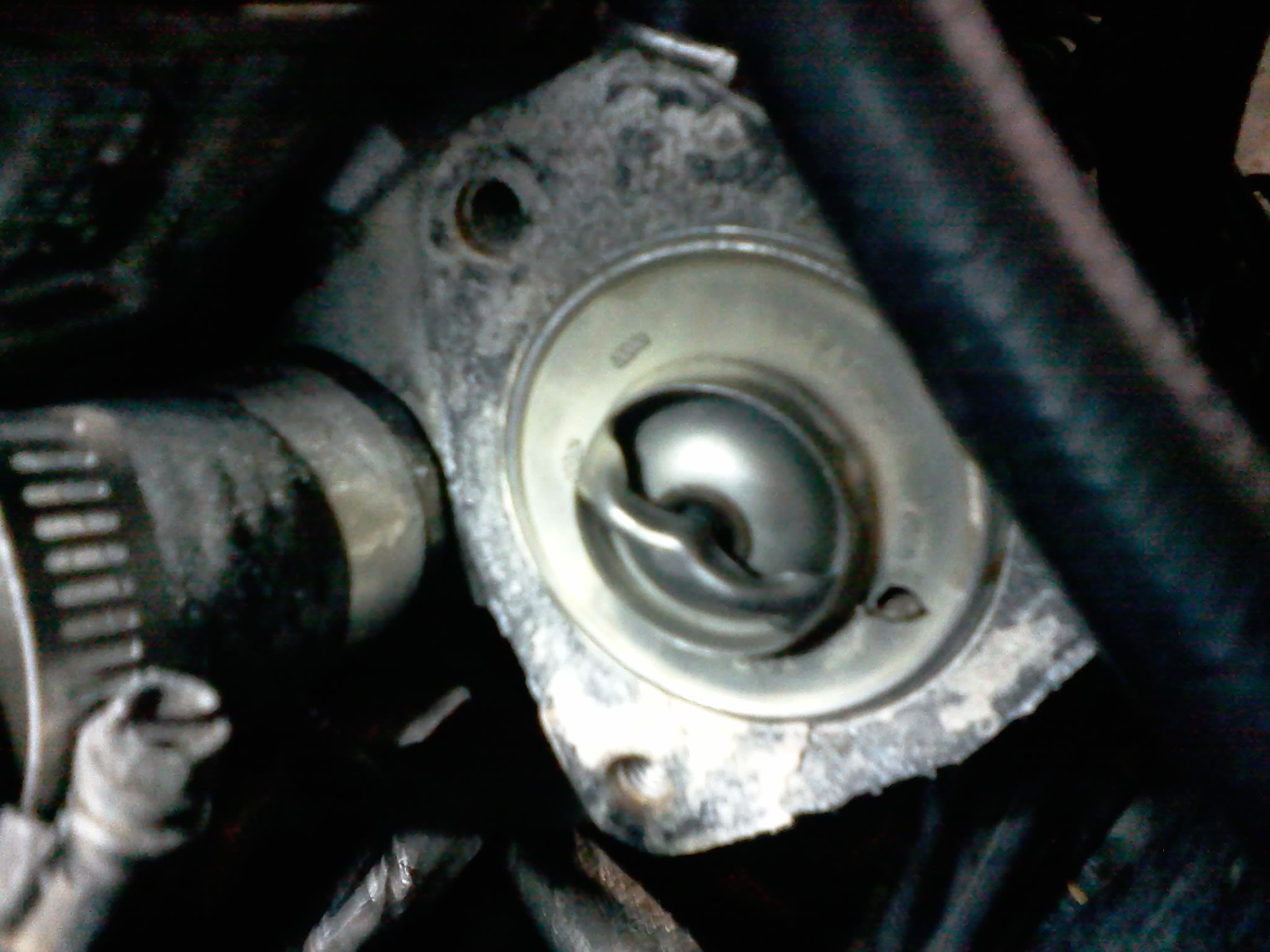

now for the diameter issue.
Once again the aftermarket one is BETTER.
I forgot what the measurement was but the OE is TOO BIG. Sorry for taking pics before cleaning the gasket off.

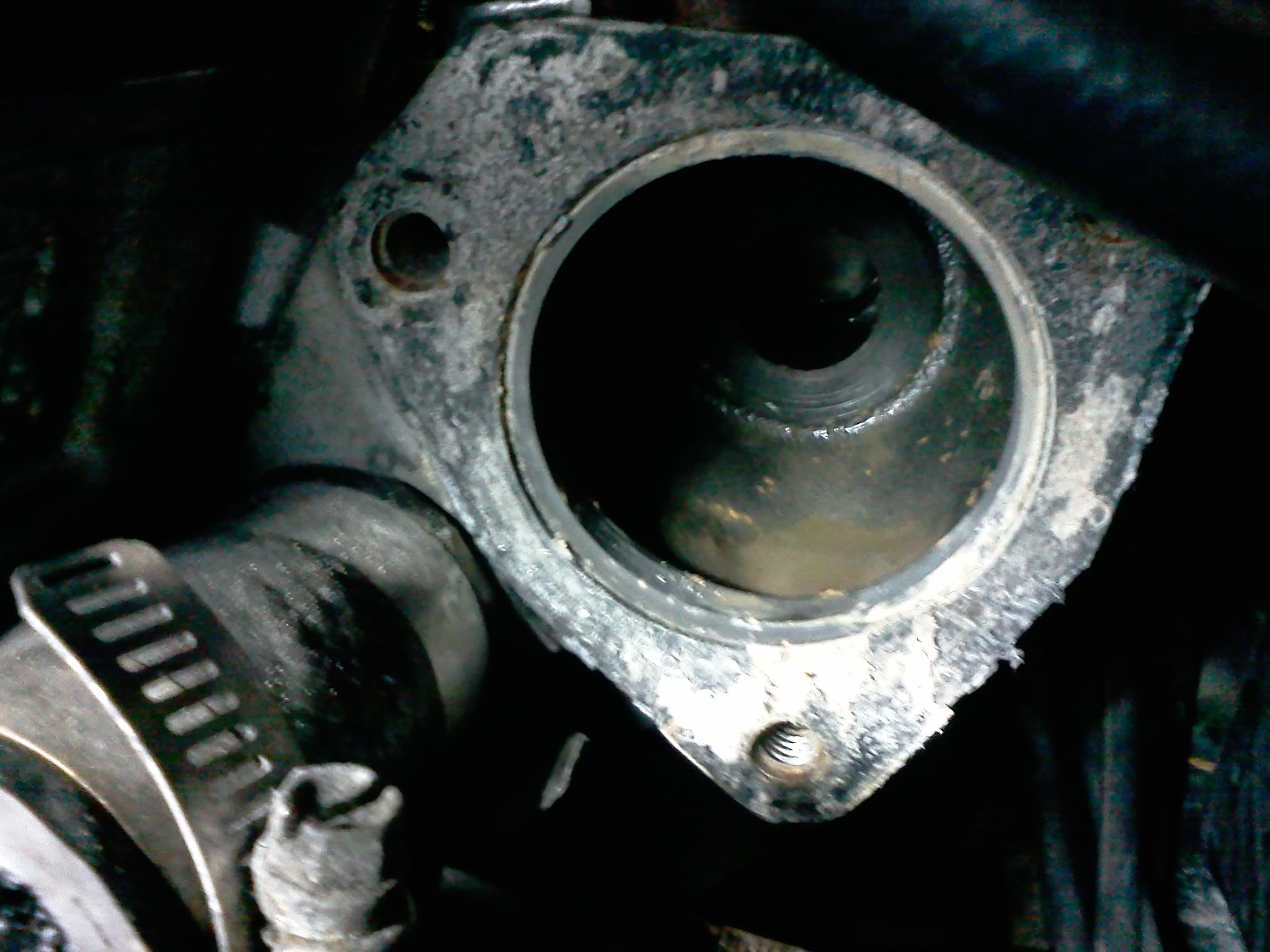

anyways that lip isn't from the gasket, its actually cut into the housing. The OE thermostat will not Seat into it because its too big, the aftermarket one DOES and has maybe 1mm of space.

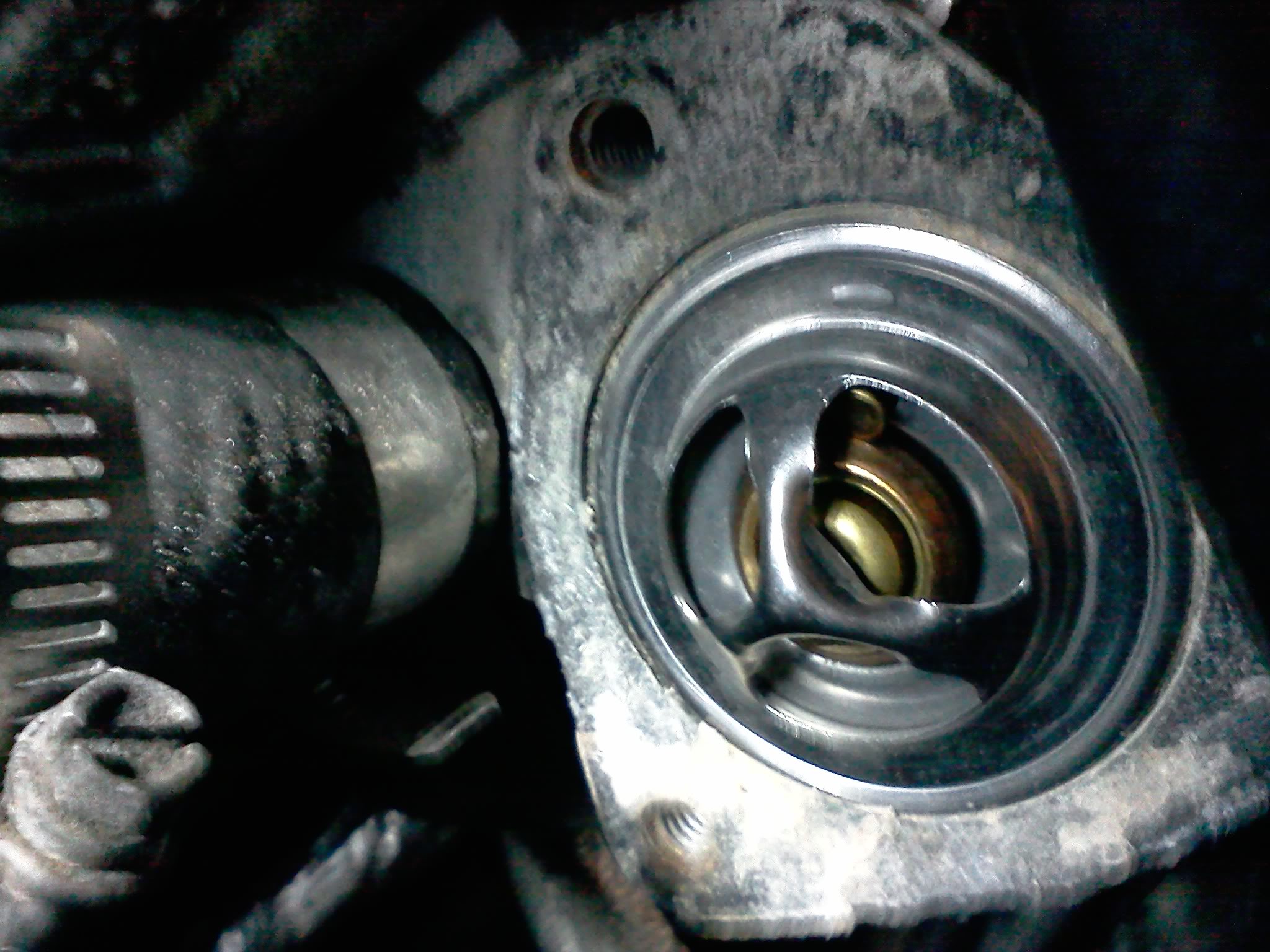

you can see some of the gap at the top where there is room for the thermostat to actually fit back into the housing and seal
again sorry for the nasty pics with the gasket still on there and idk if you can actually tell how they fit differently. in the new pic you can see on the top where there is a bit of a gap.
The RH side is just as deep and just as wide. I recomend ANY jaguar XJS owners replace there thermostats asap, this is such an easy job and the probably whole reason they run hot.

yeah i didn't know you meant to the rim before, they are 41mm closed.
i agree with you, and honestly I didn't ever pay enough attention to how they work before i took these out, but its SOOO simple. Sometimes it astounds me how simple things work on cars. Like its technology from decades ago but its theres nothing wrong with it so don't change it.
