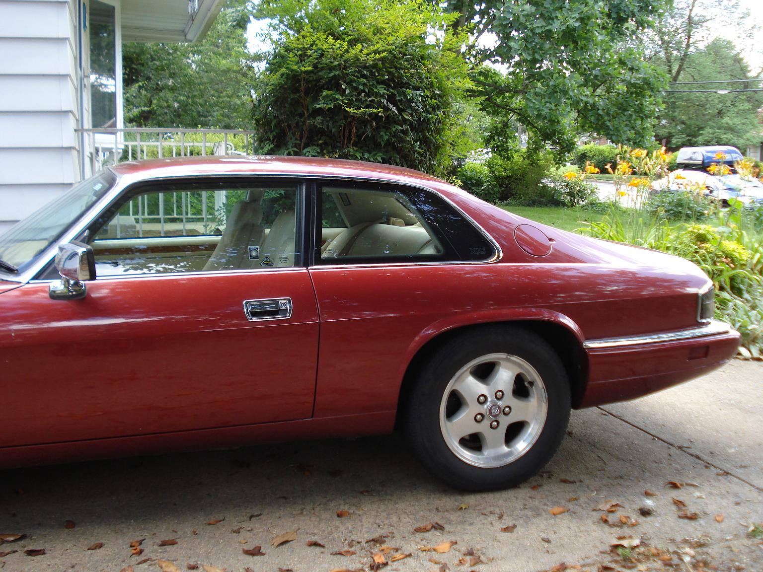

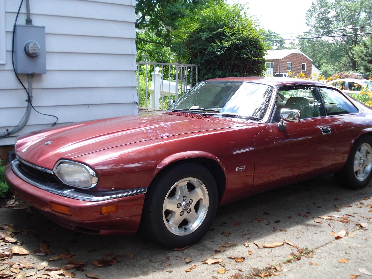

About a week and a half ago, my dad and I bought a beautiful, red 1995 XJS 6-cylinder coupe from a lovely British lady in Annapolis, Maryland! Her name is Edie.
Her exterior is beautiful, though there is some paint damage and the XJS logo is missing from the trunk lid.

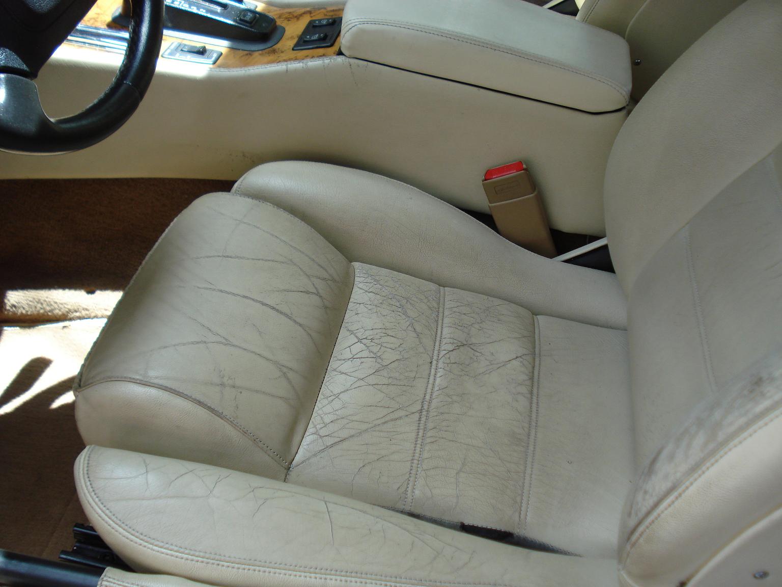

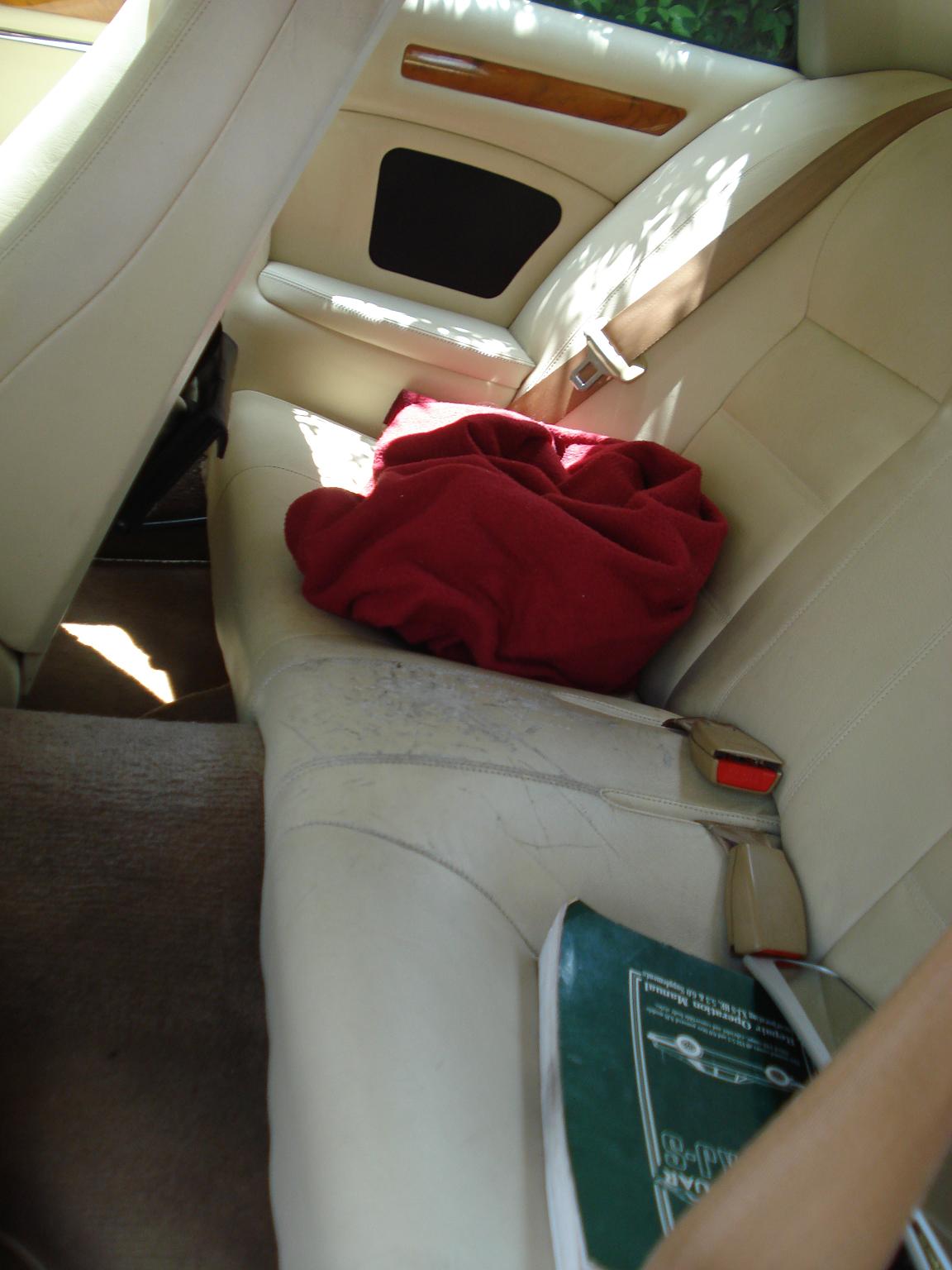

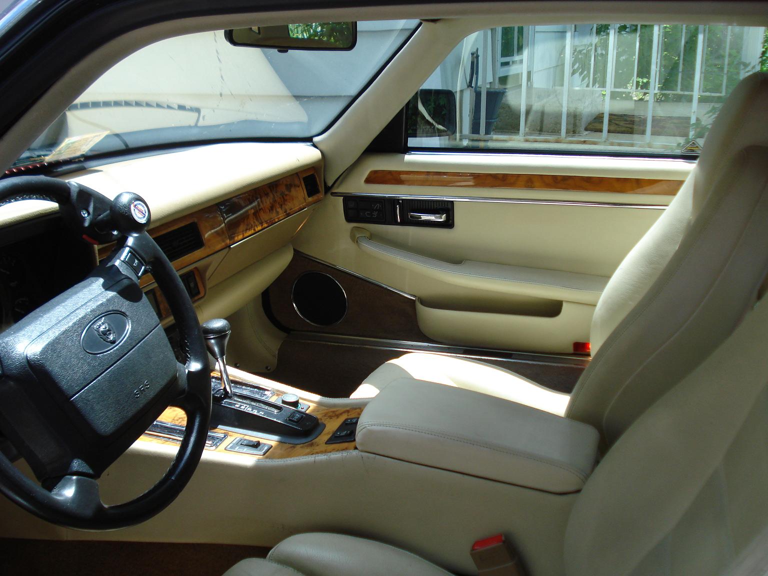

Her interior is okay, but the front seats and back bench probably need new leather.

Nice car you have there, and I really like the condition of the wheels. Nice to see the coupe getting new, excited owners.

Car looks beautiful. Wheels do indeed look in great shape!

Nice find! Give the leather a thorough cleaning with Gliptone or Leatherique products. Then slather (and I mean slather) on some leather conditioner, wrap the seats in saran wrap or black plastic trash bags and leave it in the sun for a week. I am not kidding. You'll be surprised how much the leather can be rejuvenated. Then you're only looking at stitching the cushion.

Flint, thanks for the info, I'll try that. Great name, by the way.
