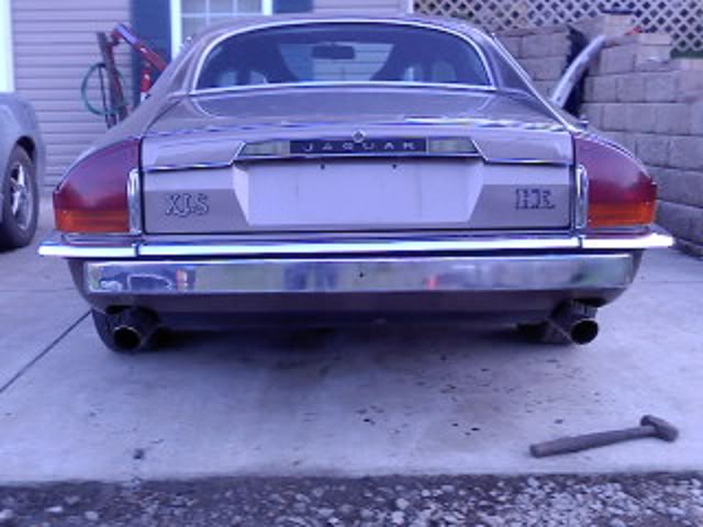

i cut the adjustment bolts off of my gas shocks and adjusted them the way i wanted. JB weld to hold them in place.

just hide them underneath. adjusting the gas struts is easy once the nut is off. at least do a trial fit.
