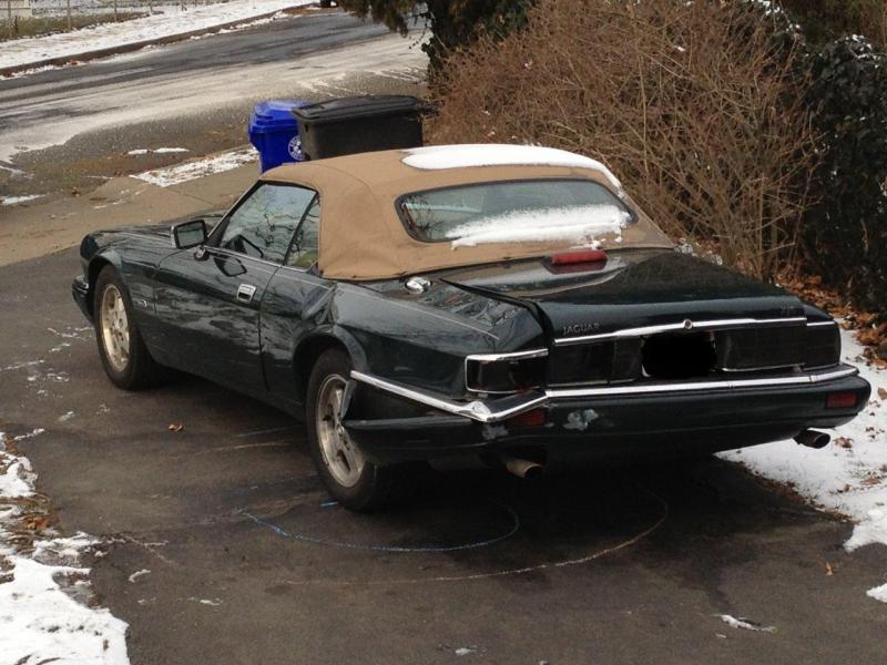

Thought I'd upload a picure...
No update from insurance as of yet...

Wow, brutal. I assume you are ok? didn't see any mention of injury in your posts. Sorry you have to go through this; hope you get as good an outcome as possible.

That's very sad. Same color as mine too. Looks like you only have one broken light.
Might be totally fixable if you shop around for the parts at the right price. They are out there.

Hate to say it brother, but unless a miracle happens, this is a total loss. That quarter is not repairable and the entire rear geometry has shifted.
Had the insurance appraiser looked at the car? What about your insurance?
BTW, if you don't hear from their insurance or run against a brick wall with them, I'd recommend seeking legal help. Had a similar situation when someone made a left turn into my S-Type as I was going about 25 mph. Threw me up on a curb causing all sorts of suspension and engine damage. Car was deemed a total loss. His insurance company tried to make me 50% at fault. I contacted an attorney right after I hung up with them. Within a matter of days, the other party accepted full liability and my car was declared a total loss.

I'm expecting a total loss as well.
Did you get to keep the car, or did you have to give it up when they cut you a check.
Were you happy with the amount of money they gave you?
I had a few people get me prices on the pieces I need. It seems cheaper, or even money to find a donor car...

Looking at the damage in the photo, I would advise against attempting the repair on this car unless your local body shop is deeply indebted to you. 99.5% the car has rear frame/structural damage that would need to be pulled on a frame machine. Too much damage IMHO for a floor pull and the whole concept of floor pull is really a hit and miss in terms of accuracy. After all the money you'll spend on parts and labor, you may end up with a salvage titled car that will cost you more than a similar clean title. Have seen this many a times.

The car is quite repairable. I have no idea on hourly rates for body shops where you are, but $8k should definitely do it.
The car will easily pull straight on a rack, left hand rear frame rail will be kinked, but not by a lot. Boot floor, rear beaver etc can all be repaired and replaced, boot lid is nothing. You can even buy replacement upper and lower quarter panels, so I definitely think it's doable.
Help the shop as much as you can, chase parts for them. Don't rush them either.
Considering how nice the car looks, I'd say it's ripe for being repaired.

The body shop put it up on a lift and showed me all the structural damage. They told me that based on the damage, it could be repaired, but it would probably not be as safe as original.
For what I could repurchase this car for, I'm sending this one to the scrapper. I'd love to keep it, but I'd have a car with a salvage title and a car that might not be as safe if this should ever happen again. I am not comfortable with that thought.

I would not be so excited about repairing a car with such damage as yours. The car is damaged structurally. I'm in the auto repair industry. I've seen number of redo's from other shops, even well respected. Even if the job came out perfect and within your allotted $ amount, you will still have a salvaged title car with prior frame damage.
Ultimately, you do what best fits your situation but I would think twice about fixing it.
