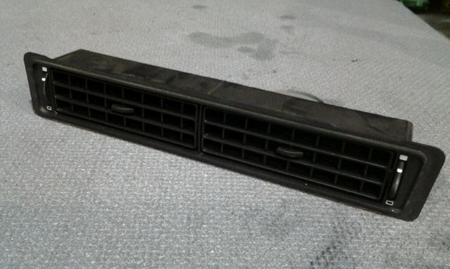

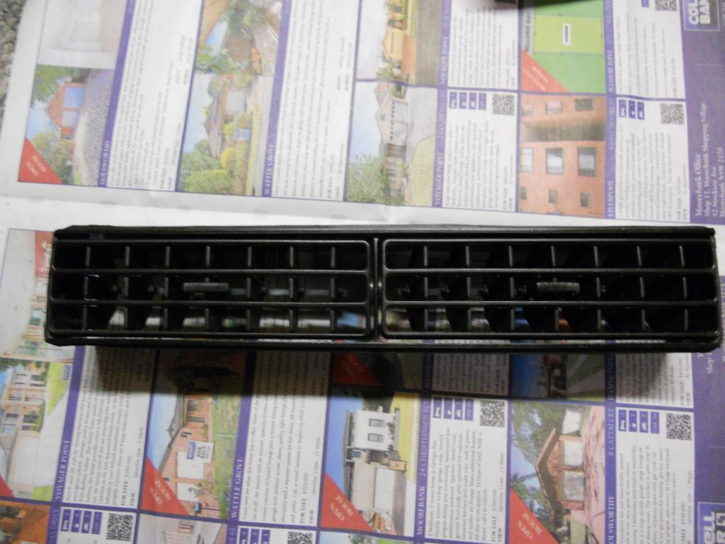

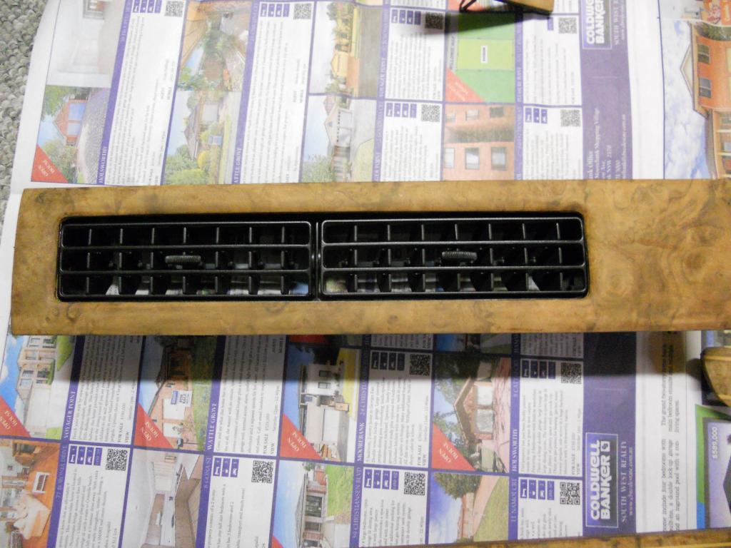

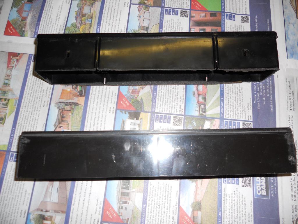

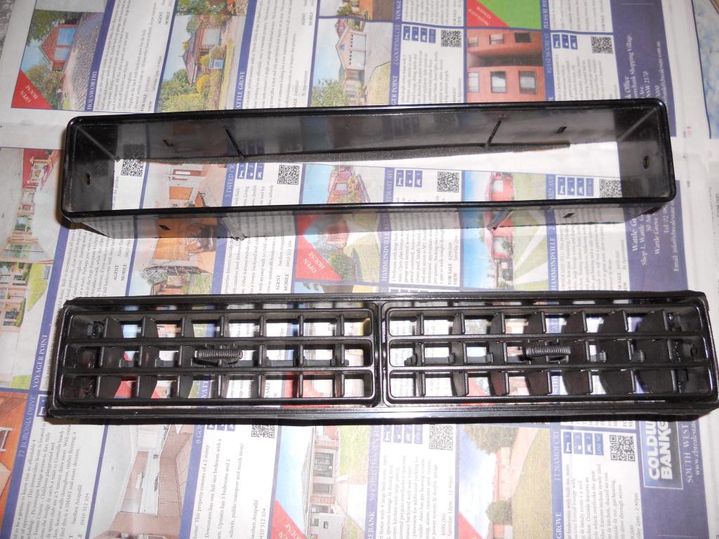

HI folks, thought I would post up how I modified an XJ40 center vent to fit my 89 XJS.
It required cutting the XJ40 vent and welding it back together.
See here for how to weld plastic.
Hot To Weld Plastic Photos by warrjon | Photobucket
It started out looking like this.
After removing the vents cut the ends off with a dremel.
Also trim the back so it fits between the wood trim and outlet.
Trim the surround to fit inside the wood trim. I went a bit too far and had to weld some plastic back on.
Original vent on top and new one. I did have to file the dash opening as the new vent is a couple of mm wider.
Complete and ready to go back in

Nice mod. I imagine an XJ40 center vent is much cheaper and easier to find than the rare 94 to 96 center vents from an XJS.......

Exactly why I bought the XJ40 vent it was $20 on eBay, I have never seen a late XJS vent there were not much more than a handful sold here in Aus.

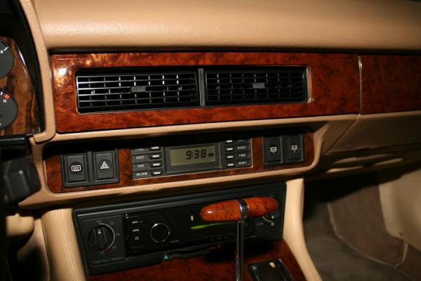

Here's "the real thing"
Yours is just as good :-)
Wood looks good there.
I suspect the vent are the same with a different surround

Looks great!! I was planning to do this same exact thing with the vent from my 94 xj12. Thanks for doing all of the legwork . The added plus is the xj40 vents are readily available cheap and just a hair bigger. I think we should sticky this write up.
