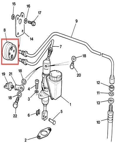

Recently I replaced my clutch master cylinder and the flexible hose that goes to the slave. While ordering the parts, I noticed that the parts diagram specified a clutch damper between the master and the hose. My car was never fitted with such a part (which I don't mind as it really doesn't do much).
There is no mention in the parts catalog of a change being made and the part deleted.
So I'm curious, do any other manual owners have this part? Greg?
This is the part outlined in red.
Cheers,
Allan

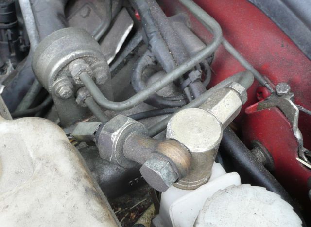

Got it. Mine is an early facelift car built 6/91.
Thank you Allan, for pointing out one of the 3 or 4000 mysterious parts on my car. I had no idea.

Thanks for the photo. I wonder when they decided to delete the damper? Strange that there is no mention of it anywhere?
