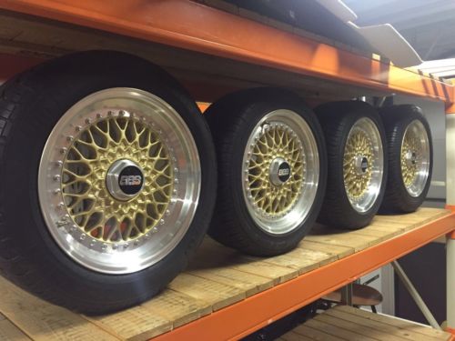

I have acquired a set of NOS period BBS RS 16" wheels that were produced to fit XJS's and XJ40's, i.e. with a 5x120.65 PCD, 73.9 mm CB and 30 mm offset.
These are staggered RS020 and RS027, both 16" OD.
The RS020 (front wheels) are 7.5" wide and the RS027 (rear) 8.5".
The tyres that are mounted on the wheels are "new" Pirelli P5000 that are of course useless.
The dimensions are 225/45 R16 and and 245/45 R16 respectively.
Such tyre specs are obviously quite different from the dimensions that are recommended for the XJS (mine is fitted with 225/55 R16 tyres on 5-spoke alloys 7"x16" with an offset of 28.5 mm).
I wish to equip the rims with tyres that would correspond to the required perimeter i.e. 225/55 R16.
This is easy for the front wheels, 225/55 R16 tyres fit perfectly with the 7.5"x16" rim and there are plenty of good tyres proposed on the market.
The situation is more problematic for the rear 8.5"x16" wheels.
In principle the best fitment would be a 245/50 R16 tyre that would better exploit the increased width of the wheel, still keeping exactly the same perimeter and not fouling the wheel arch thanks to the 30 mm offset.
However, there are unfortunately no tyres on the market for that dimension, probably obsolete.
The only alternatives are to put a 235/50 R16 which has a smaller perimeter, or even further a 245/45 R16.
Or to put the same tyre than on the front, i.e. a 225/55 R16 maybe with an XL (extra load) spec, that would be somehow "stretched" (8.5" seems to be the limit of acceptability for a 225 wide tyre) but with the benefit of having the same tyres all around.
I am inclined to go to the 225/55 R16 route all around but I am wondering if that would put the rear tyres under too much stress, require an increased pressure (of how much?) and if that may worsen the ride of the car.
What is your opinion on these options?
Attached Thumbnails Correct tyres for BBS-RS020/027 wheels corresponding to Jaguar XJS-bbs-rs020-rs027.jpg
