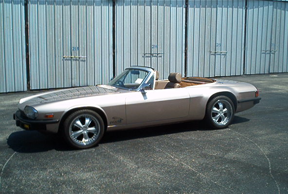

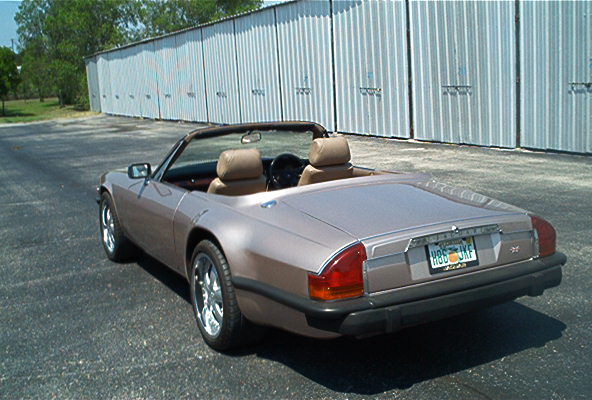

good read, enjoyed.
pic of my roadster, 1978 V12, done 25yrs ago.
Attached Thumbnails Design of the Hess & Eisenhardt Convertible-jag-rodstr-013.jpg   Design of the Hess & Eisenhardt Convertible-jag-rodstr-016.jpg
