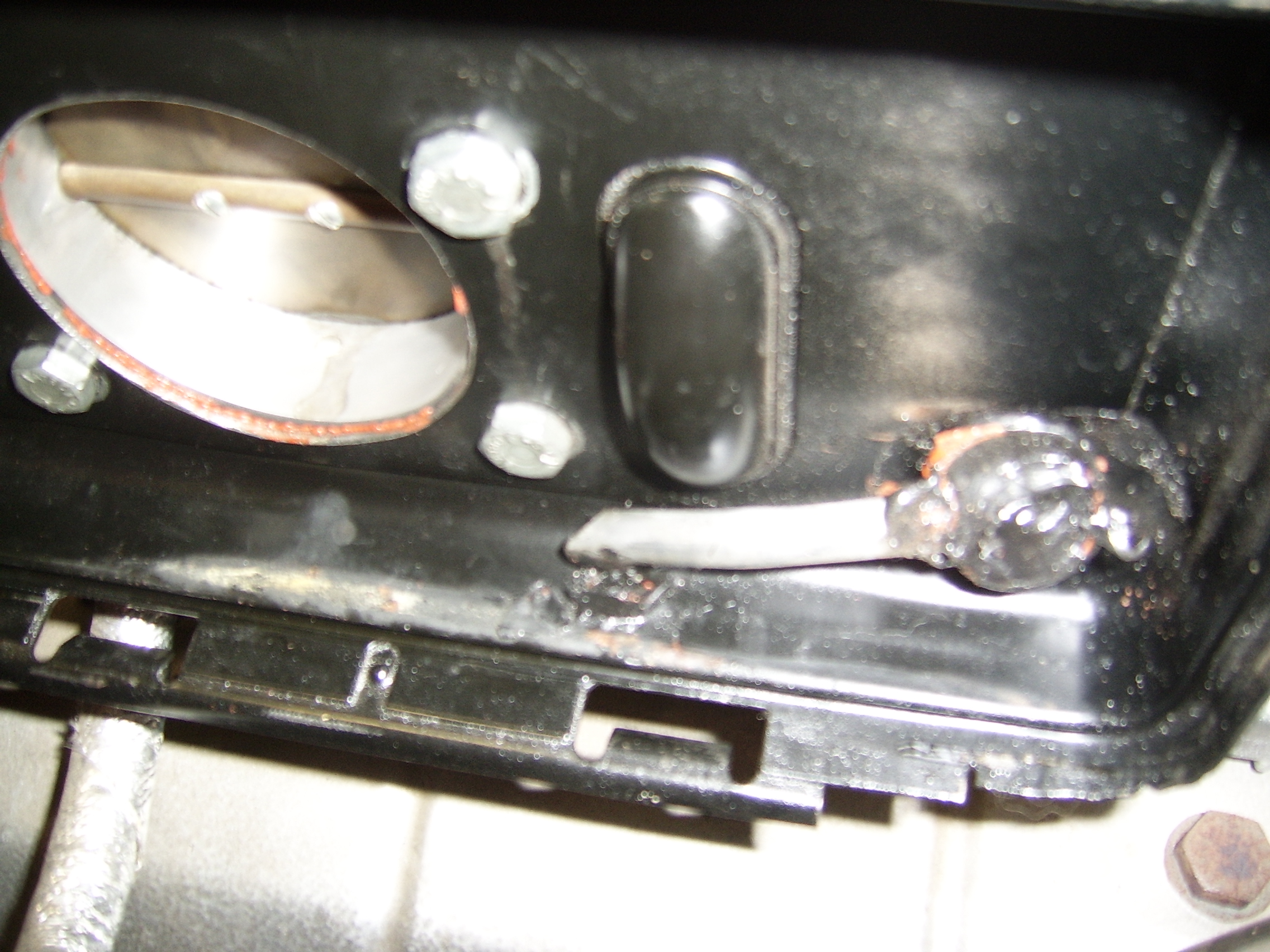

I did exactly that with mine when I removed the AAV, balance pipe, etc.
A LOT rough, but it was the mock up to see if it would work, and it did, so I tidied it up heaps, but forgot the Kodak.
Disconnected hose: what is it?-inside-aircleaner.jpg
Originally had that pipe closer to the throttle opening, but with the larger discs in there, the "whistle" was terrible, so it got shorter until it shut up.
