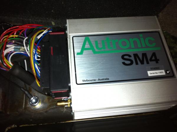

Hi all, I am just putting together a system. I already have a Atronic SM4 ecu running my injectors, and have put a trigger sensor in the bottom on the distributor. I just need to work out what coil packs i am going to use and have the distributor capped off.
Attached Thumbnails distributorless ignition anyone?-p-j-owen-116002-albums-garage-toy-5525-picture-img-0841-17211.jpg   distributorless ignition anyone?-p-j-owen-116002-albums-garage-toy-5525-picture-img-0918-17213.jpg
